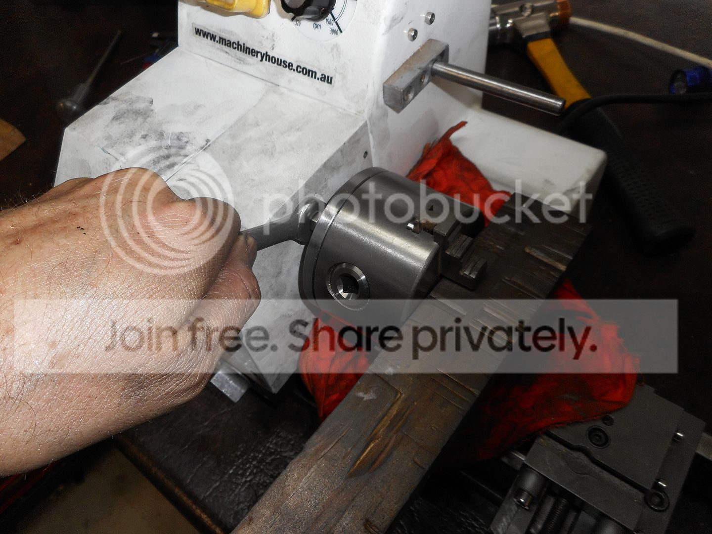

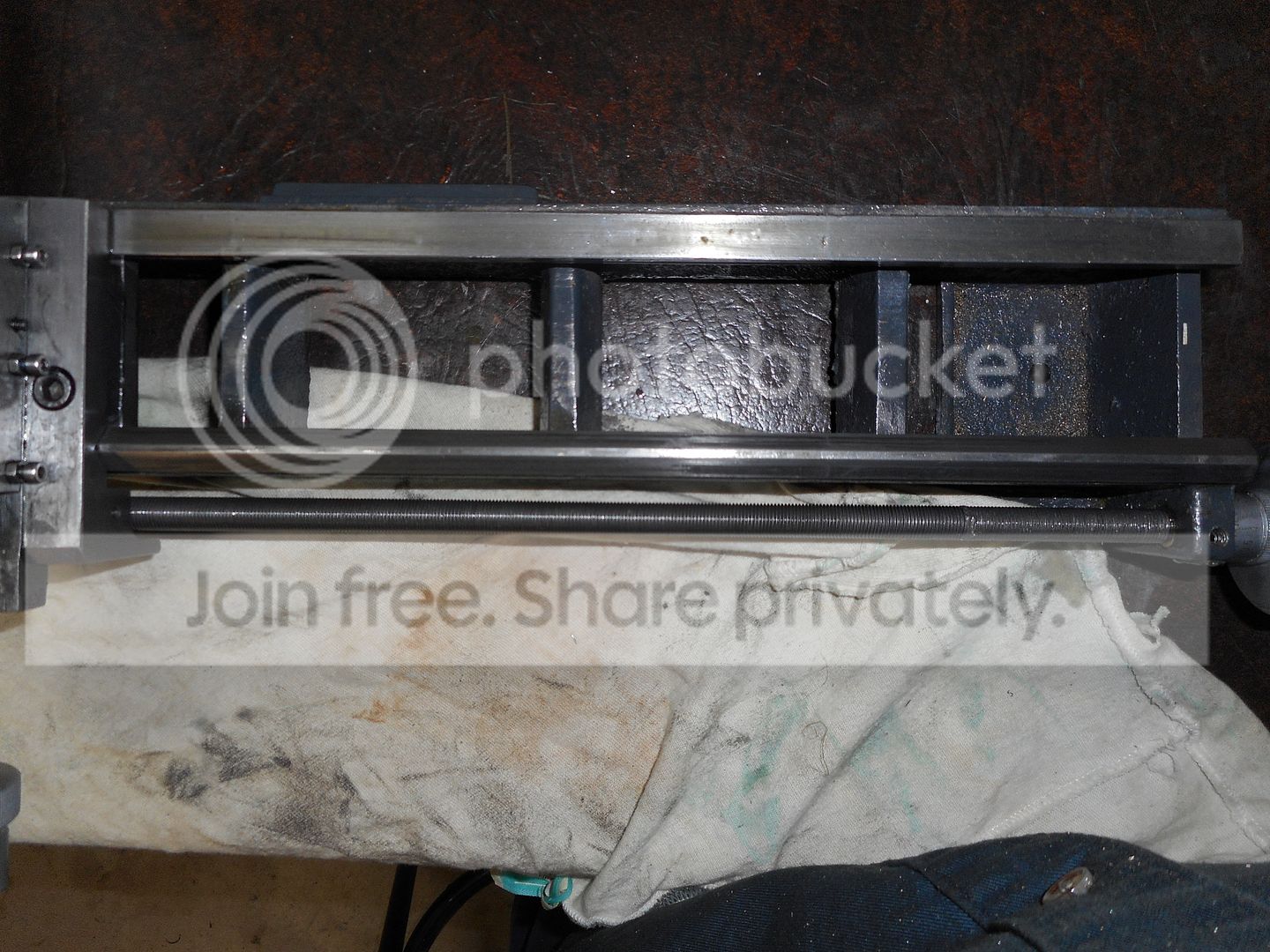

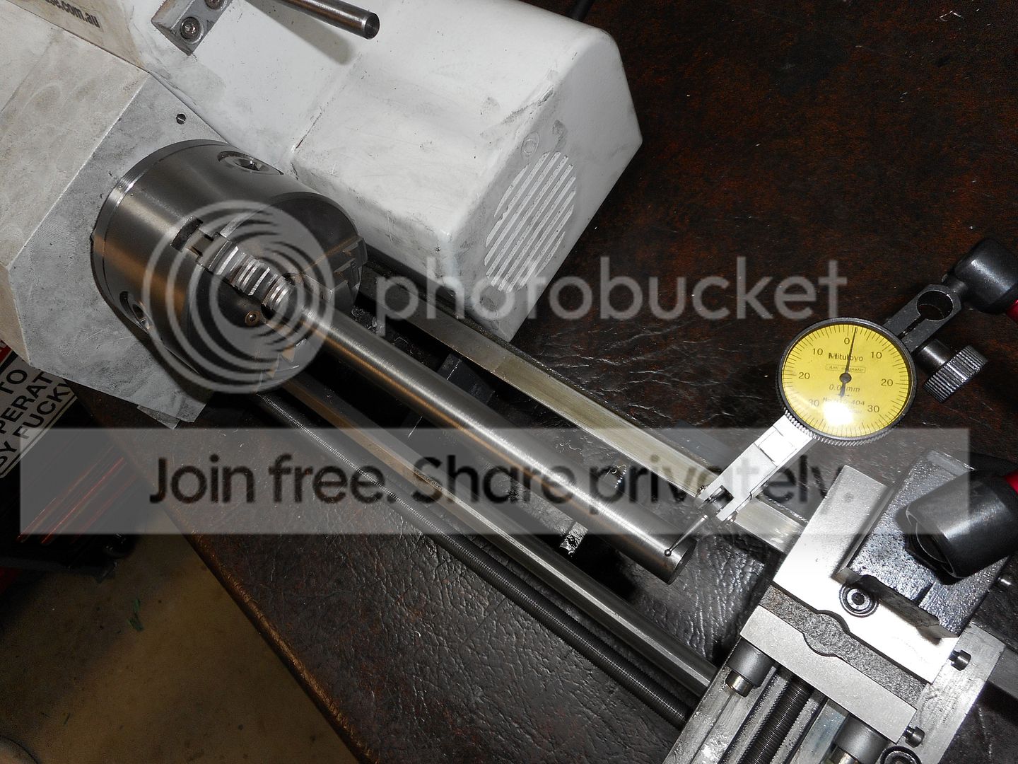

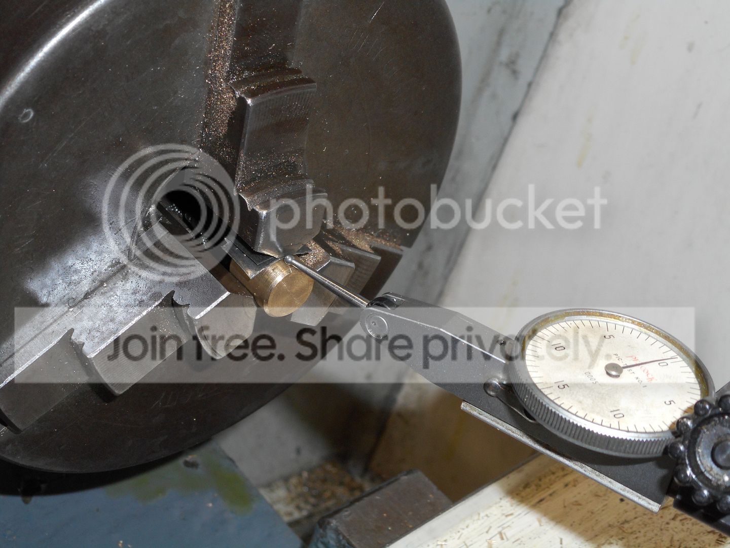

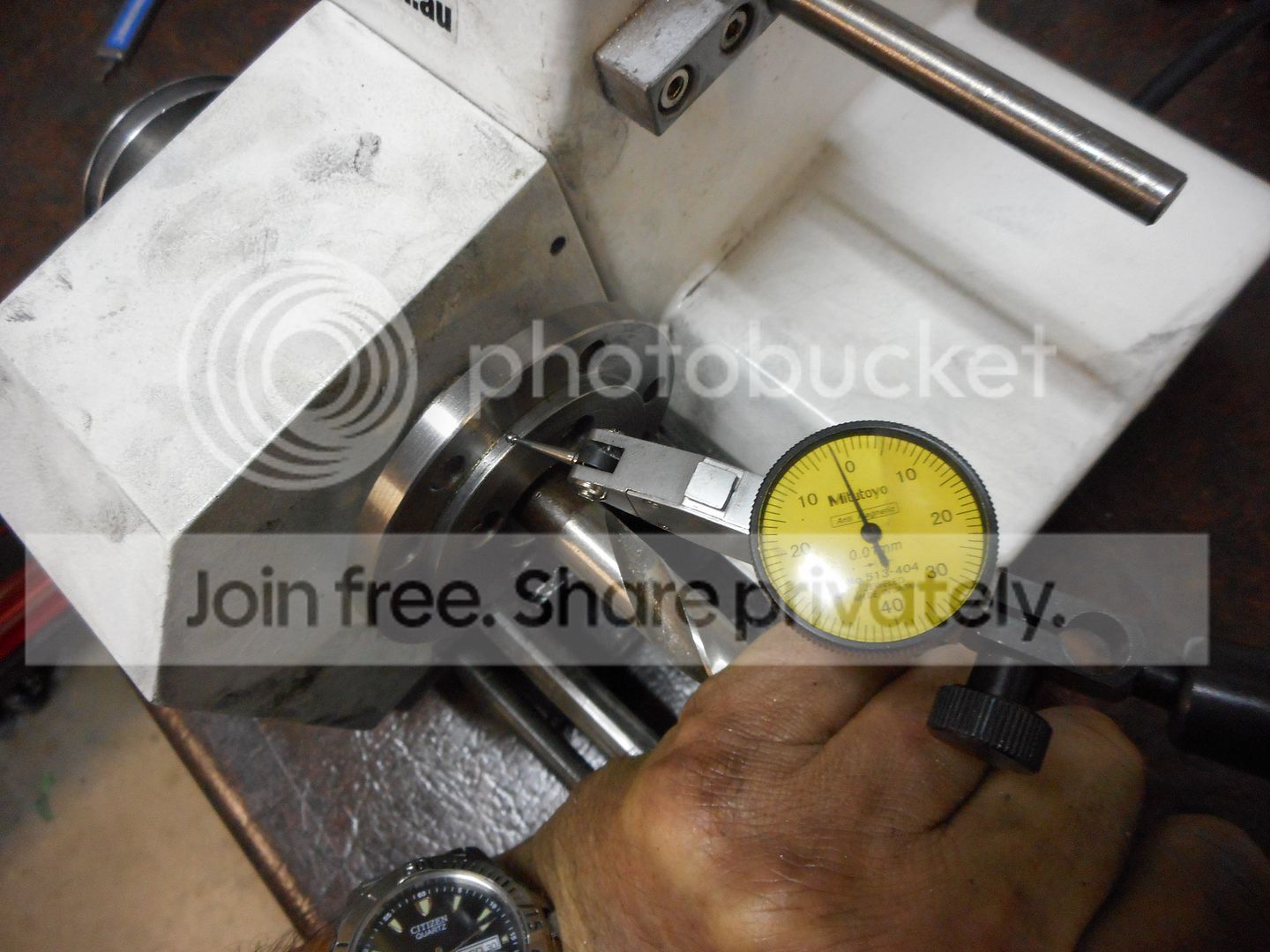

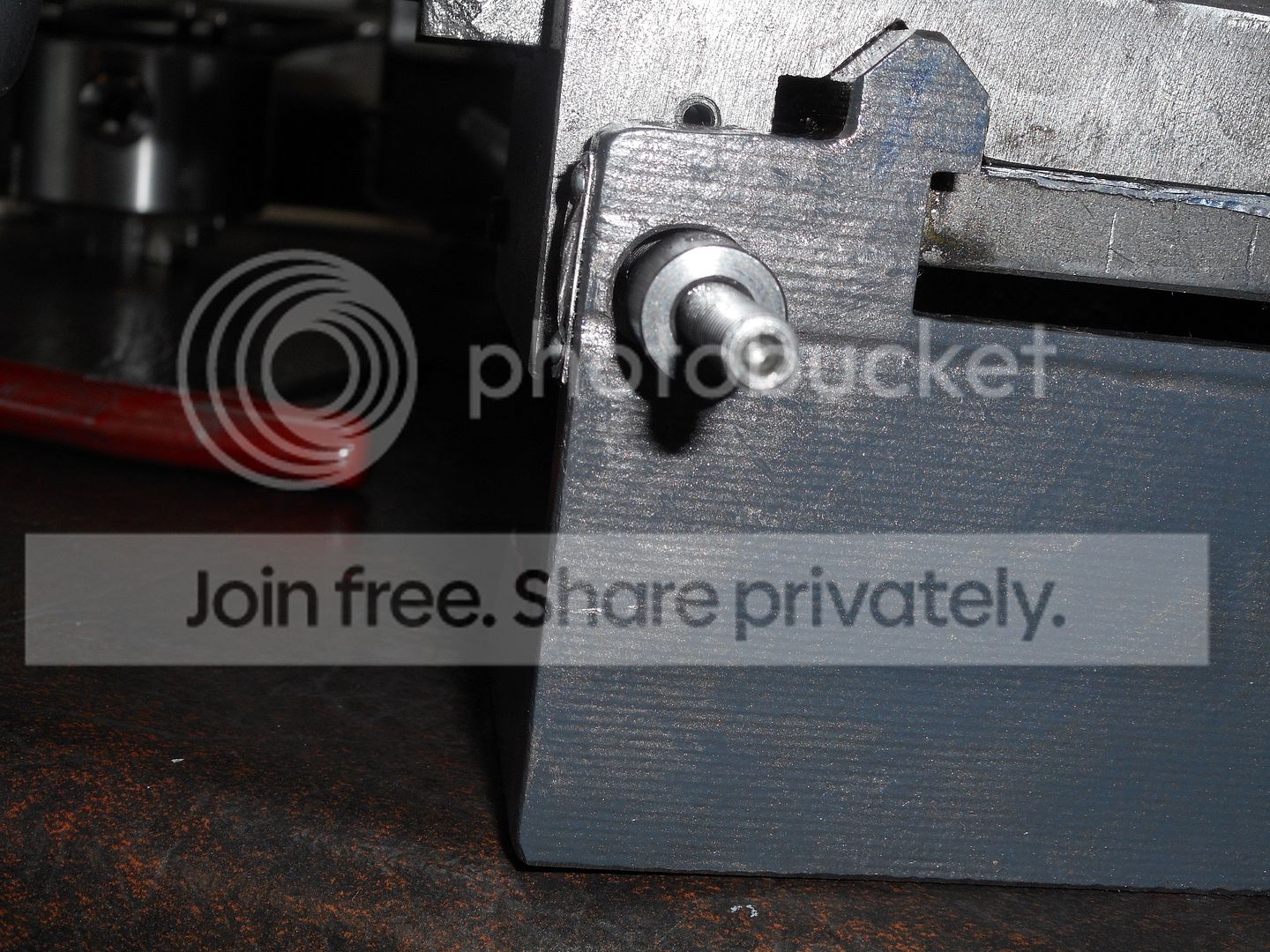

        A few pics of this morning's findings:
        The original bushing showing the misalignment where it sits on the leadscrew but missed the hole by about .025".
        Turning an offset bushing the quick and dirty way in the three jaw chuck with a shim between one jaw and the bushing which has already had the OD and length turned to size. With it running off centre by the correct amount, bush was centre drilled and drilled 6mm in the normal way.
        The finished bushing. You may be able to see the offset of the hole in the middle. Not sure about my close up photo skills though. The bush slid right on that lead screw and into the hole in the bed shown in pic one. Then I marked the grubscrew dimple position and drilled it in the drill press to locate the offset in the exact right position.
        Hey look, the leadscrew is in line with the bed ways!!
        Spindle runout all well within spec: Here I am checking bearing play by pulling upwards on the MT1 drill bit inserted in the spindle. No perceptible shake but .02mm of movement if I push downwards as hard as I can. On a tiddler like this, probably spindle flex etc.
        Spindle runout radial and axial all very good. Just perceptible needle movement.
        Tightening the chuck mounting nuts in the traditional manner with piece of wood through the jaws to stop rotation.
        And carriage movement vs test bar set in the neutral position (halfway between max and min runout) is within about one thou (.02mm on this DTI) over the six inch length. Not too bad.

                    Tests today have shown about .0005" taper (0.01mm) over a three inch (75mm) length of aluminum 5/8" diam bar. Not Schlesinger limits but better than before and easily adjusted by bed "levelling" ie putting just the right twist in it.
                    My test bar between centres showed about .002" high and .002" toward the operator at the tailstock end. I say about because the tailstock varies a bit depending on how hard you clamp it down. There is no adjustment on the tailstock in any direction other than laborious scraping.
                    Fortunately when I turned a piece of steel between centres, it was only about .001" smaller at the tailstock end over a five inch distance. It goes to show, you can't beat an actual turning test. Or maybe it was just the tailstock moving about a bit.
                    Finish on the ally was top notch. On the steel, not quite so much. As there was quite a backcut on the return of the carriage, and as using a tailstock centre makes a huge difference, even close to the chuck, I put it down to headstock bearing play, which was more than I expected when measured with a long bar held in the chuck and pushing up and down. So we'll see about sourcing some angular contact bearings on the morrow as per Ketan's suggestion about 30 pages ago!
                    The little baby lathe really struggled to deal with a piece of one-inch diameter cold rolled steel bar about four inches long. With no tailstock centre in place if had to call the lathe a name it would be Chatterbox. Light cuts just as bad as slightly deeper ones.
                    Then with tailstock centre in place, chatter stopped, finish improved but still not sparkling, and I could take a 20 thou/half millimetre deep cut – but it kept stalling the motor or slipping the belt. At 400rpm as required for HSS tooling on one inch diameter steel, the motor simply has not enough torque. Gentle hand feeding at about half the auto feed rate with great care allowed the cut to proceed. But blimey it would be slow going to make anything at that rate. I have suggested to Brian that he eventually turn up a half-diameter pulley to put on the motor to double its RPM vis-a-vis the headstock spindle RPM and thus give more torque at 400rpm.
                    Half-inch (13mm) diameter cold rolled steel fared much better. Nicer finish without the tailstock centre, although not brilliant. Quite passable finish with a centre. Running at 800rpm with out drama. Took a 1mm (.040"   ) deep cut under fine hand feed OK. Not too bad at all.
