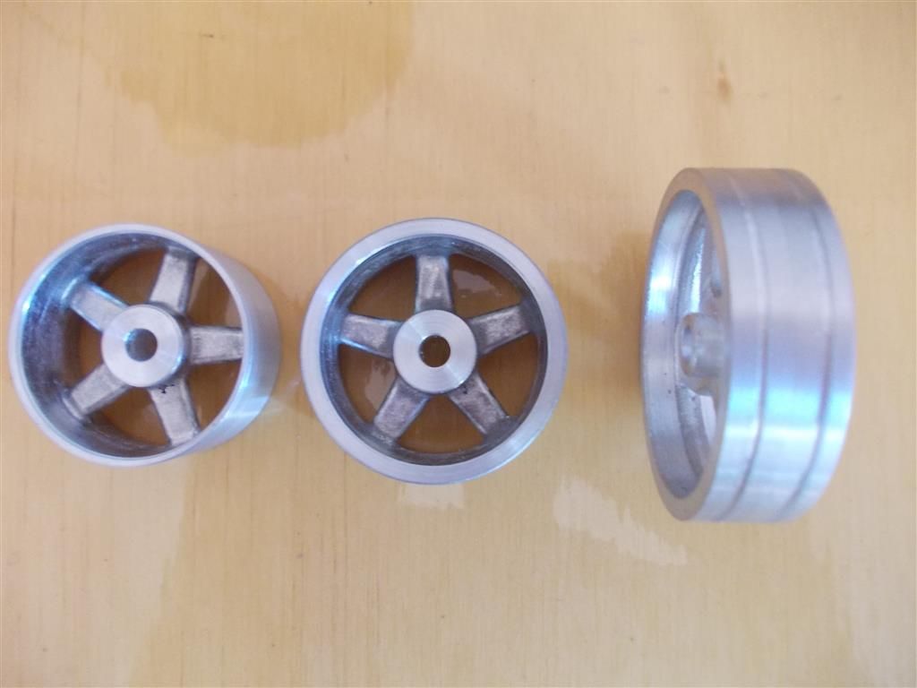

      I'd use M4 for a 6mm mandrel, and only use the first half of an M3 tap.
      My order of machining for a flywheel is:
      Clamp to faceplate or inside rim on 4 jaw chuck (or 3-jaw if spoke arrangement allows and concentricity of casting is acceptable.
      Machine rim, front face, centre boss and any other bits needing a tidy up (such as inside edge of rim) – basically anything I can reach with a cutter
      Bore out centre – this minimises the risk of 'rim wobble'
      Reverse against faceplate or chuck if machined face of flywheel allows to maximise chances of machining other face/boss parallel to the first set.
      If this is not possible, mount on a mandrel, but DON'T be tempted to touch the outer face. The mandrel should ideally have a flat face against which the previously machined face of the hub can be snugged up.

          Some use super glue and heat to break the joint later. I prefer an expanding mandrel. Hacksaw or junior hacksaw slots will do. At the sort of size it appears to be a junior hacksaw would be best as 2 at right angles after the hole has been part tapped tends to grip better than one. It needs to be a step mandrel made from material that is near the size of the boss on the flywheel or bigger.
          Personally I would do most of the machining on the mandrel just facing the boss and machining the hole while holding the wheel some other way. Just press the machined face back against the shoulder on the mandrel tighten and machine the surfaces of the wheel. The large diameter part of the mandrel need to project enough to allow the rear rim to be machined. Depending on the size of the chuck and wheel that can be done when the boss is machined if sufficient sticks out of the chuck. Also spokes if these have to be done. When doing the chuck work it's best to press the wheel hard back against the chuck as this will square it up. Sometimes no rim will be left sticking out to machine. When you face the other side of the boss the tool will have to cut into the mandrel a bit. Not a problem really as it wont run concentrically once it is removed from the chuck and replaced again.
          The expanding action can sometimes be improved by filing a bit of a taper on the socket headed screw that will be used to expand it. Easy to do on a lathe but use the lowest speed. Just hold the head in the chuck without fully tightening it and tap it to run true if needed then fully tighten the chuck – but see later.
          It's best to make the mandrel after the 1st machining operation on the wheel as the fit needs to be good and it's not easy to accurately measure the diameter of small holes. It's best to make that part too long so that you can try the fit before running the cut all along it. There are several techniques for obtaining a certain level of fit but the easiest one is to take cuts equal to the fit you want once it's close to the right size. In this case – imperial I'm afraid, 1 thou would be ideal, 2 thou off the diameter. A drilled hole should come out well under 0.010in over sized so measure with a mic to get to that size and then take the fine cuts. Even finer if you want. If it nearly goes on a bit of emery paper or a file will fix that quickly rather than taking an even finer cut.
          You are already using the best way to chuck the wheel with what you have but when you close the chuck onto it feel for when the jaws touch the rim, slow down the tightening and rotate the wheel with your hand, only a fraction of a turn is needed. With a bit of practice this will always get what ever you are putting in the chuck running as true as it can. With bars it's best to have one jaw central at the top. That way you can feel when the bar is resting flat on the other 2. Later you wont need to do that but might if the length within the spindle is heavier than what is sticking out of the chuck. That can be tricky on large lathes.

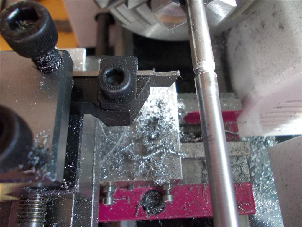

            I have not had much time today as I had to work last night. I had another go at machining the other pulley in the photos. Bit better today as I did not try to put a camber on it and so ended up with a much thicker rim than yesterday. I also took that flywheel which is no longer good for anything and tried to cut two pulley grooves in it with the parting tool. The first groove went okay but the second gave me problems : the tool dug in and stopped the lathe ! I was only taking a bit at a time but it seems that when using the parting off tool you have to be very careful. Was I going in the right direction ?
            Edited By Brian John on 28/08/2015 07:33:51
            Edited By Brian John on 28/08/2015 07:45:57
            #202259
              You don't need stainless steeel for the mandrel, aluminium will do or steel
              Its a large dia for that small lathe to cope with a parting tool, a slower speed would help. You may have been better using a "V" shaped tool taking a little from each side of the vee in turn, this would also grip a belt better.

                          Parting off:
                          One of the keys to easier parting off is to ensure you have maximum rigidity.
                          Tool protrusion in holder needs to be minimum to just reach beyond where you are parting to.
                          Tool on correct centre height and locked solid in holder with an OK top take for material. Most blades have sufficient side clearances due to their built tapers. You also need front rake/clearance.
                          The parting slot needs to be as close to chuck/collet holding it which must also be a firm grip.
                          Lock the saddle if there is a saddle clamp.
                          Importantly, ensure all slide ways have no undue clearance, I.e jib strips need to allow no excessive play. If you have play you will get snatch. I have seen many a tool holder broken because of this.
                          When actually parting off manually ( not under feed ) don't be afraid of retracting the tool a few times during the operation to clear dwarf. Also consider moving your tool sideways using your compound about 0.5mm to widen the parting slot slightly. It allows for dwarf clearance to help prevent any jamming.
                          Good luck and when you perfect it it will be a joy rather than endurance.

                                FWIW..From your pic you've got too much shaft protruding from your chuck; and, I assume the you have a tailstock centre fitted & supporting the shaft, what is happening is that with the set up you have your are deflecting the shaft from its rotational axis by pushing it with the parting off tool this will cause the shaft to 'whip' eccentrically about its axis irrespective of the speed / feed used, thus allowing the shaft to climb over tool centre height setting & either snap your tool or bend the shaft, or both, also the groove in the shaft will be opening & closing against the parting blade due to the pressure from the tailstock centre, with the same effect.
                                Malc Broadbent has given a good general set up write up for parting off earlier to which I use & would agree with, & which I'm sure many others use.

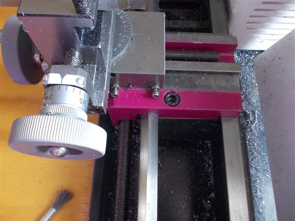

                                  There was too much slop in the top slide : I have made some adjustments to the gib nuts now so things should be better tomorrow. I had not looked at that before. I probably got away with it on aluminium but not with steel.

                                                I tried to cut the 6mm thread today but I had no luck at all. It just would not cut. I will have another go tomorrow. I may have to reconsider the expanding mandrel. I am think of using an M4 socket cap. I will also try to buy some 6mm aluminium round bar but my usual engineers supplier does not stock alumnium. I have none on hand but this will be easier to work with rather than trying to machine 6.35mm silver steel.
                                                In the meantime I found that there was still some play in the carriage (?) There is a large socket cap bolt that I had not tightened. Unlike the smaller bolts on the top slide and cross slide, this one does not have a lock nut so I will have to keep an eye on it. It could be a problem if it keeps moving.

                                                Peter Hall
                                                  @peterhall61789
                                                  That's the carriage lock. You only need to tighten that when you want to lock the carriage in one place.
