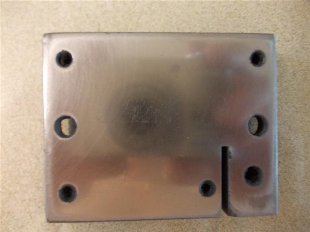

        I have just had another closer look at plate 219. You can see the 2mm strip either side of the clamping plate which makes contact with the bottom of the ways (top and bottom of the photo). These areas should definitely be machined or filed as it is still very rough. It is not as obvious in the photos but quite clear in real life. I know Jason has said his plate is similar but my lathe is very poor quality so things like this could make a difference.
        Edited By Brian John on 25/10/2015 13:07:32

            The locking tab is the bit of the clamping plate that is meant to lock the saddle. The wear patterns simply show that the grub screws were not set properly.
            While all the surfaces are rough, I would presume that the thickness of the bed shear is constant (roughly), the clamping plate is flat (roughly) and the machined surfaces of the saddle were done at the same time so are flat (roughly). The grubs crews cannot compensate for the shears being of unequal thickness, or the saddle bottom not being flat, just if the clamping plate is twisted. They seem to be fairly useless as they have cup points and no anti vibration locking devices on them. One easy job would be to rub the whole top surface of the clamping block on a large sheet of emery laying on a very flat surface (surface plate, sheet of glass), hoping to smooth it out a bit. That is why I thought shims would be the answer.
            Frank

                                Still not finished yet…a bit more to go. It may be pointless but I will do it anyway.
                                Edited By Brian John on 26/10/2015 06:56:06

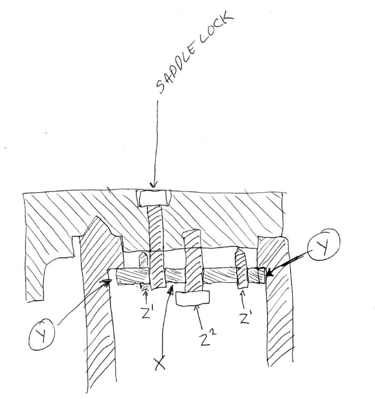

                                        #209319
                                        Martin Kyte
                                          @martinkyte99762
                                          Assuming nothing is rubbing that shouln't . . .
                                          Just a thought. When you do your adjustments say at the tailstock end and then slide the carriage towards the headstock and it gets tight, is this repeatable? By this I mean when you slide back to the tailstock end again and then move towards the headstock does it get tight at the same place. Do this a few times to prove it to yourself. If nothing is moving (gib strip, adjustment screws etc) and it sticks in the same place each time it has got to be the bedways which are out. The other possibility is that the gib is moving and wedging the carriage which I would have thought more likely.
                                          regards Martin
                                          #209323
                                            > It does not wobble without the clamping plate attached so it should not wobble when the clamping plate is attached. It makes no sense. At least we now know there is nothing wrong with the lead screw so pulling it all apart has not been a wasted exercise.
                                            This suggests that the problem is with the adjustment of the clamping plate. As the carriage of an inverted-V lathe sits on to of the bed and should engages nicely with the vee it should be wobble free and wholly free to move without the plate fitted, as it is. Any wobble must therefore come from it being forced out of clean engagement with the vee.
                                            Lets have a close look at how it all fits together:
                                            Two possible sites of problems are at 'y' – is the plate too wide and rubbing here, this would push the carriage out of alignment.
                                            The plate is adjusted by working the big screw, Z2 against the grub screws Z1. Why opposed screws? because you aren't simply clamping against eh bed, but aiming for a small but discernable working clearance. Normal cutting forces will push the carriage down onto the V-way, however, it should be a small clearance to prevent any tendency of the saddle to rise up on the vee under twisting forces.
                                            So, in normal circumstances adjustment of the front edge of the plate (which helps keep the carriage on the vee) is much more important than the back (which does very little most of the time, unless the cross-slide is wound right out.).
                                            One possible source of problems is the looking screw. It works by bending that tap on the plate – a crude arrangement. If over tightened with the saddle plate loose, that tab could take on a permanent set or bend, this would mean that it contacts the ways before the rest of the plate – and what will that do? Make it very difficult to get the plate well adjusted under the v-way.
                                            I would check the plate by bluing it (a magic marker will do) and rubbing it along the bed. This will reveal any high spots 9the marker won't rub off) especially if that tab has been bent up. Ideally you want the plate to have good contact along both edges and no wobble.
                                            Personally I would discard the locking screw (when you eventually need a carriage lock for something, you will be experience enough to improvise a better solution) and turn the plate through 180-degrees so the longer edge runs beneath the v-way.
                                            Another thought – when adjusting the six screws Z1 and Z2, start loose and gradually nip up the Z2 screws until wobble or resistance is felt. The gently tighten the Z1 screws, this should marginally loosen the plate to a good working clearance.
                                            Don't forget to check for rubbing at the points marked Y in my diagram.

                                              Just another thought, the pre-polishing picture of the plate shows extreme wear on one corner of the tab – this suggests that it has been set to tight – bear in mind that it's screw should be left loose for normal use.
                                              Also the polishing may have made the contact area worse – the plate looks rounded off now. I strongly advise doing the marker test, then rubbing down any high points, until good contact is achieved along both sides.
