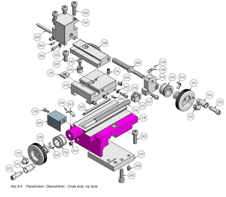

            #209076
              It is worth noting that item 219 is identified as 'Klemmplate' or 'Clamping plate'
              i.e. it is not identified as a bearing surface.
              It would be interesting to see photos of the surfaces.

                Ajohnw
                  @ajohnw51620
                  The saddle drawing in the manual doesn't make much sense.
                  I assume 202 going in from the top is for locking the saddle. The other 202 and 220 look like a very crude sort of push pull arrangement. It only makes sense if 220 is used to alter the angle of the plate and both 202's are used to set the fit. The plate doesn't seem to be supported at the other end which is rather odd but there is signs of a hole.
                  Maybe a photo from underneath might help.
                  I suspect it will show that some bits have been dropped from the design.

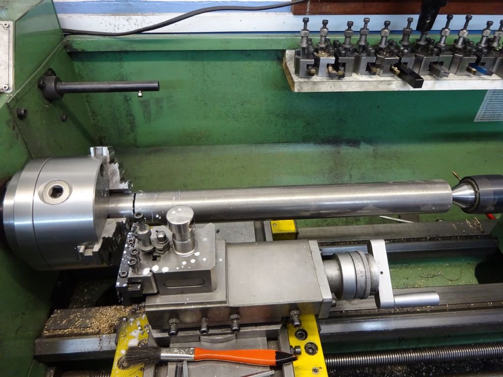

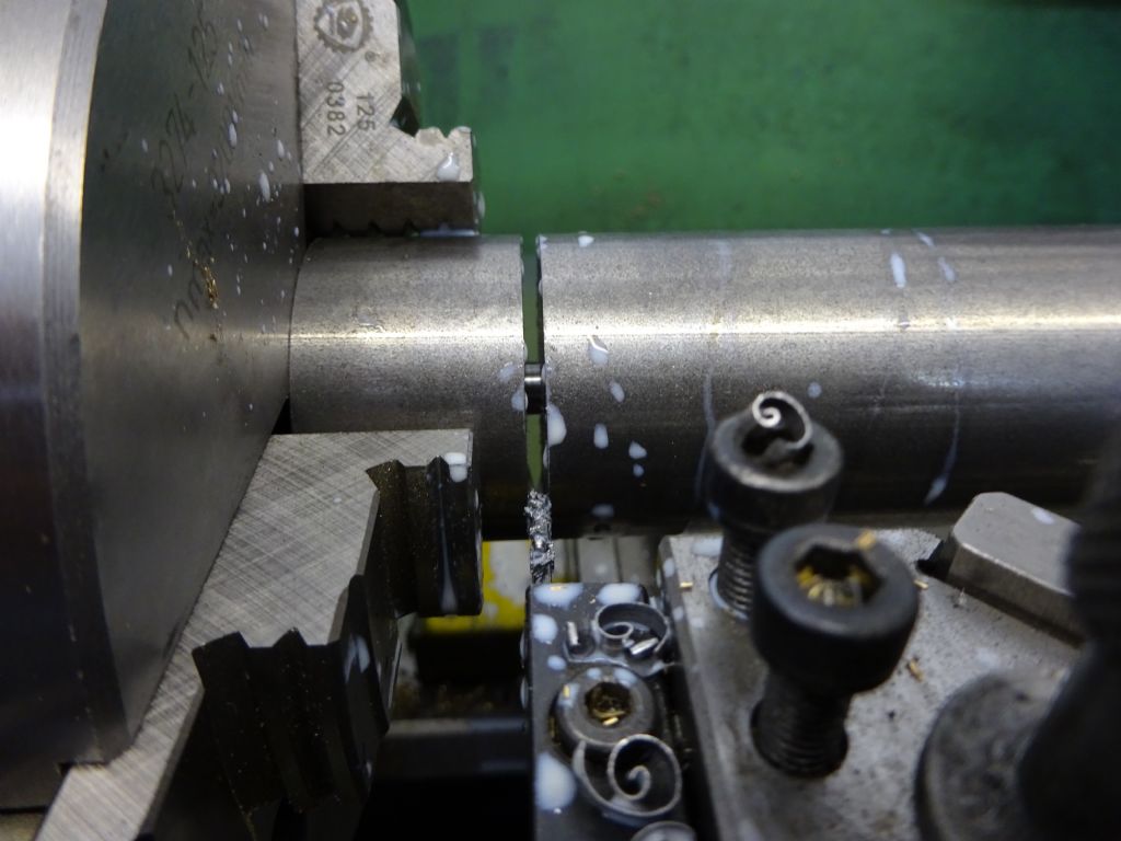

                      Brian, you were asking the other day about parting off with tailstock support. today I needed a short 7/8" piece of 40mm steel so took a couple of pictures for you.
                      The 500mm length of bar held in teh 3-jaw and with tailstock support in a small ctr drilled hole. Parting close to teh chuck as its more rigid than doing it down at teh tailstock end
                      Stop the cut with about 5mm dia left to go, take it out of the lathe and finish with a hacksaw.

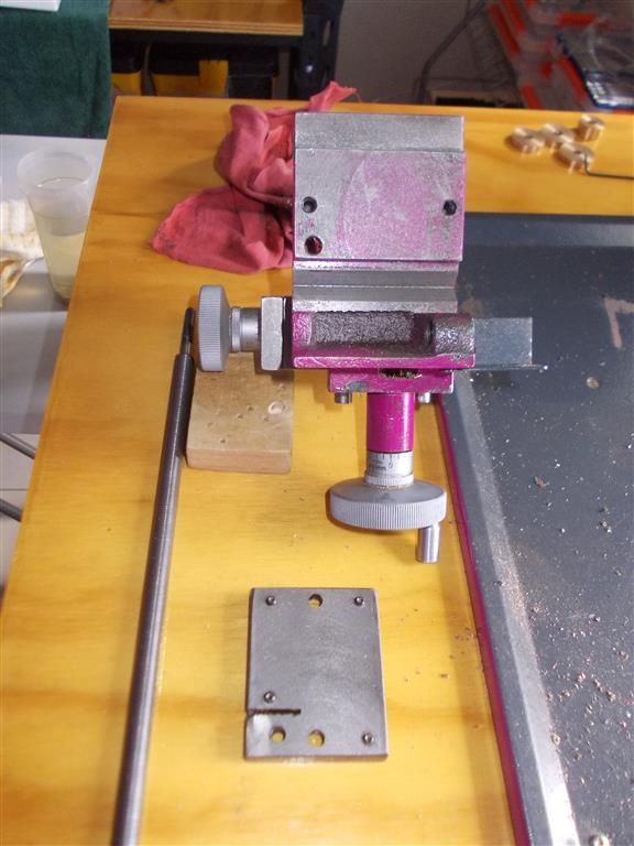

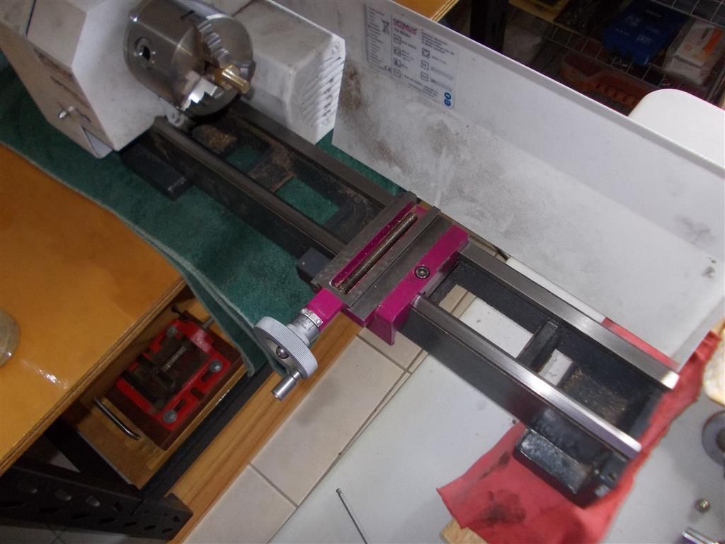

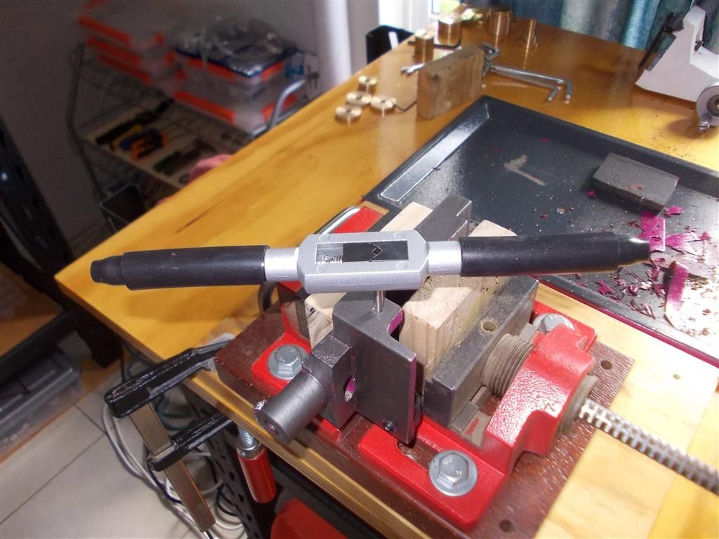

                      Brian John
                        @brianjohn93961
                        I have spent the afternoon pulling the lathe apart to take some photos as everybody wants to see under the carriage and the clamping plate. As you can see, the surfaces are not smooth at all…they are extremely rough but I suppose they do not make contact with each other so they do not have to be. The sliding parts of the carriage that run on the rails are also quite rough. I was surprised at this as I expected them to be finely machined to a perfectly smooth finish.
                        While everything was apart I took the opportunity to remove the awful purple paint which scraped off easily (it was applied with no undercoat or etch primer).The end result is not in the photos. I also drilled and tapped (3mm) the tail stock side of the carriage to take a lead screw cover when I make one in the future. How did I live without a drill press ?
                        The carriage does slide smoothly along the rails but as I have said before, the problem is the adjustment mechanism ; it is always too tight or too loose. There is nothing wrong with the lead screw or the clutch.
                        I have left everything disassembled as you see in the photos. I doubt that there is anything much I can do to improve things before reassembling but somebody may have some suggestions.
                        I wonder if I have voided my warranty yet ?
                        NOTE : those  serial taps from Arc Euro are wonderful. It is like tapping into brass !

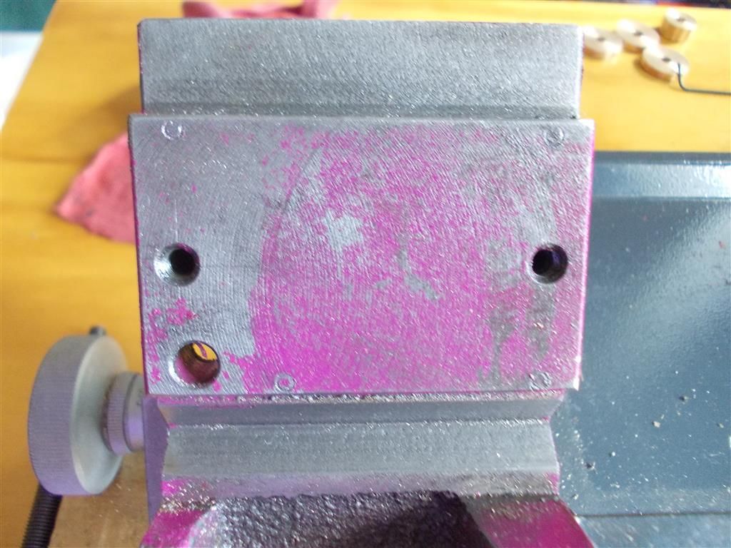

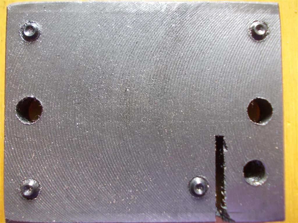

                        #209148
                          Posted by Brian John on 25/10/2015 06:39:38:
                          Brian,
                          Thank you for taking the trouble to do this … the photos are very informative; especially the one that I have reproduced.
                          You say:
                          "…they are extremely rough but I suppose they do not make contact with each other so they do not have to be."
                          But, it is very clear, from your photo, that this plate is making sliding contact with the underside of the bed rails, and I don't think we have a picture of those …
                          If you could manage to photograph the underside of the bed, it might complete the set.
                          Edited By Michael Gilligan on 25/10/2015 08:24:56

                          Brian John
                            @brianjohn93961
                            I am more worried about photo 2 : those sliding surfaces under the carriage should be perfectly smooth shouldn't they ?
                            #209151
                              Posted by Brian John on 25/10/2015 08:21:53:
                              On a better lathe, yes … but you get what you pay for.

                              #209153
                              Hopper
                                @hopper
                                Hmmm, looks like you have the basic rough-machined casting kit one hears of.
                                The very edges of that rough machined "clamping plate" are what runs on the lathe ways at the bottom of the bed. That area really should be a) dead smooth, either scraped or ground, and b) much larger, hopefully there is room on the bed to make a wider plate.
                                What is the finish on the lower bed ways where that clamping plate runs? Is it rough machined like the plate, or smooth ground the like ways on the top of the bed?
                                It looks to me like the main top ways have been ground to a reasonable finish. This now needs to be used as the template to hand-scrape the sliding ways on the carriage to match it.
                                Then the bottom ways will need checking/scraping to make sure they are parallel to the top ways, so you dont get tight and loose spots.
                                Then the bottom clamping plate needs scraping to match the bottom ways so it bears on a large area that will not wear down quickly.
                                Then, hopefully either the cross slide ways on the carriage, or the ones on the cross slide itself, are well enough finished to be used as a template to scrape in the other half to match and get it all tightened up and straight etc.
                                Absolutely not something a beginner can tackle. When you bring it around we can give it a bit of attention and get it sorted properly though. Thankfully the machine is so small it will not take massive amounts of scraping to get it significantly better than it is now. (Bloody hell, an angle grinder could almost get it better than it is now!) In fact, a good seeing to with a millsaw file by an experienced hand will do that clamping plate the world of good and not take very long at all.

                                  Brian John
                                    @brianjohn93961
                                    Michael : perhaps I am just tired (only 4 hours sleep today) but I still don't follow. Can you expand your theory a bit for me ?
                                    Trying to get it to be ''just free'' is the problem ; it is always either too tight or too loose.
                                    (I hate picking this thing up. The only thing to hang onto at the heavy motor end is under the flimsy plastic gear box cover !)
                                    Hopper : I just had a look now. The finish on the lower beds is as rough as everything else…perhaps even worse. The interesting thing is that these surfaces are painted and the paint has not worn off. I think this indicates that there is no contact. Aren't the jacking screws supposed to keep these surfaces apart ?

                                      Brian John
                                        @brianjohn93961
                                        Sorry Hopper, I was looking at the wrong thing. The lower ways are machined but to the same poor standard. Forget what I said about untouched paint…NOT ENOUGH SLEEP !
                                        I think 219 is a clamping plate. I cannot see how it  would work otherwise.
                                        Edited By Brian John on 25/10/2015 11:13:10

                                            frank brown
                                              @frankbrown22225
                                              That locking tab is an embarrassment, it needs leaving loose and being dealt with as a separate job. I would remove the grub screws and use one shim, because you know where you are with them. If the fixing bolts are left slack then a pair of tool makers clamps can be used (one on each side) to clamp the clamp plate to the underneath of the saddle until the slop is down to a few thou' then try tightening the actual clamp bolts.
                                              I would cut off the locking tab and relieve its thickness at the clamping edge and beyond the hole in it, so it compensates for your shim thickness. Putting the clamping bolt in and tightening it will cause the block to rotate a bit but lock up by interference.
                                              This machine is not a very good advert for far east machines is it?
