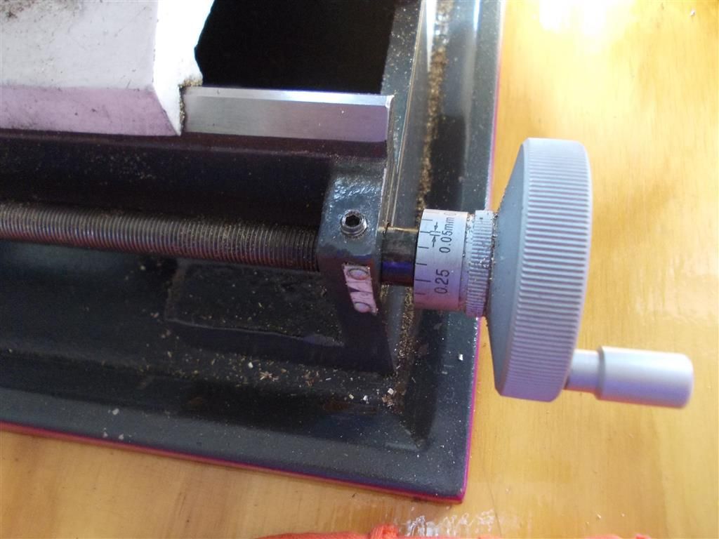

                                          The lathe stopped working again today. More problems with the lead screw. I thought it might be problems with the clutch again but after taking that apart again I realised it was working okay. The problem is still with that bushing 303 : this time the lead screw will screw out but it will not screw in. No amount of fiddling will get it to work properly. Any suggestions ? It seems so simple but I cannot see why it will not work.

                                            Check the carrage is unlocked and you should just be able to slide that to the left which will move the leadscrew and bush with it. Power feed should be disengaged so the dog clutch does not hit end on.

                                              Power feed is not engaged. Carriage lock is not on. It will not wind in ie. carriage will not move to the left.

                                                Sounds like something not lining up in the dog-clutch mechanism for the power feed. You might try rotating the lead screw and feeling if you can get it to drop into the slot in the dog clutch. Or pull the dog clutch mecanism out that you worked on before and see what is going on with it this time.
                                                #208839
                                                Jeff Dayman
                                                  @jeffdayman43397
                                                  Isn't the handwheel supposed to be up against the end of the base casting, that is, should there be a gap between casting and handwheel? Just wondering if the bushing has slipped out and dropped and is jamming things.
                                                  Just a guess, not familiar with these lathes. JD

                                                    That is what I thought : something wrong with the clutch so I pulled that part out to have a look. But even when the lead screw is disconnected from the clutch that wheel/bushing set up will still not work. There is nothing much to it so I cannot see what could go wrong with it.

                                                      Looking at at Johnw W1 post of the 26/092015 09.11.26 with the exploded diagram, the bush 304 should sit completely inside the moveable scale (304). This will bring the scale up against the marker on the cast in bracket. I think what is happening when you tighten up the knob fixing nut, its compressing the whole assembly via the bracket on to the lead screw, so it all binds.
                                                      Paint is not a good bearing surface, so I would strip the end down, fit a tight, thin metal washer up against the main lead screw thread, a gob of grease, then a thin plastic washer (cut out from the lid of a margarine container). Poke the leadscrew throught the hole. Fit another plastic washer, gob of grease, then spacer 303, then the rest of the knob assembly which must sit over and hide the spacer, push it up tight to the bracket. Inspect the amount of thread that is protruding where the nut fits. If its too long there will be a lot of slop, if its too short then tightening the nut will cause it to bind. If you cannot get the spacer to sit inside the knob properly, inspect both for burss, dinks, shallow depth holes, over size spacer diameter and correct until it fits.
