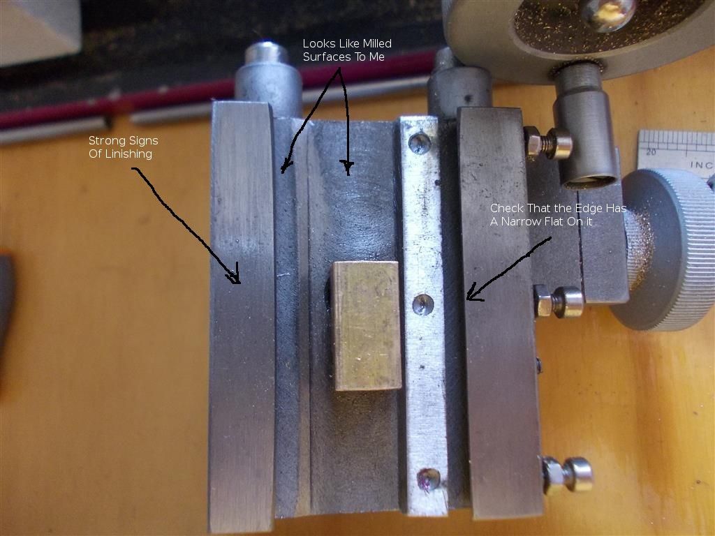

      Brian,
      The 'edge' of the dovetail may look curved, but what really matters is whether or not the actual sliding face is flat.
      It's quite possible (likely) that the edge has been relieved more at the ends than in the middle.

        Posted by Brian John on 16/10/2015 10:04:31:
        Mahgnia : yes, it does look very curved on the side away the gib. Might that explain everything ie. why it is much tighter in the middle ? I may take it off again tomorrow and have a closer look. I must admit that I did not see it because I was not looking for it. I had assumed that they could machine the edges in a straight line !
        John : I assume that machined edges are machined in a milling machine. What are ''ground'' edges ?
        Edited By Brian John on 16/10/2015 10:10:41
        Edited By Brian John on 16/10/2015 10:12:50
        If they had been ground the machined surfaces would be mostly nice and shiny. The bed on your lathe will have been ground. Looking at the photo I'd assume that the male part has been ground and some tool dabbed on it to make it look like it's been scraped. The female part looks like it's just been milled however the Chinese have used a form of linisher in the past, emery cloth belt that is rotating. These linishers are a bit more "technical" that the usual type.
            … Ones produced by a grinding machine !!

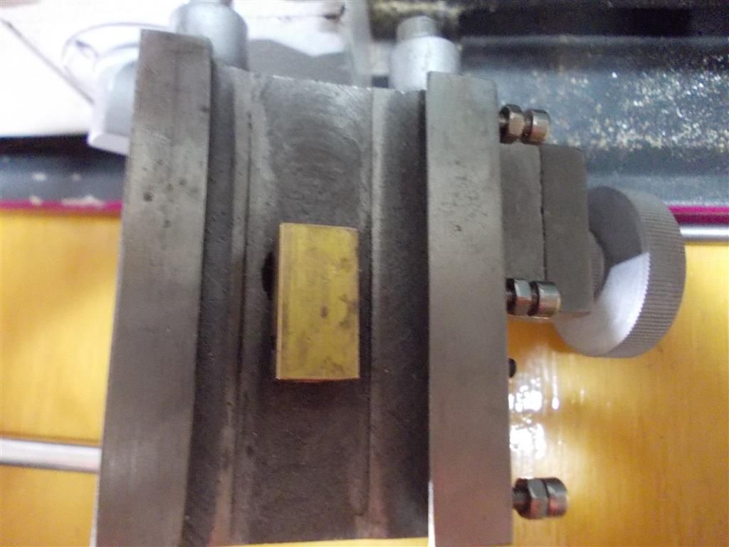

              Brian, can you post some pics showing the wear patterns on the bearing surfaces of the cross slide and mating dovetails. If the ways are not straight, it might show up in the pics. Another thing to look for is that the corners of the dovetails are not binding. There should be a groove machined along the female dovetail where the two faces meet, or at least the sharp corner on the on the male dovetail so it does not ride on the corner and all load is taken of the flat faces.
              Pic of the bearing side of the gib strip might be informative too.

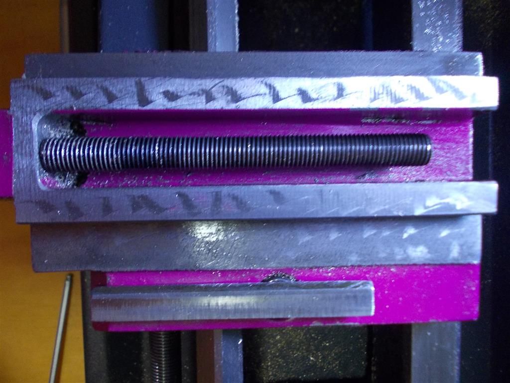

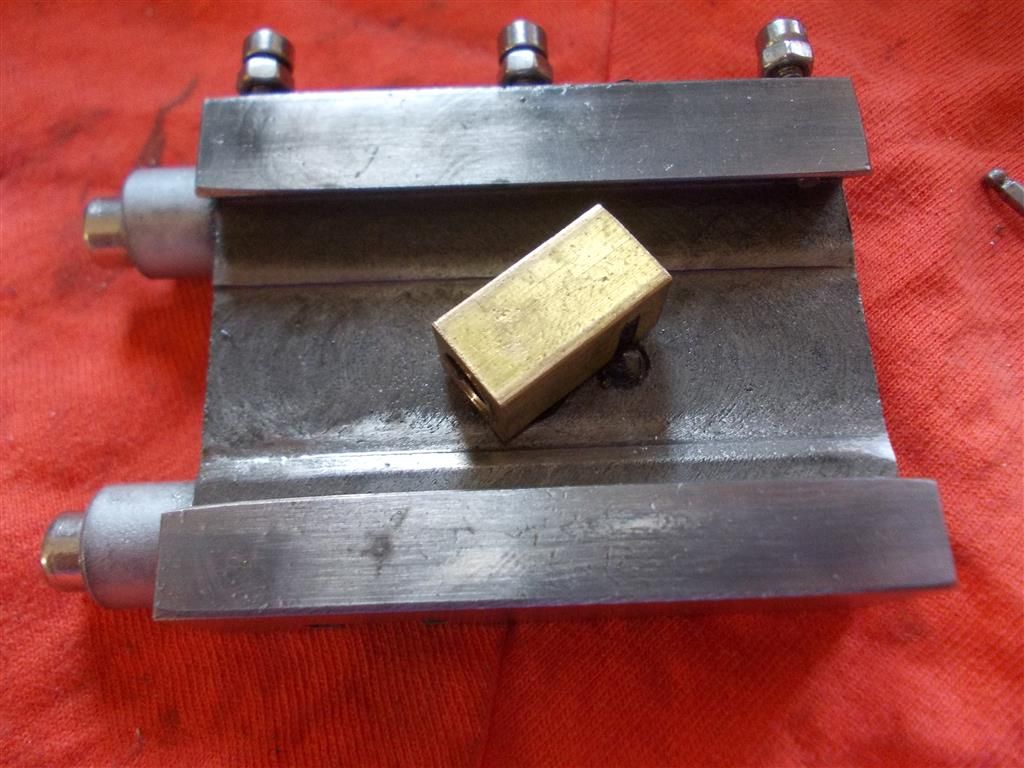

                    Some additional photos. The gib strip is a parallelogram in cross section hence it can only be replaced one way if the dimples are to be on the correct side ie. it cannot be inserted incorrectly. I think those curves on the ends were put there intentionally to help placement of the slide. The female part of the dove tail does look straight although you cannot see it on these photos (night time here).
                    I think I should have left the gib screws alone ; it was better when the ends were flat. I will buy new ones to replace them.

                      The gib strips can be turned end over end with the dimples on the same side Brian and on some lathes that does matter.
                      The top of the male dovetail wont be in contact with the other part – they run on the angled parts and the flats at the side.

                        Brian,
                        I mean no offence to you ['though my intentions towards 'Optimum' may differ]:
                        The surface finish on the gib-strip is poor, and the scraper marks on the male dovetail are just a joke. … The surface appears to have been rough-machined on a shaper, and then needlessly decorated with a scraper !!
                        If you want to get this cross-slide working sweetly, I think you have some fettling to do.

                            Brian
                            Quite possibly, yes …
                            As others have mentioned, you first need to ensure that [where appropriate] corners are 'broken' so that the surfaces that are supposed to slide together actually do. … this is easily done with a decent quality file, and reasonable care.
                            You might then consider improving the surface finish of the sliding surfaces … depending on how bad they are, gentle filing may be useful; but hopefully, lapping [as suggested by John W1] will bring a substantial improvement. … The really important dovetail is the one without the gib-strip, because that one aligns the slide with respect to the bed, and you need to maintain that alignment. … The gib adjustment will cover up a few sins on the other side!
                            The bearing suface of the gib-strip also looks like it could use some attention … ideally it should be a 'mirror' finish, and flat … I restored the one in my Myford, using a fine file, followed an Eze-Lap hone [the red one that I linked for you when we discussed sharpening Carbide tools]
                            If you can do some close-up photos of various surfaces, it would help 'the team' to advise you.
                            Note: All of this is 'to be expected' on a modestly priced 'Hobby' lathe, and it is why they have sometimes been described as a set of castings. … It would be easier if we could afford to buy a Schaublin or Levin <etc.>, but most of us cannot.
                            Take it steady, and look for the areas that you can improve by simpe 'fettling' … in the fullness of time, you will probably go several times round the block as your skills and tooling improve.

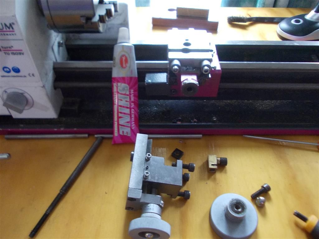

                                  I spent three hours today taking apart the cross slide and then, and ''lapping'' the slides with metal polish (made in Germany so it must be good ! ). I really thought I was getting somewhere. I could feel the tight spot in the middle gradually reducing until things were even right throughout the complete movement of the slide then I would tighten the gib screws slightly and repeat the procedure. I did this for 90 minutes. I put everything back together and the problem is worse. There is huge movement in the cross slide when I grab it with my hands and I cannot get rid of it except by tightening the gib screws up so much that it is hard to turn the wheel.
                                  I am not sure what went wrong here today but I am starting to suspect some other problem not connected with the gib strip or slides. I have my eye on part 213 through which the cross slide lead screw passes. Should this have any back and forward movement in it ? You can see the part in the photo just to the right of the top slide.

                                      Brian,
                                      If that part is the nut for the cross slide screw, it should be solidly attached to the cross slide with NO movement between them. The attachment should only be finally tightened after the whole assembly is assembled.
                                      How is the nut attached to the cross slide?
                                      If the movement is between the cross slide screw and the nut, it looks like there is some adjustment in the nut itself to minimise the backlash. There should be one or two small grub screws in the nut that can open or close the slit in the nut to spread or close the slit and take out most of the backlash.
                                      Do not remove ALL the backlash!
