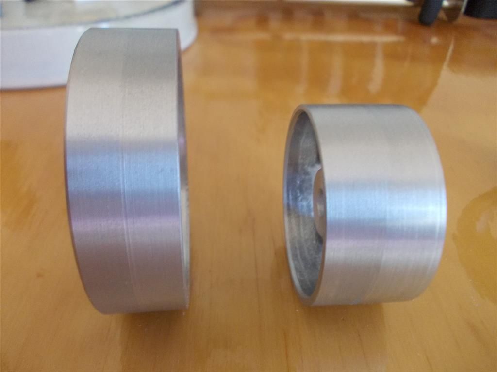

                        A. The tool tip is in line with the tip of the dead centre of the tail stock ; it was the first thing I did when setting up the lathe.
                        B. So clockwise direction looking from the headstock from the headstock. That is ''R'' on my lathe. The opposite direction is marked ''L". I think I was using both directions today !
                        C. I am not using a centre drill. This is a spotting drill which a different thing altogether. I was led to believe that the centre drills are only used to make a shaped hole in the end of the work piece for the tailstock to sit in. Correct me if I am wrong ?
                        D. I was not using any lubricant as I thought it would not be necessary with aluminium.
                        E. I am not using the automatic feed as I want to get used to using the hand wheels and get to know which direction things move in.  I also need to be very careful about staying away from the chuck jaws when machining the outside of the pulley/flywheel. This is a good reason to make a faceplate or a mandrel so I do not have this worry ! Note that Arceuro said their mandrels are not suitable for this purpose as they may break.
                        F. Too much overhang…noted for tomorrow.
                        G. I will keep in mind what has been said about footwear. I do not usually wear shoes in the house but I may have to change that policy.
                        H. I do not want to grind my own tools at this stage. Unless I know exactly what I am doing then I would only be introducing more errors.

                          The centre drill is also used before an ordinary drill. The reason is that even if the tailstock is slightly off centre it's stiff enough to form a hole that will be on centre. That will pull the drill in even if there are slight alignment errors. Otherwise it can skid around and make a right mess even breaking finer drills in the extreme.
                          The reasons for the rings on your work are probably down to hand feeding. It is a good idea to get to grips with that. What happens is that things bend slightly when a cut is being taken. If the feed rate falters it changes the pressure that is causing things to bend so rings form. It can be surprising just how visible rings even a few microns deep can be. It's not the easiest thing to do but needs 2 hands to maintain the same feed rate so that the other hand's fingers can be repositioned to maintain the same speed. Cock eyed explanation but you should realise what I mean. With practice you will do it even when the hand wheels on the lathe are rather small.
                          On thing I didn't mention on the photo you posted earlier is that you might get better results with the tool more angled into the work. It might also be worth trying to work away from the chuck at the angle it's at rather than towards it but you will probably only be able to take rather shallow cuts and might get chattering as the tool is fed in a little. Tightening the slides as I suggest can help with that. You might also like to try locking up the top compound slide when you your not using it.
                          The oil was for the slides – not the work.

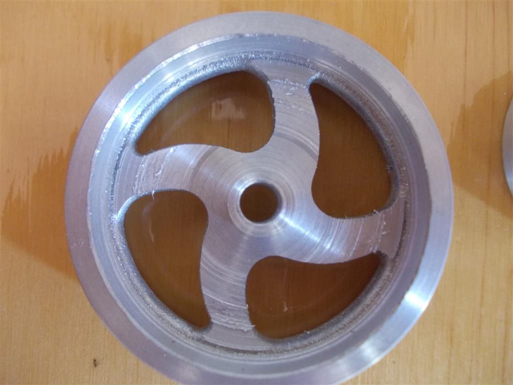

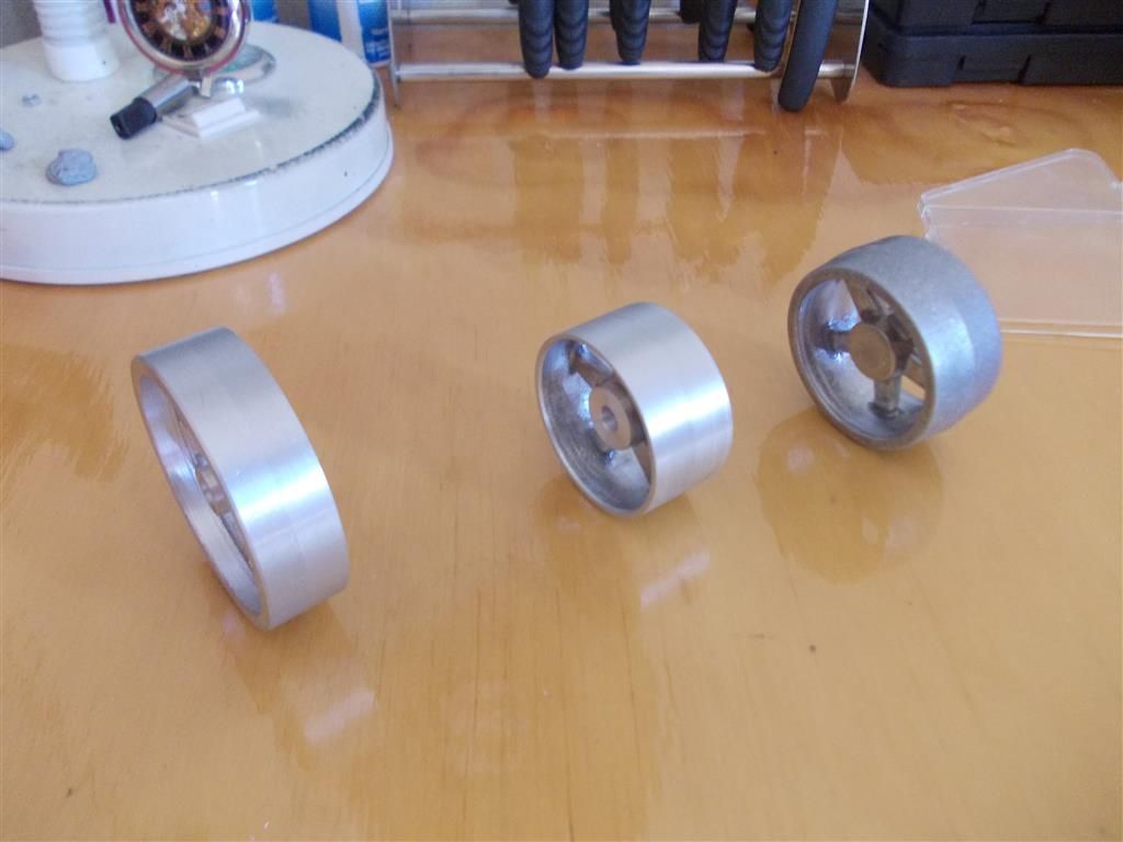

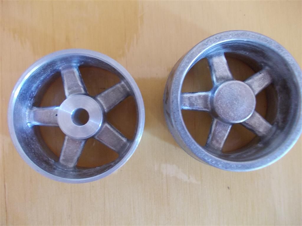

                                          More machining today with some good results and some bad. I got a much better finish using the correct tool with minimum overhang and running the lathe in the correct direction. I could not clean up the mess I made of the spokes though.I seemed to have made it worse today plus the hole is no longer in the centre…I am not sure what happened there !
                                          Obviously I will stay away from the spokes in future. Most people do not machine them for a reason.
                                          It is a bit difficult to eliminate that line in the middle on the outside surface. This is the problem with trying to machine it without a face plate or mandrel. Staying away from the chuck jaws is a bit scary too. It is time to think about making a face plate or a mandrel.
                                          I choose an aluminium pulley with a wider surface for next project ; this gave me more room to stay away from the jaws. I also tried to camber it but I think this is a bit ambitious for me at this stage. I almost had it a few times by turning both wheels by hand at the same speed. In the end I gave up on the camber idea but I did end up with a machined pulley with the hole in the middle. However as you can see by comparing it with an original untouched pulley I did take a lot off while getting there !
                                          How do I put a chamfer on the edge of the wheels and the hub ? I am not sure which tool to use. At the moment I am using a hand held file with a round handle and holding it against the flywheel while the lathe turns at a very slow speed. Is this acceptable ?
                                          NOTE : I bought a pile of flywheels and pulleys from PM RESEARCH a few years ago when the Australian dollar was actually worth something. The aluminium ones were very cheap.

                                            If you removed or disturbed the flywheel then the hole will no longer be concentric with the lathes axis…..especially with a three jaw chuck.
                                            You would need to 'clock' it to return it to its original position ……..Another learning experience…

                                              Posted by Brian John on 27/08/2015 08:14:37:
                                              … the hole is no longer in the centre…I am not sure what happened there !
                                              Brian,
                                              Once you have made that hole … it needs to be your master reference for any further work.
                                              I trust that our esteemed Editor's alter-ego will be along soon, to discuss the simple device that bears his name.
                                              Meanwhile, may I refer you back to your previous thread, where there was some very relevant discussion.

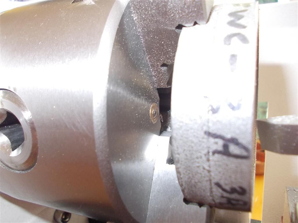

                                                I think a mandrel must be the next project but I am not sure how to cut the slots in the end. What size thread/screw should be used on a 6mm mandrel…would a 3mm screw suffice ?
                                                NOTE : there is no 4 jaw chuck or face plate made for this lathe. They do make a fixed and travelling steady but they are not yet available in this country. This is a new model.

                                                  Could it be possible to hold the casting on its inner diameter using the outside jaws, giving you clean pass on the outside diameter?
                                                  perhaps the jaws could even pass between the spokes giving you more than enough to grab, depending of course on the layout and options of 3 or 4 jaw chucks available to you.
                                                  I tend to mark my chucked stock with pen or paint (sometimes a scribed line or centre mark) and align that to jaw 1 to keep things grabbed in roughly the same place –This is absolutely no substitute for carefully planned machined operations to ensure concentricity and is probably ultimately considered bad practice – I just like it because if I pick up a previously machined bar I can chuck it up in my wonky worn out general use/abuse 3 jaw chuck and align the jaw to the mark and minimal material removal is required to true it back up.

                                                    I'm very much a beginner so take my advice with a pinch of salt but the way I've found best for making small flywheels. Is first drill the centre hole to the final size you need, then make a very close fitting mandrel with a threaded end. Next bolt your wheel to the mandrel without removing it from the chuck, do all the necessary machining to your wheel then turn it over and do the other side again without disturbing the mandrel.
                                                    I've found with small wheels if the mandrel is a good close fit you can achieve a good true running wheel, I wouldn't like to guess at the maximum diameter you could do this but it worked fine for the 3" one I made a few days ago.

                                                      Posted by Brian John on 27/08/2015 10:14:09:
                                                      A plain diameter, that's a sliding fit in the hole, would suffice … fix it with Shellac and remove with heat.
