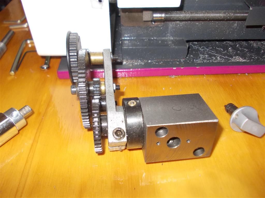

      324 is still fitted ; it is connected to all the gears. I will post a photo tomorrow.

          Perhaps the other 323 in 326 locates it. It doesn't seem to have any other purpose. It looks like 326 is still attacjed in the shot. Maybe they dropped the other bits and decided to rely on the ball to hold the dog clutch in place or the parts have worked loose so just need resetting.

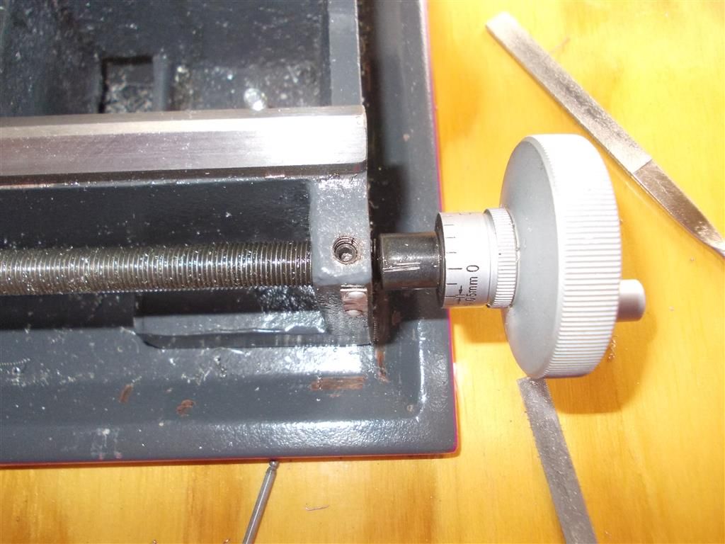

            I am still not sure what is wrong at the tailstock end. That should not have come loose either nor will it stay together. But I will deal with the headstock problem first…tomorrow afternoon after I wake up. I am still not convinced that 320 is even there !
            Looks like at the tailstock end, according to the drawing, grub screw 302 bears on the bushing 303 and holds it in place. The bushing is captive between the end of the thread on the leadscrew and the handwheel assy.. Probably needs a small dimple drilling on the outside of the bushing for the grubscrew to locate into.

                        Its also interesting to look at that long gauge on the boss that holds the tailstock end into the bed. Would that be caused by a loose screw? Looks like the carrage or tool may have been run into something, the feed screw continued to turn and as the carrage could not move the screw wound itself out to the right pushing teh boss with it.

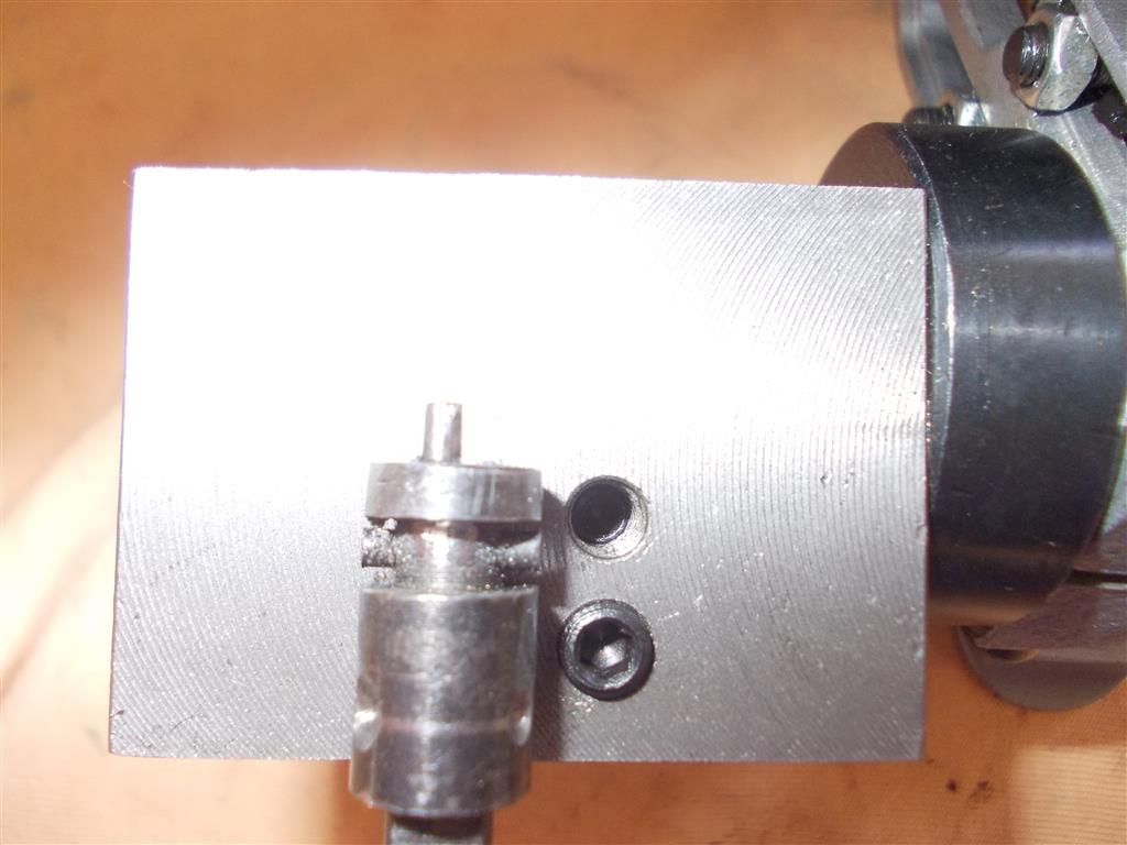

                              Why did they do that ? Because the pin 315 is in the way. I suspect when they tried to assemble this section they realised that they hade made a miscalculation so rather than try to fix it they came up with this solution. You can see in the photo below which is taken of the underside. Large grub screw is for the ball and the smaller grub screw sits in on top of 320.
                              I did try to install shaft 314 upside down ie. so that pin 315 would be on TOP when assembled. I am not sure this would even work but I tried it anyway. But it will NOT go in. I am not sure why but I cannot get it past the ball 317 when assembling this way. (The indents for the ball would also be in the wrong position.) It should go in but I thought I would leave it there for now and consider my position.
                              One possible solution is to file off that part of pin 315 which is blocking 320 but I am not keen on doing that as it may weaken the pin.
                              Edited By Brian John on 27/09/2015 06:47:05

                                You could see if 315 can be pushed out a bit further, maybe possible to lever it out with a flat screwdriver placed in the groove. Filing won't weaken anything
                                You will need to slacken off the larger grub screw so the ball drops a bit then 314 wil push in.
                                Edited By JasonB on 27/09/2015 06:52:47

                                  I think filing 315 might be better than trying to push it out. If I push it out then it might loosen a bit and I certainly do not want it coming out.
                                  Yes, slackening off the larger grub screw for the ball SHOULD work  !

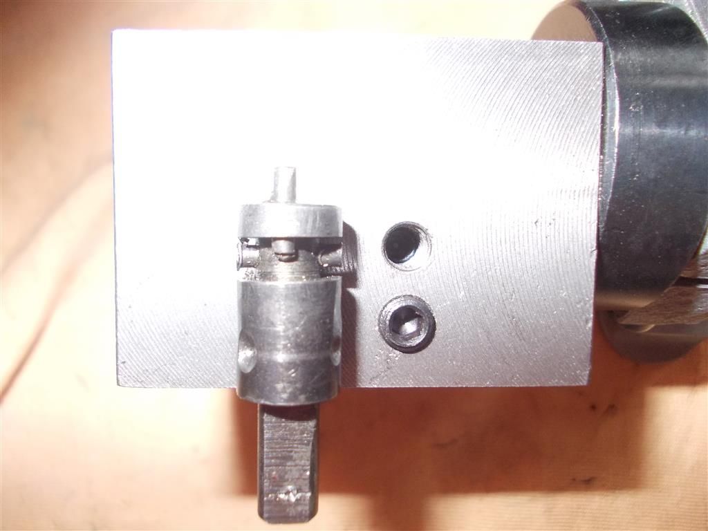

                                                      Things are looking better now. I cut pin 315 with a dremel tool and this allowed 320 to sit in the recess. Everything seemed to go back together reasonably well. The manual/auto feed switch works and it cannot now be pulled out. Just after doing this, I received a phone call from their the company. I spoke to their chief specialist who does all the repairs and we discussed this problem and what to do at the tailstock end. He suggested as others have done, to drill an indent so that grub screw 302 can sit properly on the bush 303.

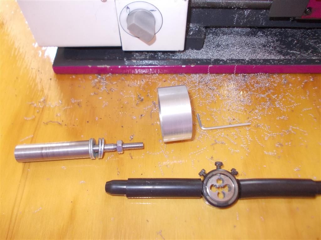

                                                      He suggested using a 4.2mm drill bit ( it is a M5 X 6mm grub screw) but I did not want the drill bit possibly rubbing against the threads so I used a 3.5mm drill bit instead. It seems to have worked. I finished turning one steel mandrel and cut the thread on it. Then I used the mandrel to turn an aluminium flywheel. I am still not happy with the finish on steel but I think that is caused by operator inexperience and the tools bits not being quite sharp enough.
                                                      The die holder has been fitted with rubber sleeves to stop it knocking against the lathe parts as per Hopper's suggestion. I was surprised that cutting the thread on steel was no more difficult than cutting aluminium. But I really must make a spindle handle soon !
                                                      I did forget to put in grub screw 323 but there was no way I was going to pull the whole thing apart again . I managed to get my fingers underneath the block 321 and got the thread going by hand and finished tightening it with a small allen key which only just fitted underneath. Lesson : make sure there are no screws left in the tray !
