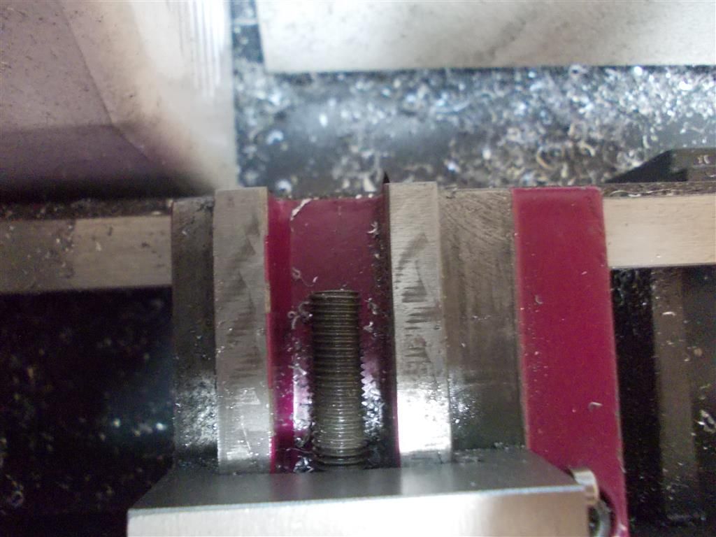

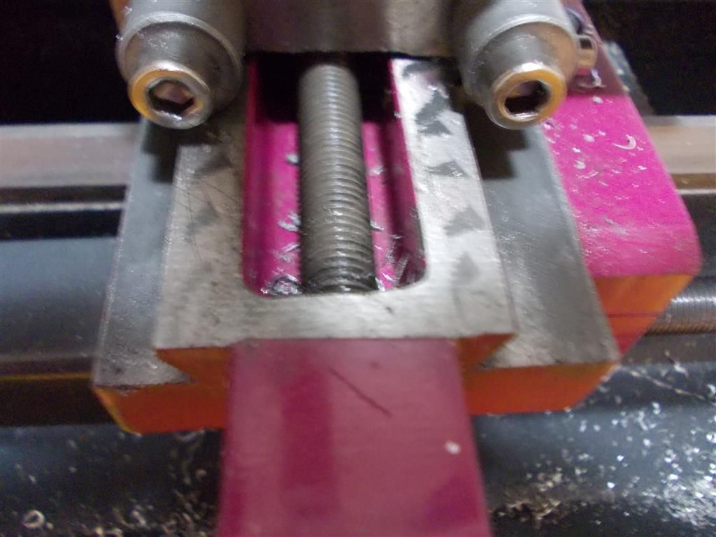

                      I am not sure what these marks are on the cross slide ''rails''. Should they be there ?

                        Bit of hand scraping, nothing to worry about

                          I think you might find that surface with the marks on it is not a bearing surface. It seemed to me when I looked at it the other day that the two bottom surfaces were the load bearers and were much smoother than the upper surface.

                            Ah, yes…that makes sense. The cross slide is now lubricated with machine oil. I will see if it holds tomorrow.

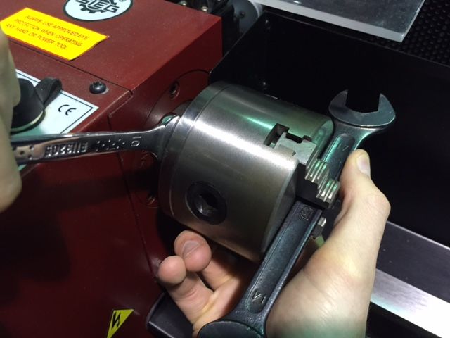

                                  I have been in contact with the Australian company again today regards the steadies and the 4 jaw chuck. They are going to contact the Chinese factory where they are made. I am surprised that the steadies were not ordered/supplied with the lathes as these are also are very cheap. The German company quoted me 30 Euros for both (but 200 Euros postage !).
                                  I will buy a 3/8 inch combination spanner tomorrow and I will have a go at unbolting the lathe chuck later this week. I think it was Ketan who wanted a photo of the back to see if it is generic chuck fitting. I only have metric spanners and an adjustable spanner but these nuts are on very tight so I need the correct tool to remove them.

                                    Check the size of the nuts, you probably want 10mm not 3/8. Also if its anything like all the other far eastern lathes you wont get the combination spanner off once the nut lossens as there is not enough room between headstock and flange. Does the lathe not come with an open ended spanner?

                                      Provided it is a generic Chinese 80mm chuck, Jason is correct in suggesting the use of a 10mm open end spanner. To help you with releasing the nut, put/hold another spanner in the jaws, as a lever to hold the chuck down, before trying to loosen the nut. See picture below. Hope it makes sense:
