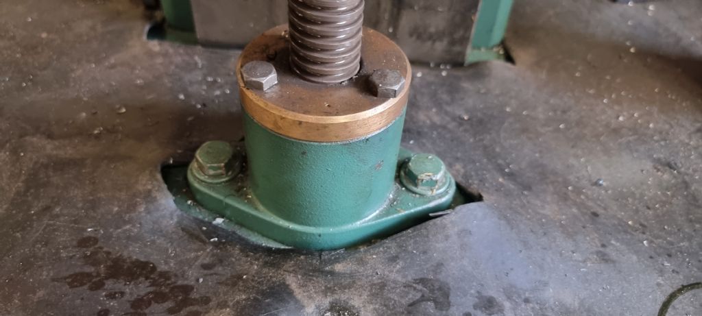

      14 months after Ian Skeldon 2 tested my threading tool for his Myford VMC, I shall be making the 1" X 5 ACME nut for the knee of the museum's Tom Senior light vertical. Probably just in time, the original nut has only 1/4 of its thread width left. This job also entails raising the main body of the mill 25mm to add to the Z axis height. The price of a slab of steel or aluminium 25mm thick was more than I wanted to pay, so I got a length of channel section mild steel cheaply and Alan milled the top and bottom down to the required 25mm. The channel will sit flat side upwards in two sections under the main pillar and 3" BSF bolts will hold everything down. The Z screw is plenty long enough to accomodate the extra height. I spent several hours getting the knee to move the full distance without binding or becoming loose, and now it is right, the gib screws will not be monkeyed with. I will post some pictures soon when the threading gets done. The original nut has an integral flange which would make it very expensive to make, I will bore it and loctite the new one inside.

            _igp2984.jpgThe nut now has threads, and the backlash is better than 0.001", the old nut has 0.018". I will turn down the new nut to fit in the cast iron base and thread the end so that the bronze flange from the old nut can be threaded and screwed on and loctited. The two bits of channel section will fit under the main body and allow an extra 25mm of Z travel and height.

              #606082
              old mart
                @oldmart

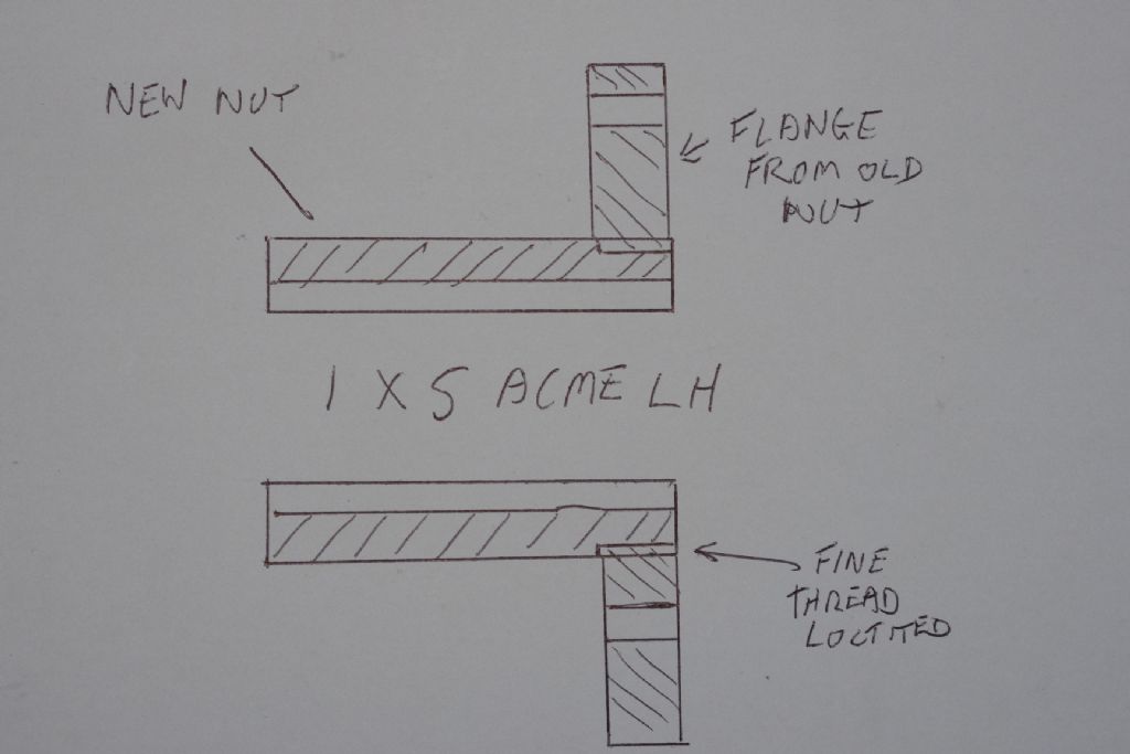

                This is what I have in mind.
                #606083
                Steviegtr
                  @steviegtr
                  Ah yes I see what you mean. Fingers crossed. I guess you could even silver solder if needs be. Although thread soak might be an issue. Great idea so far.
                  Steve.
                  #606084
                  old mart
                    @oldmart
                    A 40tpi thread would take up a very small part of the diameter, we don't have enough heat available to silver solder that size. When I renewed the leadscrew nut on the Smart & Brown, I made a thinwall inlay and soft soldered it onto the bored out block, but that had a much greater surface area, about 5 square inches.

                      I wonder if you could pin it.. just in case the locktite came unstuck.
                      Steve
                      #606086
                      old mart
                        @oldmart
                        Several 1/16" pins fitted axially through the thread would be very secure. I would check the dimensions carefully before machining the parts.

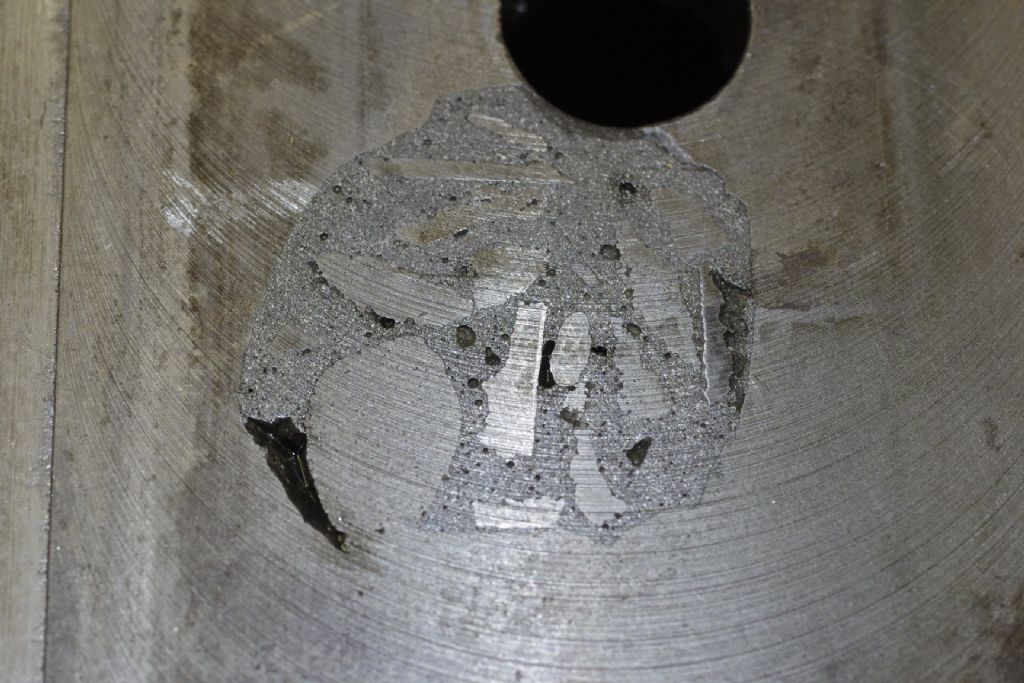

                        Did you notice the Tom Senior bodge to make things fit? A clue, look at the hole in the green cast iron nut support.

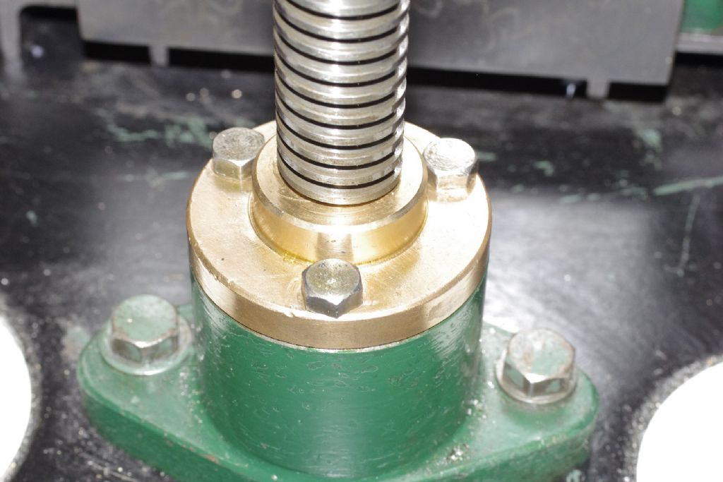

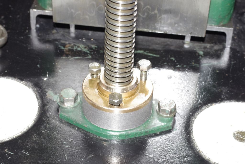

                                #606823
                                old mart
                                  @oldmart

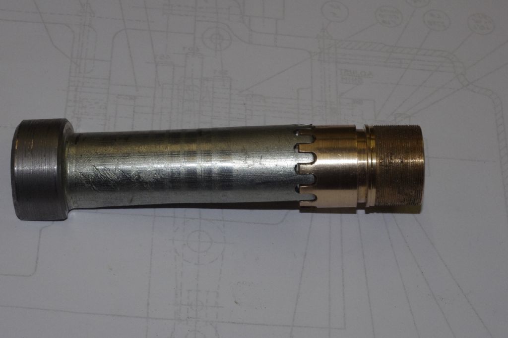

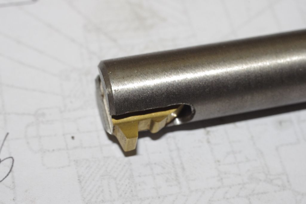

                                  _igp2995.jpg_igp2994.jpg_igp2996.jpg_igp2993.jpgWe have completed the new nut, the parts screwed together with a 28tpi thread, LH for ease of manufacture and Loctited, no pins, I'm hoping they will not be needed. The 25mm high Zaxis extension is under the main body and the bore at the top still just misses the building cross brace supports. The longer screws were late coming,1 3/4" long 3/8 BSF standard to 2 3/4" long, so I have made some today as it is not safe to keep adding weight until the body is secured to the base. The screws were through the letterbox when I got home today, so they will be spares for something.

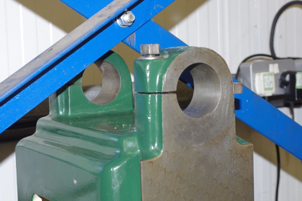

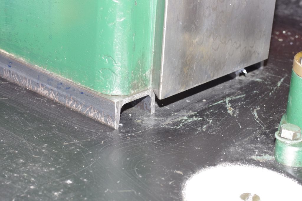

                                  While the mill is in bits, I photographed the casting defect in the Yaxis to show you, good old Tom Senior.

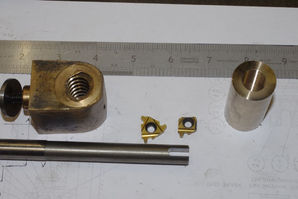

                                    _igp3000.jpgToday, I decided to look into making a new Y axis nut. I had already made a pair of backlash adjustable X axis nuts, but the X has a right hand therad and the Y has a left hand thread. The 3/4" X 5 ACME taps are £40 from Tracey Tools and I only had the RH one. The start size is 0.55" for this thread, and the 5tpi ACME laydown inserts are er22 size, so its not going to happen without some modification. I have some 1/2" Densimet bars with one end turned down to 12mm. The er22 inserts are 3/16" thick, so I decided to cut a slot in the end of one of the Densimet bars and silver solder a modified insert in. The new Clarkson 3/16" hss slot mill was destroyed before it had cut 1/8th of the slot, so I had to resort to a 5mm solid carbide which is 0.0093" bigger. Densimet is tungsten, sintered with iron and is not anything as hard as tungsten carbide, is denser and has a higher Youngs modulus than steel. It makes good holders for carbide inserts. In my hurry to get going, I made the tool much too long, even to thread the 50mm hole in the gunmetal I was using. Because of the length of 12mm and the tool support being made for 1/2", the whole of the 12 mm was overhanging by at least 3". The workpiece should have been cut down to 38mm long and the length of 12mm should have been about 43mm long, much better than the 76mm that I used. The thread is about 95% done, but I will remake the tool to the shorter dimension to finish off. With a coarse thread like this, even with a female one, it is easy to realign the tooling if needs be.

                                        One of the ACME inserts in the photo is the one that you kindly sent me when you returned the threading tool. Having two was the reason I cut one down to get into the smaller 0.55" start diameter for the Y axis nut it really is pushing the limits for the pitch, a 5/8 x 5 would never singlepoint.

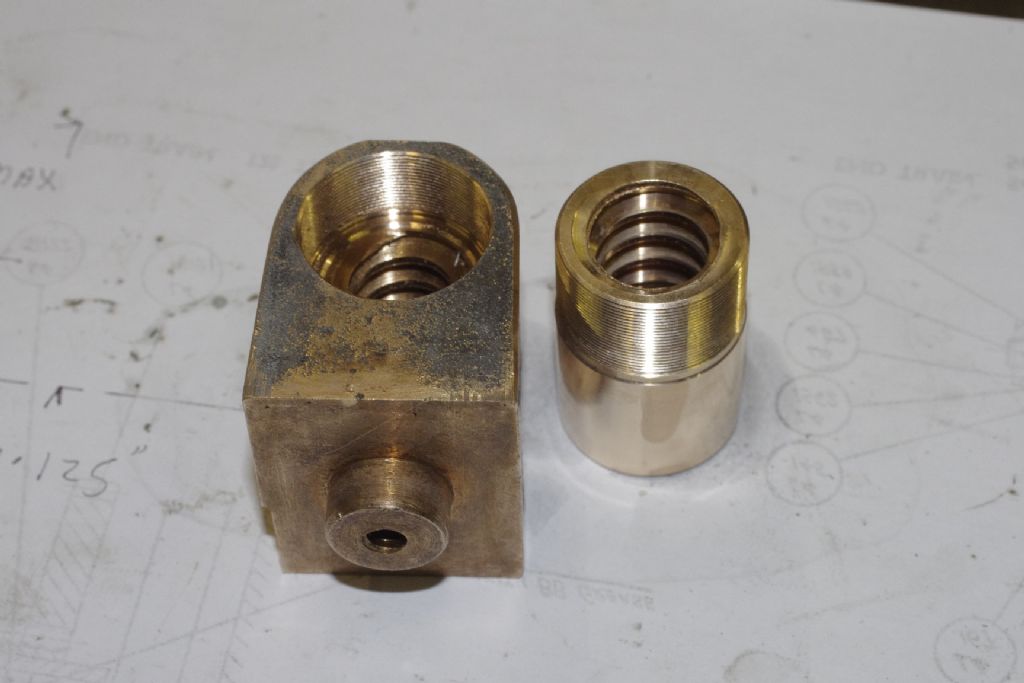

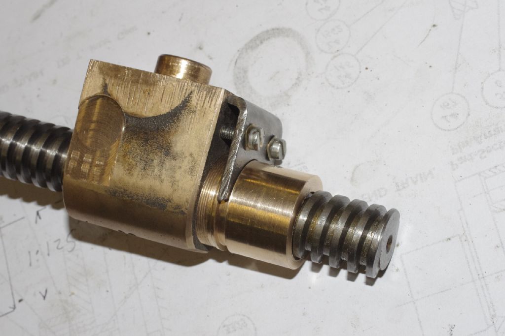

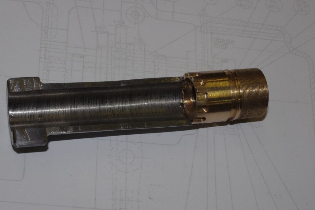

                                          _igp3002.jpgThe Y axis nut is nearly finished, I have to think up a way to lock the settings. The original nut has been shortened to 1 1/8" and the new 1 1/2" long nut screws into it with a 40 tpi thread. The nut assembly screws onto the leadscrew after backing it off 1/2 a turn from fully screwed together.

                                              You would be surprised just how easy it is to pick up an external thread,even that 40 tpi. The backlash must be taken out first by clamping the leadscrew nuts and then turning the spindle in the direction you are cutting in.Then you advance the tool tip close to the original thread and shine a light through the gap with some white paper behind and as the tip of the cutter fits into the vee of the thread, it is easy to make the final adjustment dead central.
                                              I had to pick up the internal 5 ACME thread when I had made an improved stiffer threading tool, that was done by feel with the tool loose in the toolpost to not only set the axial, but also to keep the tool parallel with the spindle.8
                                              With the nut idea, I would have to set up the old nut and face the end true, so a locknut would sit nicely. Shame I didn't think of that when I was threading it.
                                               Now I'm thinking of it, I could face off 1/8" without loosing anything and there would be about 1/4" of thread for a nut anyway.

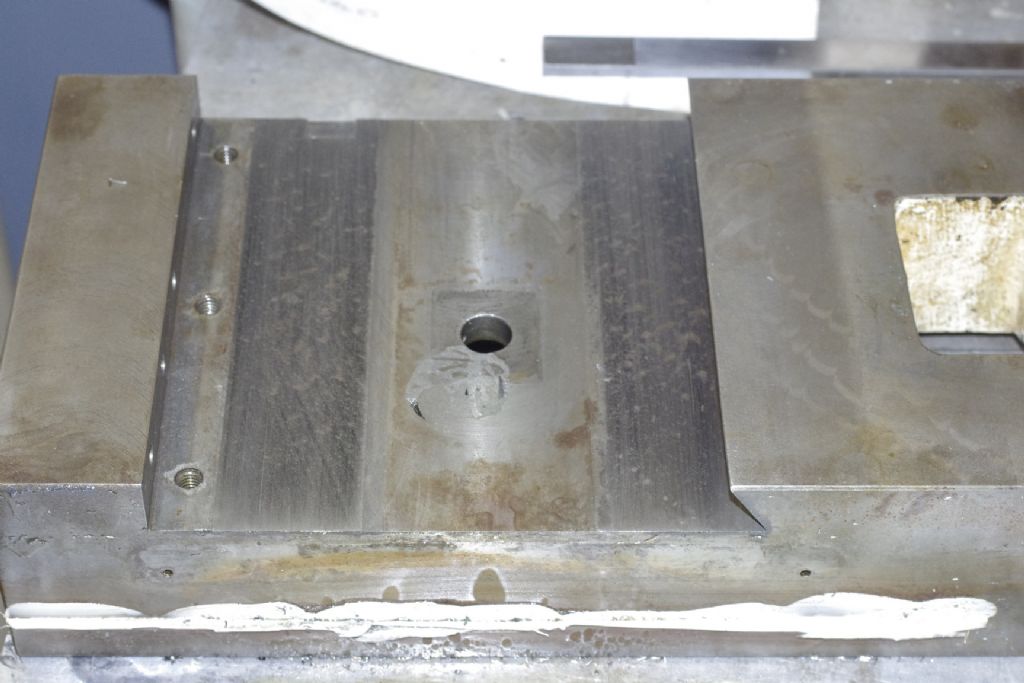

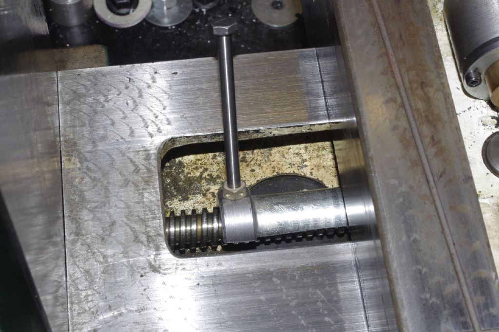

                                                _igp3004.jpg_igp3003.jpgToday, I decided to go for an even simpler option, just a clamp on the side of the nut. I am getting 0.004" backlash in the most worn centre of the leadscrew, and nothing either end of travel for the Y axis.

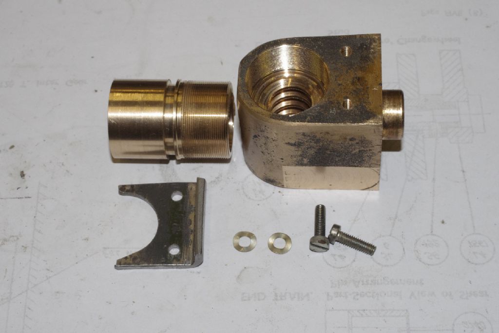

                                                  _igp3013.jpg_igp3011.jpgWhile the Tom Senior is in bits, I decided to make the Yaxis nut backlash adjustable without didmantling the machine. The pictures show my way of doing it and Mike and myself did some turning, hacksawing and milling to make a tool that can reach under the Y axis.

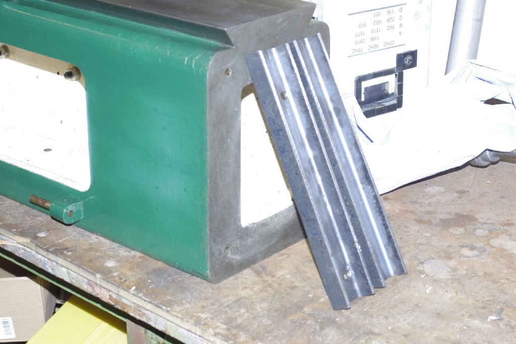

                                                      Nearly, but not quite right, the knee being extended by 25mm to increase the Z height slightly has not exactly gone to plan. The knee stops at plus 25mm from the bottom. Investigation found that the top of the nut was running out of leadscrew thread. Not slowly binding, but stopping dead. It is easy to check that it is indeed the nut running out of thread because if the knee is raised to near the top of its travel,and locked, the nut can be screwed up until it stops and the nut height recorded. Then the nut is returned to the bottom of the leadscrew and the distance that the bed can be lowered is the same.
                                                      The nut flange has been thinned, and the height of the cast iron base that the nut sits on shortened. The flanges on the nut base are wide enough to foul the narrow underside of the knee, so they have been turned smaller and the bolt seats have been chamfered to use countersunk head 3/8 W bolts (in the post ).
                                                      It is possible, just, to remove the nut and nut base without taking everything off of the knee. I rotated the head 90 degrees clockwise and wound the bed right up to it. The nut and base can be blocked up when lifting the last bit and then the knee locked and chocked. The nut on its own can be screwed up the leadscrew and there is room for the nut base to be removed followed by unscrewing the nut. I have added a picture of the modified nut assembly to compare with the old unmodified one earlier in this thread. The screws remain to be sorted at present.
