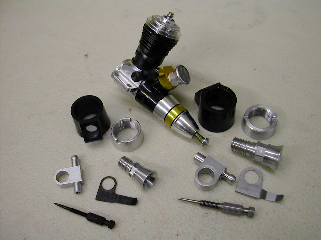

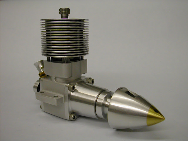

Well further to the last post I’m glad to say things are now back to square one
New parts have been made and they are much more in scale and in keeping to the original.
This shows before (on the left) and after (right) and the engine from which the parts were copied.

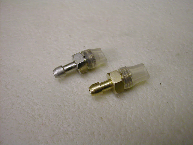

The other accomplishment has been the nickel plating. I was not happy with the previous parts so re-cut all the hex surfaces and began again. I also cut several more small test pieces from the same bar. Starting with these at perhaps a somewhat more observant pace I found the initial flash of plating was quite shiny and formed rapidly – a matter of seconds in fact.
I had also misled myself by thinking that the plating action should give off a rapid fizzing and began with a current which created such but it quickly became obvious that this was detrimental to the finish. By reducing the current right down until the fizzing was barely perceptible the finish showed a dramatic improvement.
By the time I felt ready to try the parts again I was down to very low current and literally dipping the part in and out of the solution for no more than a couple of seconds.
It still proved slightly inconsistent part to part but the results are far better than the first attempt and give an acceptable overall look installed on the engines. The solution used was bought off ebay – a litre for 9.99 plus postage. There is sufficient nickel in the solution for a small amount of plating without the need for a nickel anode. It appears to have worked well on this basis in this situation so its fair to say I’m well pleased with the outcome – albeit not perfect it proved much simpler than anticipated.
This was the first part done – the silicone tube is to prevent the threads from plating – lesson learnt the first time as they became very tight in the intake!

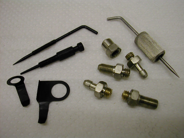

Degreasing is obviously an important factor too. The parts were cleaned in acetone first then washed in water. A 2-3 min dip in 10;1 sulphuric acid followed by another wash then a final 5 min soak in distilled vinegar and salt solution as recommended. Despite this I feel the parts were still not clean enough in areas. On the larger knurled needle valve the area which must have had some flux residue from soft soldering the needle in
simply would not plate at first until it had really been abraded using a small piece of Garryflex abrasive block. Even now there is a change of colour that whilst acceptable can still be seen.
All the parts finished including the ‘backadised’ parts. This was done using Koldblak – nothing very special to that – it’s very easy to do but what is surprising is that the Koldblack was bought in from my works in 1985 and this was done in the small tub of solution mixed originally all that time ago. Some shelf life eh
It’s so long ago I have forgotten the ration of neat Koldblak to water – 5 to 1 seems to ring a bell – does anyone know the correct ratio?

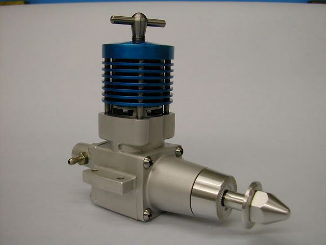

Well if all goes well the anodising should be done next week then it’s time for a run up
