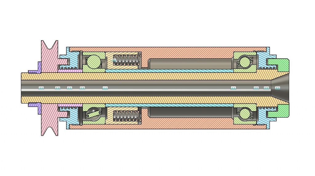

                                          #639693
                                          Fulmen
                                            @fulmen
                                            Here's the spindle assembly all drawn up:
                                            #639711
                                            gerry madden
                                              @gerrymadden53711
                                              Fulmen, nicely drawn spindle. I think you might need to extend a few of those threads to make it assemblable, but I'm sure you realise that already . If you are making this yourself then here are a couple of more helpful points to consider:-
                                              1) The solid abutment within the housing could be made as a separate sleeve which is then located in place by a couple of screws from the outside. This could be easier to make, and potentially more accurate too in terms of squareness of the important right-hand abutment face. (This is how J&S do it on grinding spindles.)
                                              2) You have incorporated a pair of AC type bearings which is the traditional choice for such spindles. However, its extremely likely that a pair of conventional deep-groove ball bearings will be perfectly adequate here, technically, and will of course be significantly cheaper too. By selecting a C3 clearance grade, provided you shaft interference fits are not excessive, they will automatically become an approximately 15deg angular contact once loaded by the spring-box arrangement.
                                              Gerry
                                              #639730
                                              Fulmen
                                                @fulmen
                                                Thanks, that's good advice. The drawings aren't checked for errors yet, and they will be "metrified" before construction. So plenty of time to add my own errors
                                                #639732
                                                John Haine
                                                  @johnhaine32865
                                                  Nice drawing – essentially a Quorn type I think? The Quorn has an 8mm taper that matches a standard watchmaking type of collet I think – these collets are quite hard to find and expensive. You can of course just use a plain tapered mandrel but if you were thinking of fitting collets as well maybe consider an ER16 nose? You could use it with a drawbar for wheel mandrels and have the option of collets.

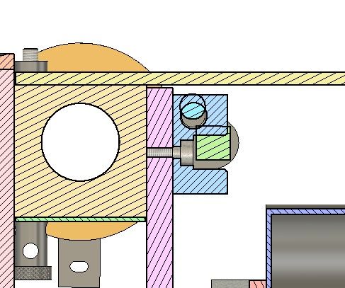

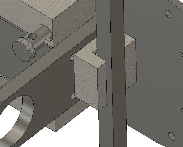

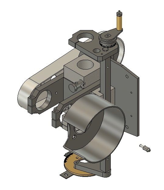

                                                    #640050
                                                    Fulmen
                                                      @fulmen
                                                      I'm a bit stumped now. I've been working on the wheelhead and something doesn't add up right:
                                                      The wheelhead guide (Drg 11, Det 1) does not line up with the jack screw (C10 Det1) and the square guide rod (C11, Det 2). I've double and triple checked the drawings and I can't find any mistakes. Also the guide collides with the mounting bolts for the wheelhead arm (C3 Det 1). I've checked both Don Williams original PDF and this metric one: http://www.mosoft.nl/slijpmachine/A0%20Bonelle%20TCG%20drawings%20Metric.pdf
