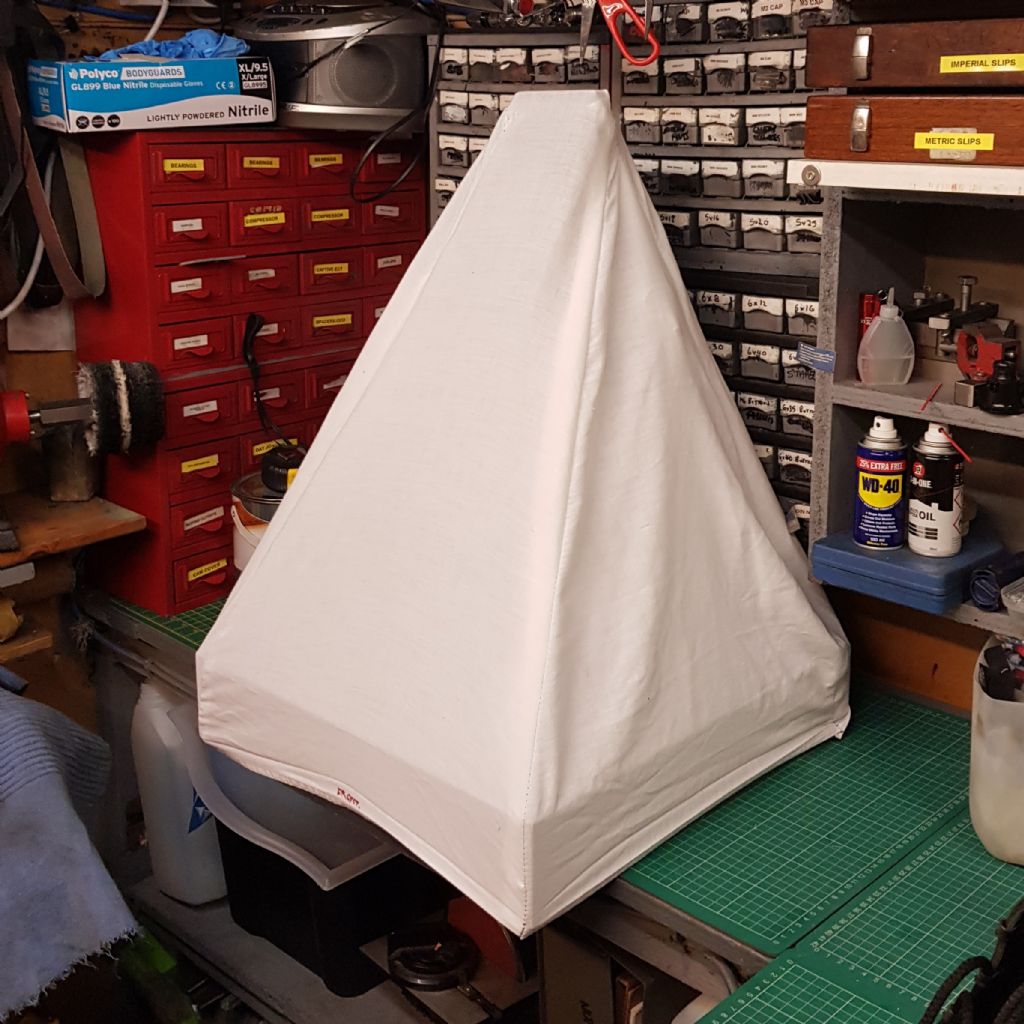

                                                I made a cotton cover to try and keep dust off it.
                                                It fits well over the "Trimos" height gauge.
                                                Mrs Jimmyb won't notice the spare bed is missing a sheet for ages laughembarrassed………………….
                                                Jim
