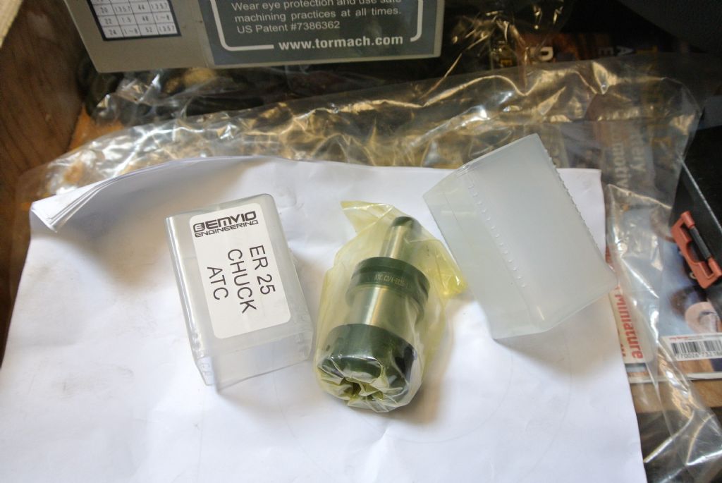

      The holders arrived today, They are extremely well finished and well packaged in plastic bags inside a hard plastic box with plenty of anti corrosion oil on them.
      The ER25 Collet Holder in it's packaging.

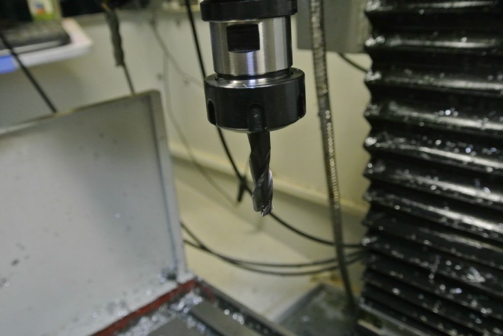

      The Holders arrived this morning so I thought I would give them a try in the mill. I needed to mill a bracket from 1 1/4" thick Aluminium alloy using a 10mm End Mill. The previous bracket I machined using the same cutter was ok but there was some chatter from the cutter but much to my surprise when I used the new ER25 Collet Holder there was absolutely no signs of chatter.
      I'm not sure why the chatter disappeared with this holder, maybe they get more dimensionally correct than the Tormach ones or maybe them being slightly larger and having more mass they dampen the tendency to chatter better, Either way I can say I am well pleased with my purchase. Another bonus is that I will be able to hold some of my larger end mills now.
      The ER32 Collet Holder with 10mm End mill in the Spindle of my mill.
