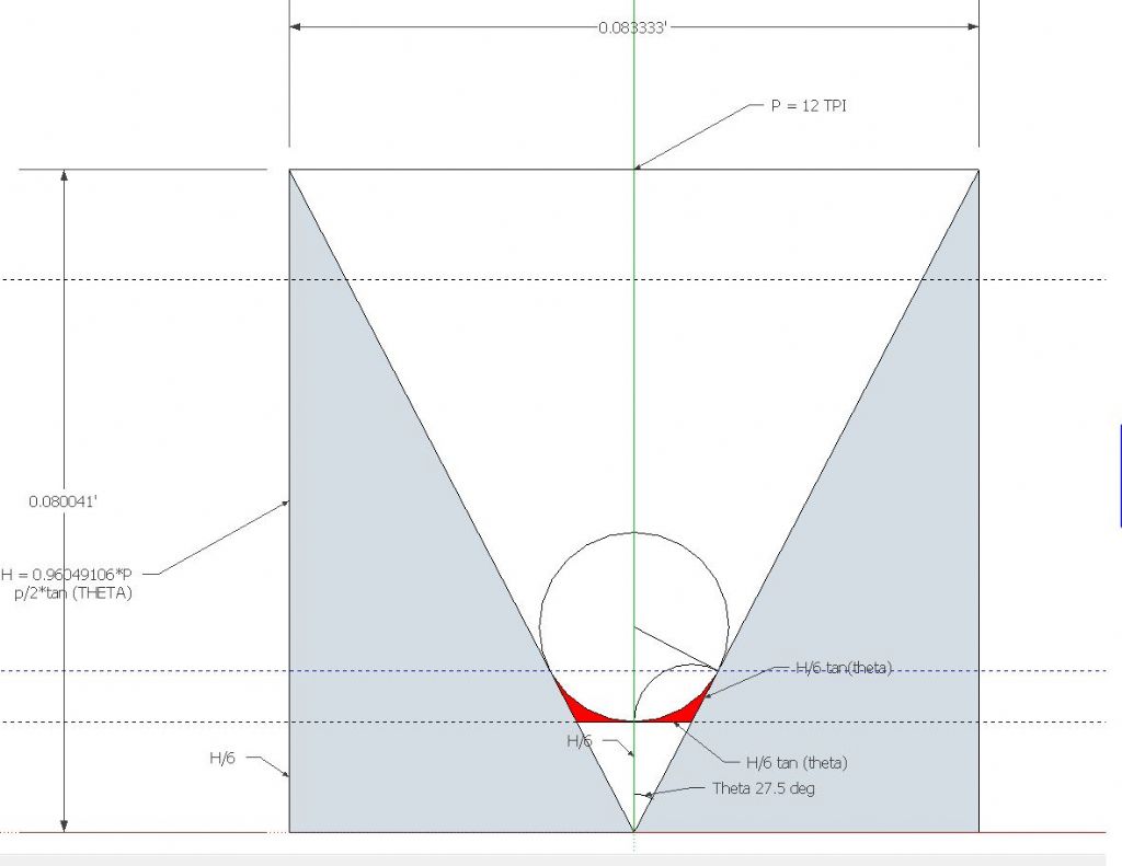

JW grew up through the early 1800s through the shop floors of Machinery Makers of the time and noted how there was no standard way of making nuts and bolts etc. So he set about amassing a collection from many of the factors around the Midlands area. He then deduced an average for Pitch (tpi) preferences and settled on an average angle of 55deg without further thought. He arrived at the form recognising that sharp points were impractical and made bolts weak
So armed with a compass and a set square here is what occurred
I hope the simple arc and set square construction is obvious and results in the well known radius crest/root
What looked simple on paper was difficult for production work and crests were flattened and tolerances loosened and so victorian engineers staggered on and this thread was eventually recognised by the Board of Trade as a de facto standard in the absence of anything better
Notice the red areas where there would be conflict with tightness when crests were not sufficiently rounded. A devil for internal point cut threads, requiring chasers to be made increasing production time and cost. The truncated form was established roughly for production.

Notice that when specifying the Pitch, all other dimensions are dependent on this number – the OD of the shaft has no influence.

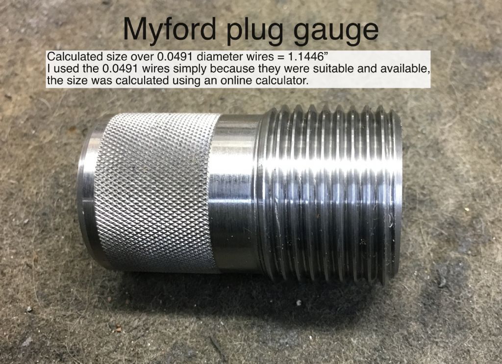

So now we know why Myford has such a quirky nose job
