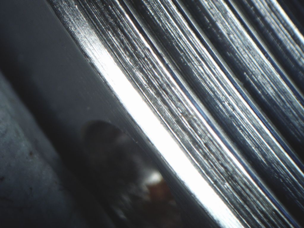

                                  #556533
                                    Posted by Howard Lewis on 30/07/2021 21:20:26:
                                    Sadly, Michael, no longer any Leitz lenses to check,
                                    So I rest my case, based on a lot of first hand practical experience.
                                    So, I remain the only one in the regiment in step, and after nearly 70 years interest in photograhy!
                                    Howard
                                    I am sorry to disillusion you, Howard, but:
                                    I removed the lens mount from a Leica and have photographed it for you this morning.
                                    Although the surface finish is rougher than I expected, the thread form is quite clearly intended to be Whitworth … and I have checked the pitch against a 1/4"BSF tap [which, at 26tpi, fits very nicely indeed].
                                    It was difficult to photograph, but I am sure you will agree this cannot be a Metric thread form:
                                    #556542
                                      Clearly it would be impractical to accurately measure the thread-form on the lens mount without sectioning it [!] … so I took a wax mould and sectioned that instead:
                                      Ref. https://en.wikipedia.org/wiki/File:Whitworth_Thread.svg
                                      Edited By Michael Gilligan on 31/07/2021 15:02:07
                                      #556555
                                      Howard Lewis
                                        @howardlewis46836
                                        Hi Michael,
                                        AMAZING!
                                        So hordes of people have been screwing 1 mm pitch 60 degree threads threads into 26 tpi whit form threads for all these years, or kidding us with what they claim to be making.
                                        Must be a lot of slack metric threads about in the camera world, probably due to the Russians and the Japanese, when they made their copies.
                                        Thank You
                                        Howard
                                        #556559
                                          You're welcome, Howard yes
                                          It’s been bugging me for a while, so I thought I really must settle it to my satisfaction.
                                          #556561
                                            Michael, do we know if your image is of an early L39 thread or a possibly M39 thread on a later item?
                                            Are you able to scale the image and measure distance between the current triangle and another?
                                            I suppose it's a bit like screwing new 1/4" UNC mounts into old 1/4" whit ones, they will go. I made 10 long spikes for a Gitzo tripod a couple of weeks ago, screw cut the 3/8" thread with a metric insert and chased it with a 3/8" whit die to finish, fitted the tripod fine.
                                            Edited By JasonB on 31/07/2021 18:09:18
                                            #556562
                                              Posted by JasonB on 31/07/2021 18:04:35:
                                              Jason,
                                              As stated, I removed the ring from a Leica body [actually a microscopy version, which has no rangefinder] … so, by definition, it’s obviously L39.
                                              I’m not really happy scaling the pitch from a photo of the wax … but [again as already stated] I checked the actual ring with a 26tpi tap, and it feels right. … The same tap does not nestle sweetly in an M42 thread.
                                              The matter under discussion was whether Leitz actually used 26tpi Whitworth form, and I’m convinced that I know the answer.
