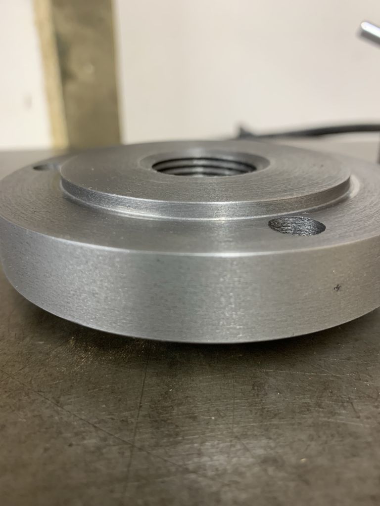

        The Chuck would only go on half a thread, anyway I have sorted it no thanks to RDG who appear to have washed their hands of the problem. After reading Howard’s post it got me thinking as to wether in my dads box of taps and dies I had the relevant tap, but the nearest was 3/4 x12 tpi. So I rolled the chuck on the bench with the tap seating on one edge of the thread and after 1 1/2 hours managed to get the chuck to screw fully on. I had oiled the thread and this clean oil kept turning black, so I presume the root of the thread was full of Iron powder and the tap must have cleaned it out. Thank you very much for all the replies, nowto go and put a dti on it and check for any run out.
        Thanks Richard
        #555208
        Howard Lewis
          @howardlewis46836
          Your 12 tpi Tap probably took a little off the crest of the thread so that it longer interfered with the root of the thread on the Mandrel.
          The main thing is that you have now managed to solve the problem.

                        Hi Richard,
                        Many years ago I had a similar problem with my then new ML 10. The actual register of the Grip-Tru chuck was too small, and that was down to Pratt & Burnerd, they were not cheap, even then.
                        As regards the supplier checking the thread against another machined part, then this is asking for trouble. Unless the "Inspection Parts" have been checked to see if the threads being used conform to the "Go" and "Not Go" sizes of a Screw Plug Gauge, then this approach is useless. Plus using the Myford spindle as a gauge is checking several conditions at once, and for one thing does nothing to actually check the true size of the Register diameter. The Register diameter on the Spindle, will always be smaller, it has to be to enter the hole. This hole could be 0.25mm or 0.010" oversize and the spindle will still go in. This size of Register would probably not do anything to help the concentricity though.
                        I suspect from what you have done with your 3/4" tap is restored the correct Crest Radius on the thread. No doubt the Tap, or screw-cutting insert used to produce this thread has become worn on this radius, and this is where the undersize condition actually was. This problem would have been found if a Pukka Screw Thread Gauge was used to check the part. As the "Go" gauge checks the form, pitch and size of the thread. The "Not Go" checks the maximum Effective diameter and looks like a severely Truncated thread, with the top half of the thread ground down to the Max effective diameter.
                        Lastly, you say you have put a clock on the Chuck. I have seen several posts where a clock has been put on the Body of the chuck. I for one would not expect this diameter to be "true", or "spot on". Nine times out of ten it has only been ground to make it look pretty. This is probably done on a centre-less grinder, and can be anywhere as regards concentricity, as its function is irrelevant to the working of the chuck
                        Gripping a ground diameter in the chuck jaws is the only safe test for concentricity, as this is where it matters. An old "Gudgeon" or "Wrist" Pin from an internal combustion engine is ideal for this, or a Hardened Dowel Pin.

                                    With regard to run out of the chuck in either plane, unless the thread is integral with the chuck body, this will be determined by the backplate.
                                    The OD should be a really snug fit in the register in the chuck. (ANY clearance will reduce concentricity. )
                                    The front face of the backplate should be skimmed to clean up, to ensure that is as square as possible to the lathe Mandrel axis.
                                    If we are still pursuing absolute accuracy reliance has to be placed on the jaws holding work absolutely parallel to the register in the chuck body.
                                    The threads will provide a location in the form of two long tapers being brought together..

                                              I tried a dti on the backplate and found about 1 thou runout but the needle was constantly moving due to a bad surface finish. I will try to skim it tomorrow. Hopefully this picture will show the surface.eb6b87cc-2a19-4044-a230-45ed90234507.jpeg
                                              #556086
                                              brian jones 11
                                                @brianjones11
                                                WOW the machining there shows a ripped finish (perhaps a Covid tool?). Hss should give a nice matt finish, no lube needed assuming grey CI 50 sfm

                                                      Have you checked the machining on the face plate?, I managed to get a better surface finish using a 12mm shank tool with what I think is a brazed tip. I tried a HSS but that left as bad a surface as original, that might be the operator at fault as I had attempted to grind it myself.
