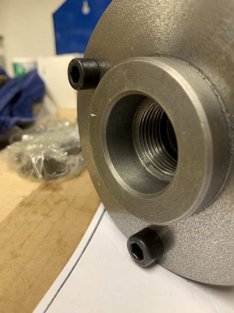

                Richard Jarvis
                  @richardjarvis95040
                  7560fbfb-f111-43ca-bbe9-ac026cd0f81b.jpegRight it says file for video too big, but I managed to do pictures, I have marked the start of thread with pen it starts at 12 o’clock position and my chuck is a full turn to form the thread whereas new chuck seems to have it formed just after half a turn. The way I have written that is not very clear hopefully you can decipher my poor explanation. I have managed to post the same picture twice but I can’t see how to delete the second copy.ac21575e-8dde-404e-a37d-05c7fbf059cb.jpegac21575e-8dde-404e-a37d-05c7fbf059cb.jpeg

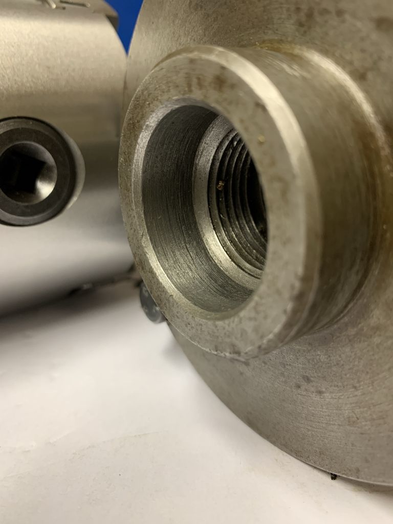

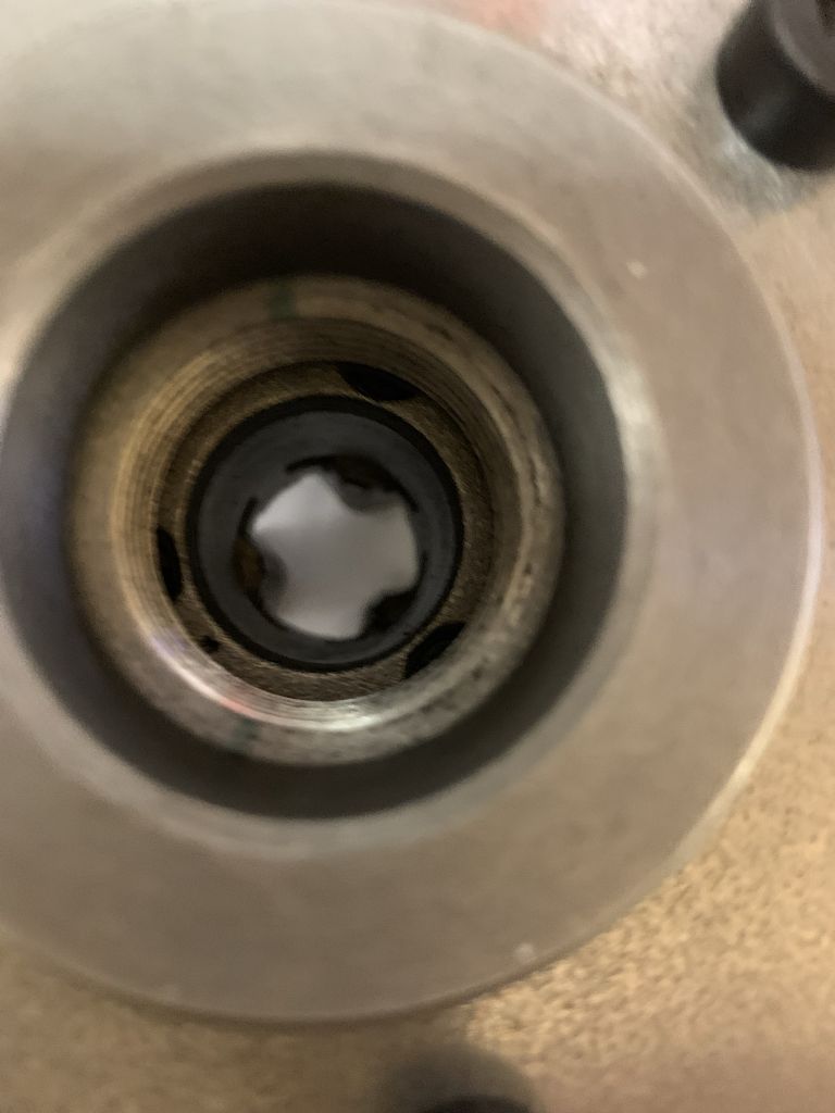

                    Richard Jarvis
                      @richardjarvis95040
                      e25aee9f-5063-4cbb-8f17-1bc0fdda111f.jpegThe Chuck on the left is the new one, the first thread is nearly square but on my old one on the right it seems to be formed correctly or does that not matter. I found a thread gauge and they both read at 12 tpi but I am sure the gauge hits the top of the threads on the new chuck but I think the gauge has a small gap between it and the top of the thread on the old one, I think the thread is not deep enough.Thanks Richard

                      #555076
                      Richard Jarvis
                        @richardjarvis95040
                        You will all be getting fed up with me now, only one picture downloaded, here goes this is the new Chuck.

                                          #555151
                                          Howard Lewis
                                            @howardlewis46836
                                            Maybe the thread needs to be truncated by a couple of thou, to prevent root / crest interference?

                                                #555173
                                                Mike Crossfield
                                                  @mikecrossfield92481
                                                  -Are you quite sure that the problem is with the thread? I agree that it is most likely the thread being tight, but I have seen situations where the problem was with the register on the backplate being a tinch (technical term) too small. In fact in the "old days" Myford used to supply chucks with registers which needed to be lightly scraped to suit individual spindles. Since it would be quick and easy to check by knocking up a gauge with exactly the same diameter as that of your spindle, why not try it, if only to rule this out as the problem?

                                                  Rod Renshaw
                                                    @rodrenshaw28584
                                                    Richard
                                                    Howard is absolutely right but it's possible to interpret his instructions as "The thread is a bit tight and if you can scrape it out a bit it will fit better"
                                                    The fit of the chuck, both alignment and concentricity, is determined by the register (The parallel part behind the thread ) and not by the thread itself. So the thread is only there to keep the register engaged and stop the chuck falling off.
                                                    So it does not matter much if the thread is a bit of a loose fit as it screws on, it will tignten up as the register engages.. So feel free to poke about and scrape about inside the backplate with whatever you have to see if you can remove a bit of metal and any burrs etc to enable the backplate to screw on. Try not to damage the register.
                                                    Failing that, return it to the supplier as not fit for purpose and see if that wakes them up.

                                                    #555179
                                                    Adrian Downes
                                                      @adriandownes83818
                                                      Before jumping in & modifying a brand new item in the hope that it might work it would make more sense to find the cause of the problem first!
                                                      I would suggest good old fashioned marking blue to highlight exactly where its binding.
