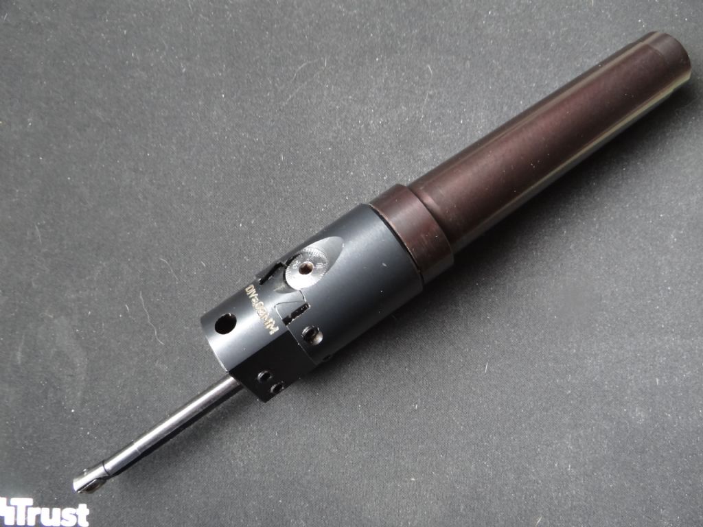

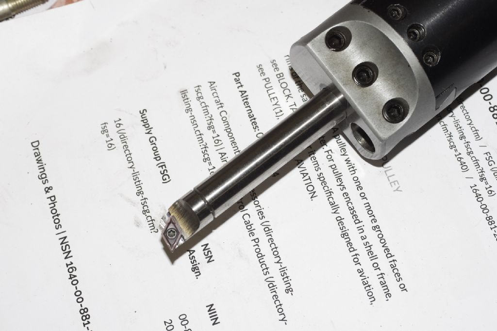

      Hi, I received the new Vertex Boring head with MT4.
      It measures 30mm wide by 65mm height, so I assume its called a 50mm boring head.
      It claims to bore out between 10 to 100mm wide hole.

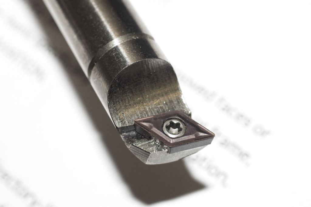

      Question about a very long Boring Bar indexable with insert received as standard with this head according to the main impoerter of Vertex in the country I live, more me it seems very long from my Lathe experience with boring bars and stick out which I can control with lathe but not here.
      The bar…..:It seems sturdy and heavy fo its size, feels good.
      -Bar=S12M – SDUCR07
      –Bar=It is 150mm long x 12mm
      –Bar=It sticks in 30mm into boring head, so a long stickout.
      InsertSmall)=The price represents good quality
      —Insert=DCM T070204
      What is your opinion/experience of this looking at above, before I test/do anything with it-?
      The saleman told me this is standard issue with boring head, they have no shorter boring bars to issue.
      Thankyou

        #654240
        Anonymous
          The salesman is a clueless idiot.
          A stickout of 120mm is far too much. A rule of thumb is 5 times the boring bar diameter, so 60mm in this case. My experience of using inserts, even with a high end industrial boring head, is that they are very prone to chatter. So much so that I have reverted to HSS toolbits; as in this setup:
          The home made boring bar is 7/8" diameter and stickout is about 6", so more than the rule of five times. I initially used an insert boring bar, but it chattered badly, so I quickly reverted to HSS.
          My 50mm Soba boring head came with several HSS boring bars, all about 75mm overall, so around 40mm stickout. After grinding they sort of worked but at least they didn't chatter.

            #654251
              I've not found the screws on my Soba boring head mark the shanks of Brazed tip, HSS or Indexable tools so have not bothered to add any flats. Would rather have the option to tweak their position in the boring head when needed.
              Looks like they just sent you a lathe boring tool, the ones for boring heads tend to be a bit different
              Boring heads tend to be sized by the diameter of the head so you might have a 30mm head or 60mm head depending what you call width and height. Neither of which is a standard Vertex size.
              Edited By JasonB on 29/07/2023 13:26:56

                                      #654397
                                      Martin Johnson 1
                                        @martinjohnson1
                                        I always seem to be the odd one out, but all my boring head bars now have flats filed in. I got fed up trying to set rake and clearance by eye and finding out it wouldn't cut due to rubbing on the heel. I also had the occasional fight with burrs on the tool shanks. No such problems now.
                                        Martin
                                        #654402
                                        Bazyle
                                          @bazyle
                                          The inappropriate head/bar combination is probably a reflection of the most popular sales to thousands of small far eastern factories wanting to minimise the boring head cost while getting the depth the design calls for. Persevere with the long bar and reduced quality and you can become a certified machine tool manufacturer. devil
                                          #654413
                                            Posted by Michael Gilligan on 30/07/2023 06:30:54:
                                            For hours of fun … try searching the Vertex online catalogue :
                                            **LINK**
                                            http://www.vertex-tw.com.tw/products/products_search_list.php?Keywords=boring
                                            Judging by the website, it's a miracle Vertex sell anything! So awful I wondered if it was a fake. For a time it seemed Vertex of Taiwan don't make Boring Heads at all. Persisting, they do. Looks like they're either sold as a boxed set, with arbour, accessories and 3 or 4 boring bars, or just as a boring head, where you have to buy an arbour and bars separately.
                                            My guess is Chris bought from a retailer who paired the head with an arbour and bunged in a lathe type boring bar as part of the deal.
                                            A long bar may not be complete madness because they can be mounted vertically to bore deep holes:
                                            And a long boring bar is an asset on a lathe because the end can stick out the back.
                                            I'd either chop it down or buy a shorter bar. Neither of my boring heads came with bars.

                                                    #654553
                                                    Chris Mate
                                                      @chrismate31303
                                                      Step-1 Testing the boring bar plus insert in the lathe, now it may not be right test(Not a boring head used), but just for experience.
                                                      -Huge fail-A: At 130mm stickout it is cutting horendoesly, its extremely noisy, it vibrates the chips landing on the bar, the cut looks like a corrigated road.
                                                      -Huge fail-B: Extended with 55mm stikck out, it still evenly horrendoed as above, I dont have a bar thats worse.
                                                      I compared it to an Iscar bar with insert, the Iscar bar cuts smooth and quietly, no problem.
                                                      Both set to centre height the same exactly, both inserts ticg in pockets no movement on insert.
                                                      So, I am a bit worried about this bar & insert on a lathe. The insert has all clearances.
                                                      I dont see it getting better making it shorter for the lathe.
                                                      Next step, speak to cmpany, and if its not suppose to work on a lathe, ok, I will cut it off to longest brazed insert bar and set it up in mill and go from there….
