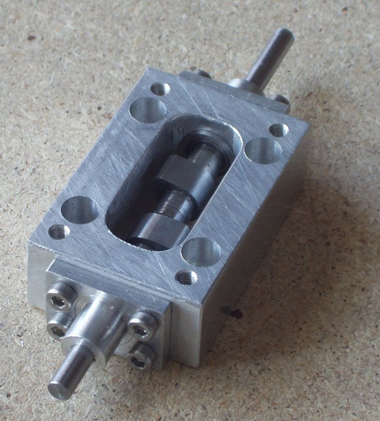

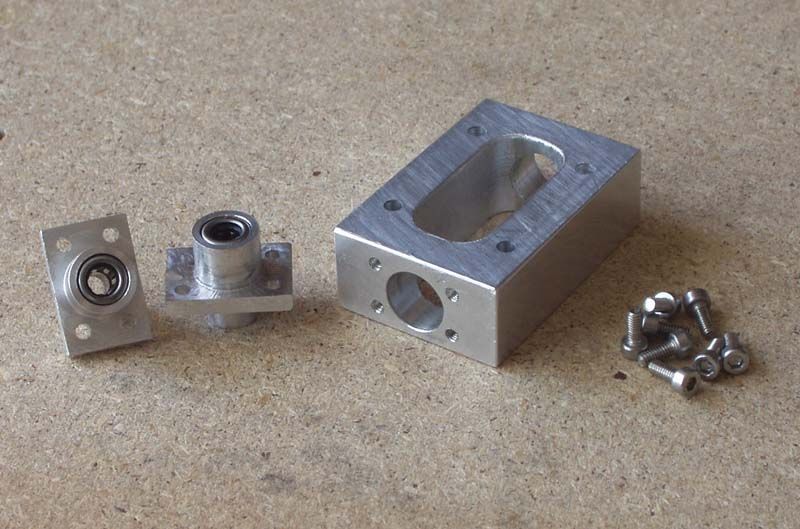

          Hi
          bit more done.
          piston rings made and fitted and con rod made and fitted with bearing.
          more soon.

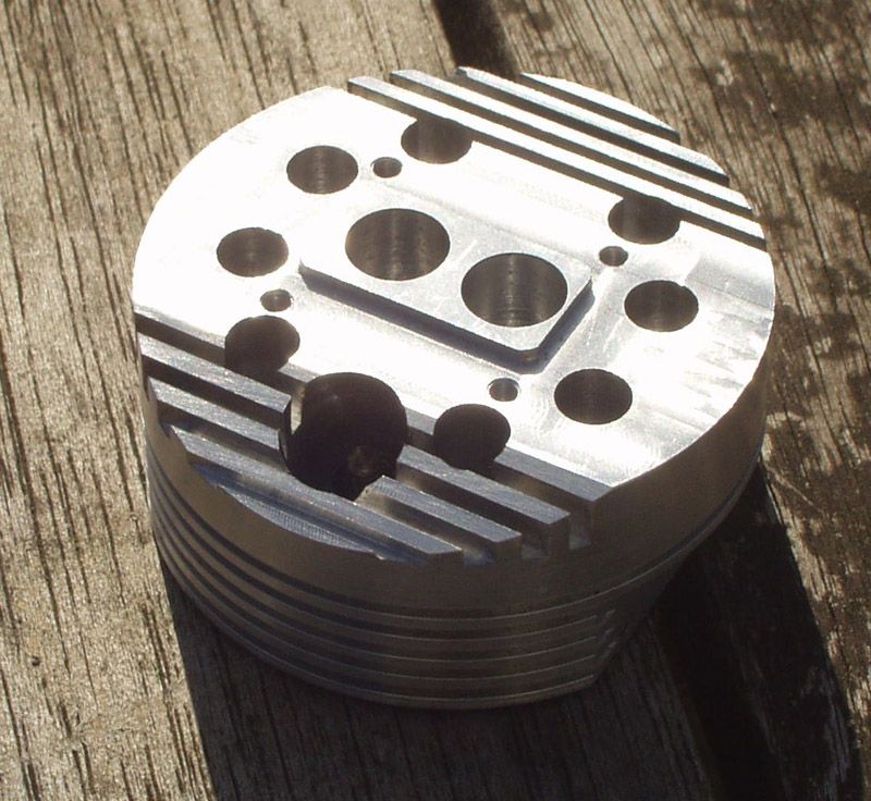

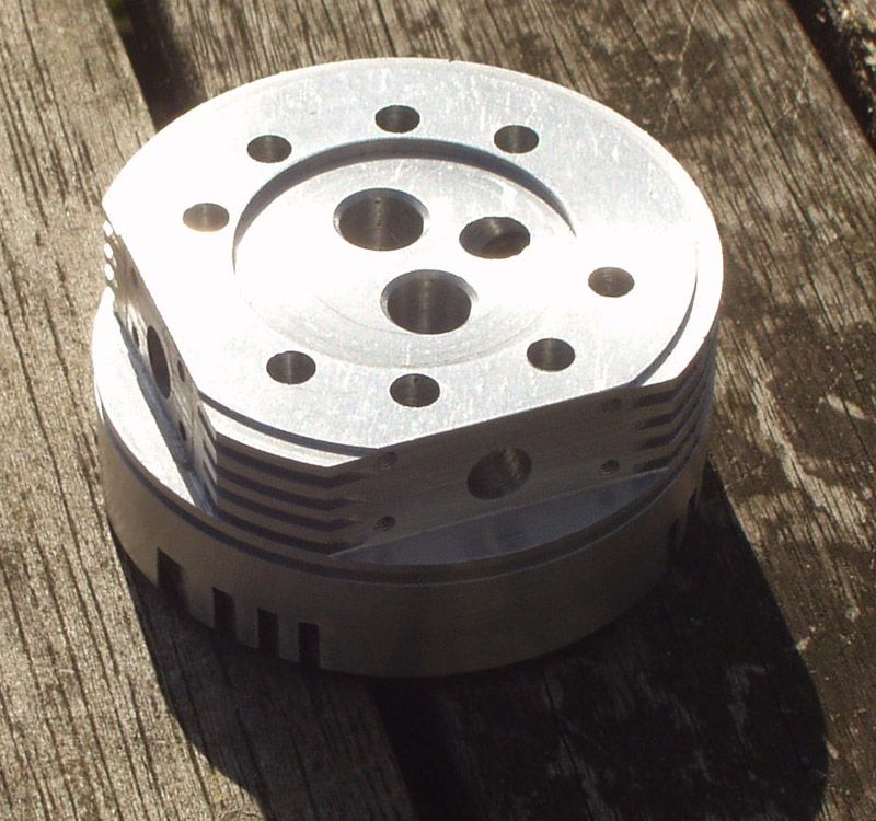

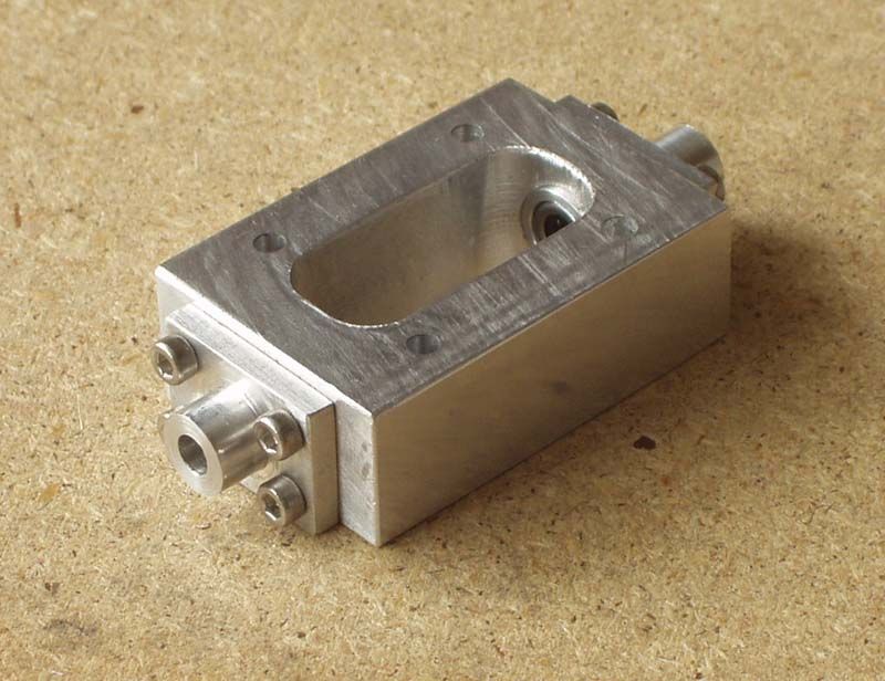

                        #75463
                        wheeltapper
                          @wheeltapper

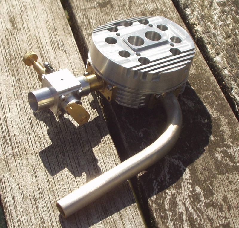

                          HI
                          are you still watching Steve, I’m not avoiding the head any more.
                          top
                          bottom
                          and finally
                          all dressed up
                          I just need some phosphor bronze for the valve guides.
                          when I recover from doing this I’ll have a go at the camshaft, cutting the cams should be fun, I’ll need a “do not disturb” sign.
                          Cheers
                          Roy

                              there are a few near oop’s’s .
                              for a start the inlet hole is 6mm instead of 7.5 because it was too close to a bolt hole,
                              I sweated a lot tapping the last 4 holes for the exhaust.
                              I had a go at the cams earlier, what a soul destroying job that was, my arm is killing me cranking the mill bed backwards and forwards 360 times.
                              stil, its all supposed to be fun……………………………………………………………….isn’t it?
                              cheers
                              Roy
                              #75513
                              wheeltapper
                                @wheeltapper
                                me again
                                a bit more done, cams cut and fitted.
                                watch this space
                                Roy

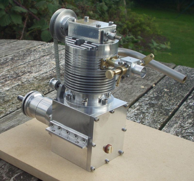

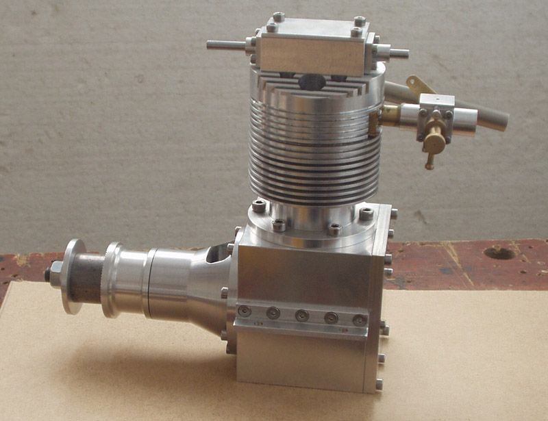

                                #75586
                                wheeltapper
                                  @wheeltapper
                                  Hi
                                  I thought I’d stick it all together temporarily to see what it looked like.
                                  behold the beast
                                  cheers
                                  Roy
                                  #75592
                                  Clive Hartland
                                    @clivehartland94829
                                    Now for a nice bit of anodising Roy, The head in Red and the cylinder in deep Blue and the crankcase Black.
                                    Very good work there Roy and you should be proud of what you have made.
                                    It should run well!
                                    Clive

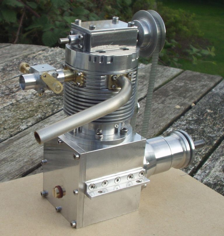

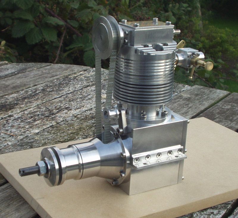

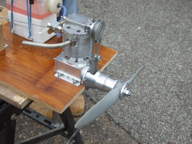

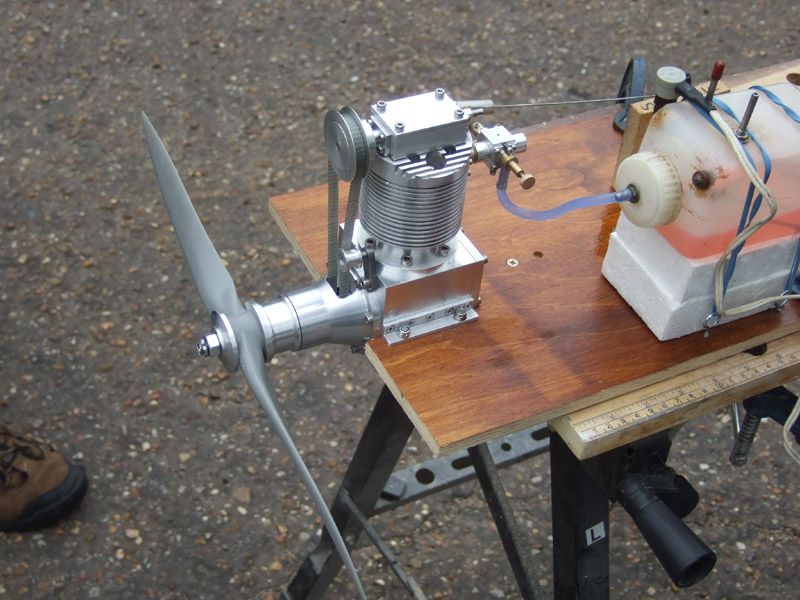

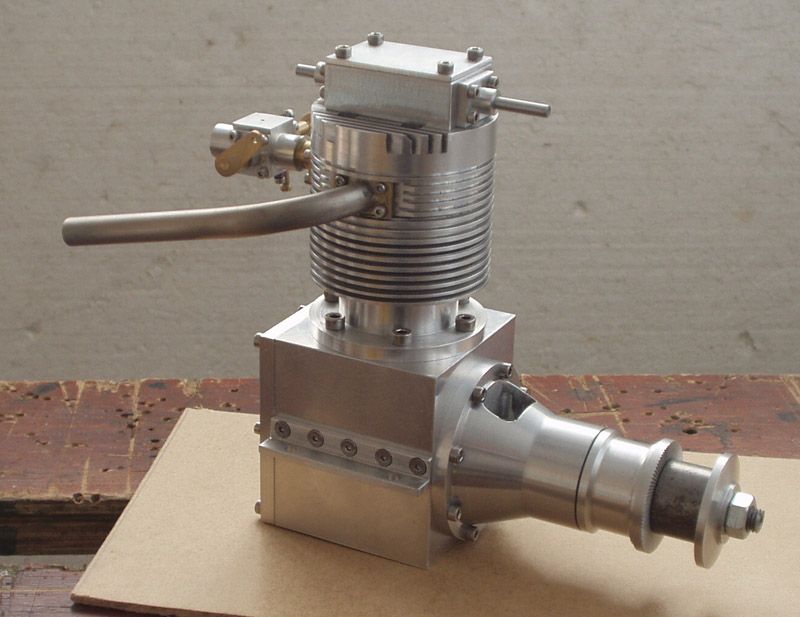

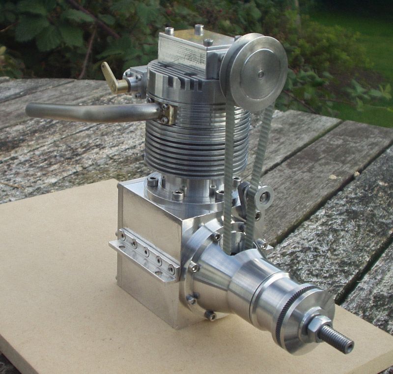

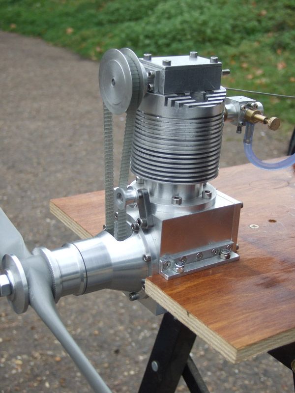

                                                #76291
                                                wheeltapper
                                                  @wheeltapper
                                                  Hi
                                                  I’VE FINISHED
                                                  and it runs
                                                  some pics of it ready to run,
                                                  here are some pics after I stripped, cleaned and polished it up a bit
                                                  I’ve got two videos of it running but I don’t know if they will work on here. they are on Photobucket at the moment but it looks like I can only use youtube here.
                                                  I have just started an account there and am uploading as I type this so I’ll see what happens.
                                                  watch this space.
                                                  Roy

                                                    #76312
                                                    Clive Hartland
                                                      @clivehartland94829
                                                      Roy, what an excellent piece of work you have done! If it looks good then it must be good!
                                                      Clive
