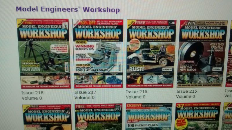

                            John Stevenson 1
                              @johnstevenson1
                              You must have an old computer Jason smiley
                              #156509

                                Clicking the magazines link on the green banner at the top of this page only goes to issue 217.
                                Perhaps I have an old computer as well!

                                  Posted by John Stevenson on 28/06/2014 17:18:35:
                                  What are those dotted lines at the bottom of the mag outline?wink 2

                                        Posted by Michael Horner on 28/06/2014 17:48:27:
                                        Looks like John cut along the wrong dotted line when he was cutting and Pasting, another bodge job that can't be hidden with a big bead of weldsmile p
                                        #156517
                                        John Stevenson 1
                                          @johnstevenson1
                                          Jason,
                                          No idea ? The lines are not there on the screen but appear when you do a screen grab ?
                                          Just taken this shot with my phone.
                                          No lines ?
                                          Probably the weld has had time to dry ?
                                          #156518
