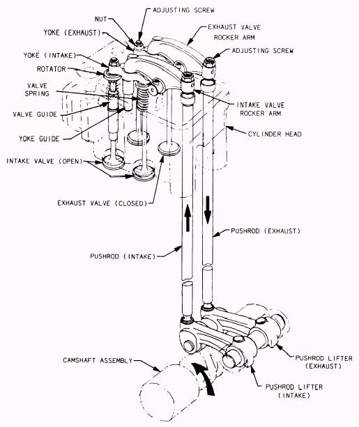

          Hi, thanks for the replies.
          Keith, a setup as shown in the model is not wholly unusual for a 24 valve engine with 12 push rods, typically it is employed for slower speed engines. An image shows this below:
          http://www.tpub.com/engine3/en3_files/image088.jpg
          From responses on other forums, the part appears to be a scavenge dry sump oil pump. I will be checking this over the coming week though to confirm. The alternator could be mounted on the same shaft, or be oil cooled, again, need to check.
