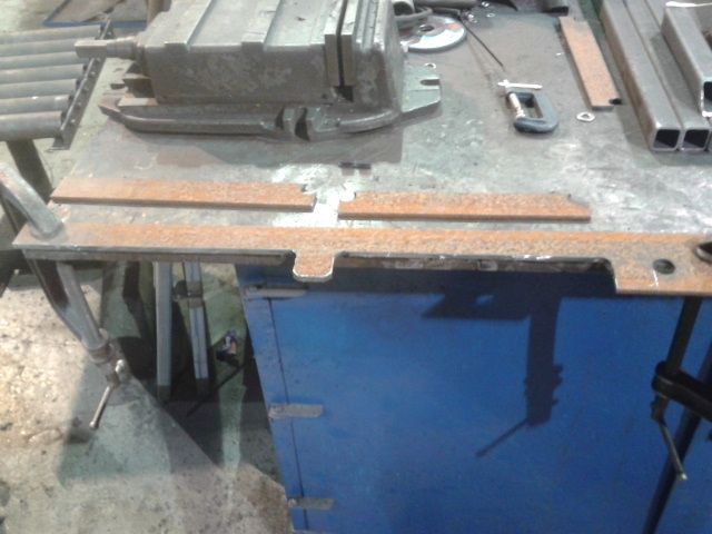

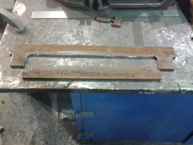

                                          Hi, I know these are not thin steel, they are 6mm and I had to cut about ten of each of these with a 4-1/2" angle grinder with thin discs, in my last job and of course I had to start the cut between the lugs with plunge cutting, nothing messy about them that I can see.
                                          Regards Nick.

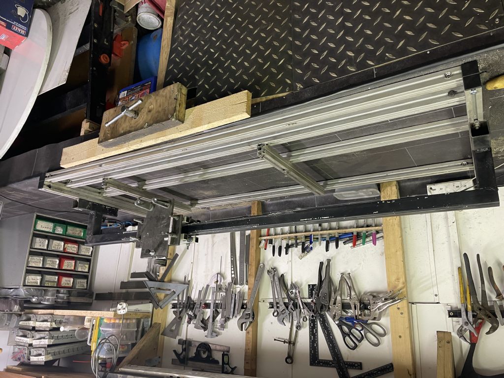

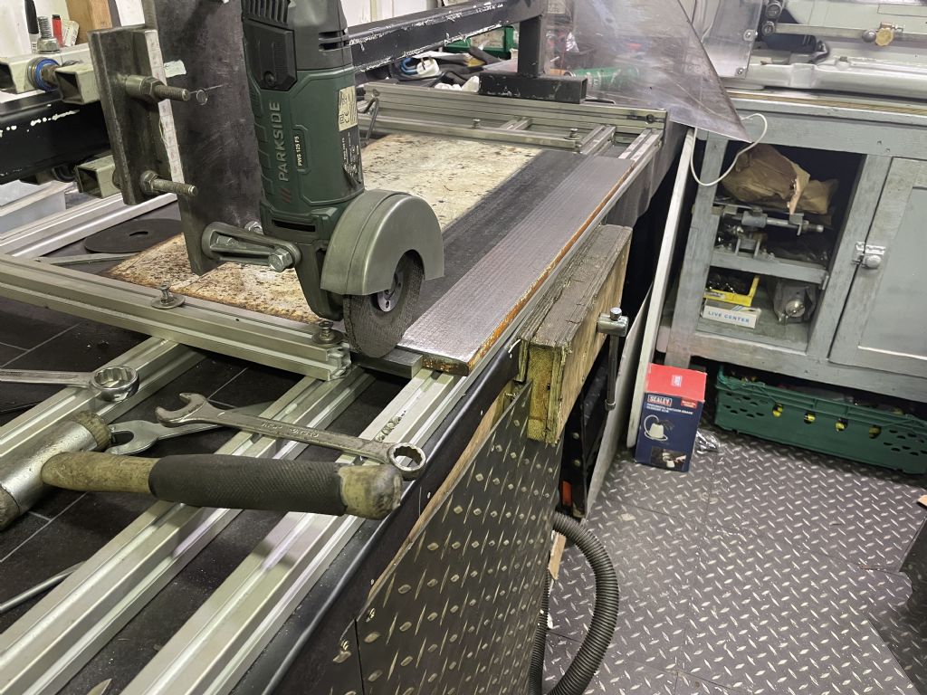

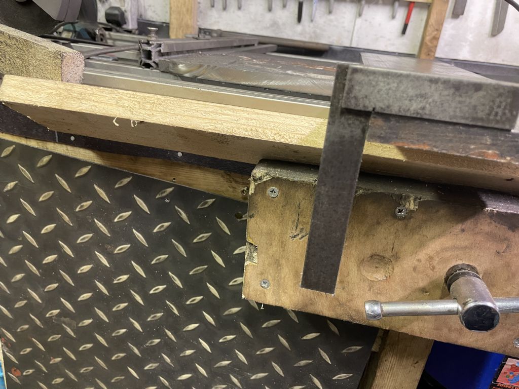

                                            I have built my own solution to this using some aluminium extrusion as the work platform and box steel for a gantry rail. I then made a base and adjustable slide for the angle grinder and other tools
                                            You could build a smaller version for not a lot of money. I normally purchase metal in bulk and in large sheets so I needed my saw to be a good size.
                                            I have a number of different saws but only angle grinders for long straight cuts . If you look on YouTube for angle grinder track saw that will give you a few was to make it , there is also a precision track saw that is incredibly accurate.
                                            My track saw will take up to 1.2m sheets which can be clamped down , however I am adding mag locks soon .
                                            I am making a fixture plate for my lathe and cut a 16mm thick sheet with good accuracy ,1mm x 125mm disc
