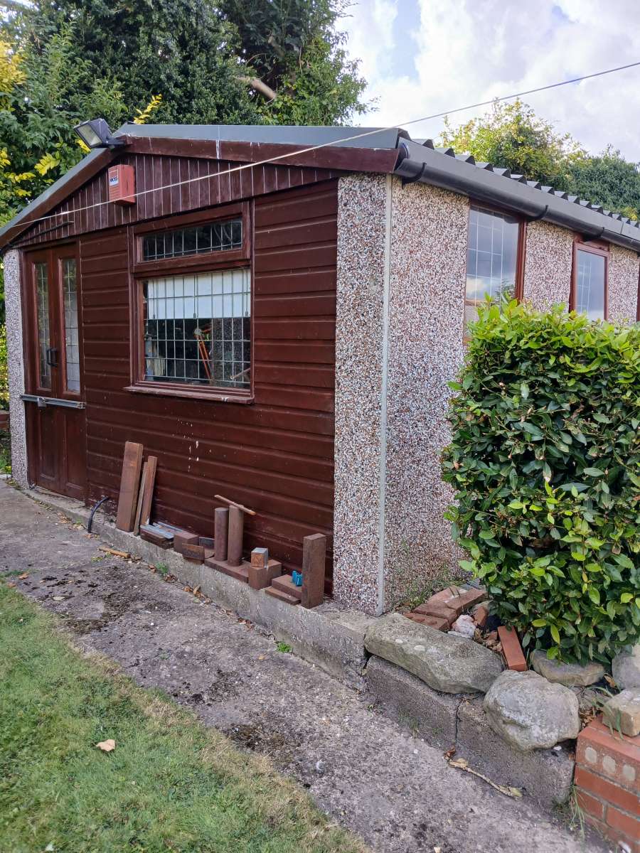

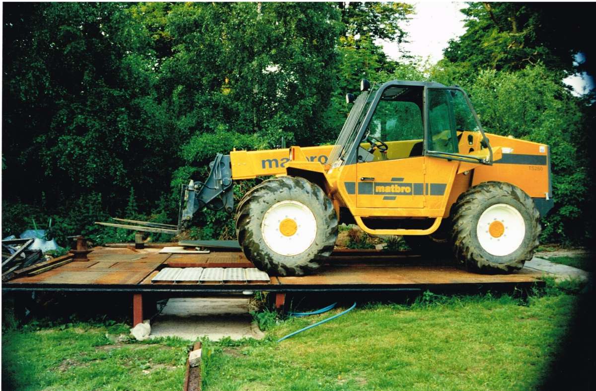

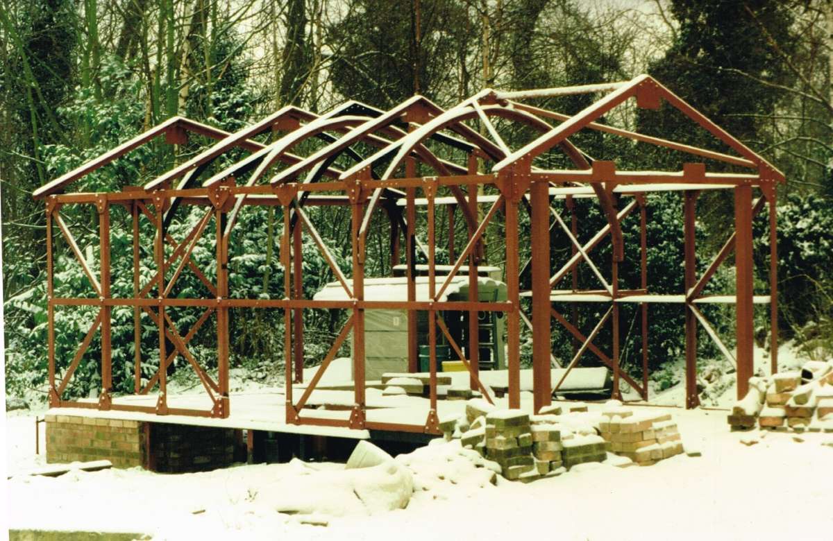

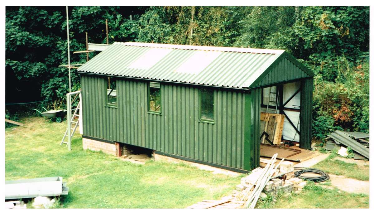

                                  Hi, my garage is 6.3 x3.2M approximately with an extra part on the right hand side when looking from the front, which is 3.6 x 1.2M, and the floor is made from a chequer plate loading ramp, which was condemned by the insurance company, for various amounts of corrosion in it’s supporting structure, so the floor is a left hand L shape, looking at it from the back end.
                                  Scan_20240809
                                  The framework was an old site mess room almost ready for the scrap man, but its roof was just made of the semi-circular sections with angle irons tying them together, but I wanted a pitch roof. The original roof was corrugated iron that was way past its best.
                                  Scan_20240809 (4)b
                                  This was all sheeted out, but 2 tonne single use bulk bags were cut, to get some large flat sheets, to sandwich between the frame and the outer steel sheets, which prevents condensation. But before the back end was sheeted in, my 2 x 2M machine shop was added to the back left hand corner, which can be seen in-part, under construction in the photo below.
                                  Scan_20240809 (2)
                                  However, I had no more of the ramp left for the floor, so a brick wall was built up, then mostly filled with dirt, rammed down and topped with hardcore, and a damp proof membrane, I then mixed up some concreate and and used some reinforcing mesh, to bring it up to the same level as the rest of the garage. Virtually all the materials were scrap and didn’t cost me a thing, sake for asking for it from my then employer, and the only things I had to buy were cement, a few nuts and bolts, some welding electrodes and some paint, but much of the electric wiring was also scrap armour cable. The sand and aggregate was overburden, which I had to wash the dirt out of and sieve out all the aggregate that was too large, which did take a while to do, but I was a good deal younger then, but the whole thing took 2 to 3 years to do after I got home from work.
                                  Regards Nick.
