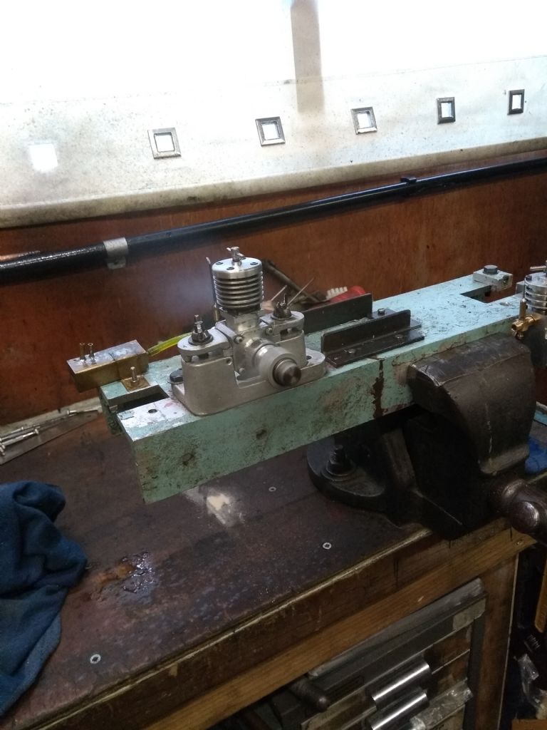

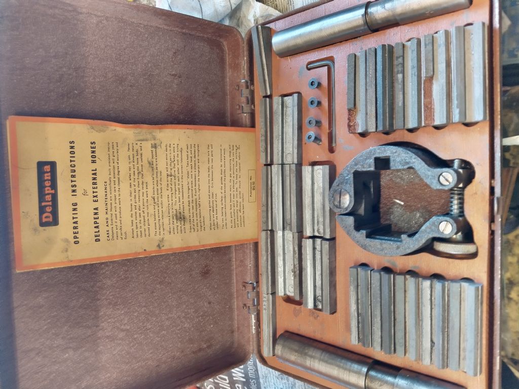

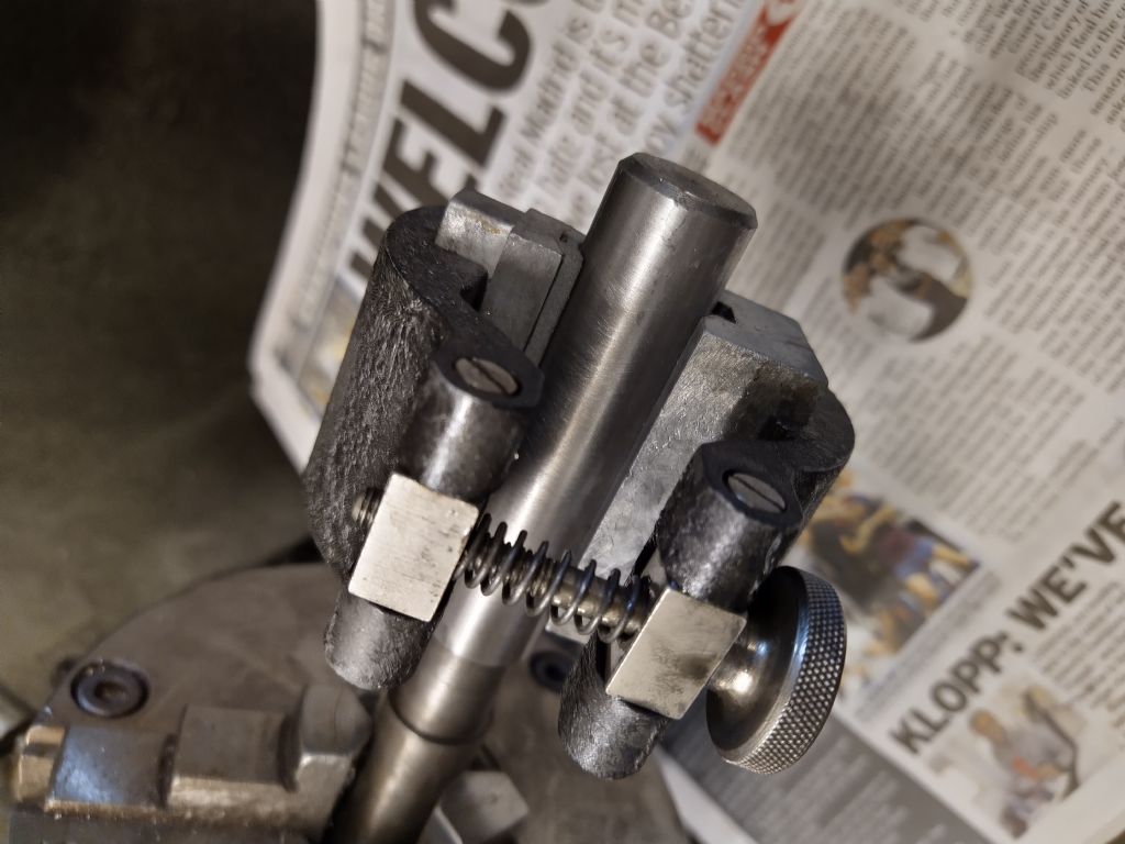

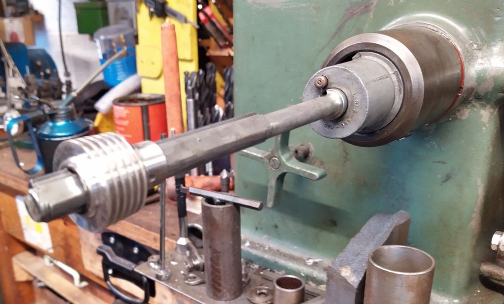

                                  I hone both cylinder and piston using Delapena equipment, one photo show a small cylinder being honed while the other two photos show the external honing equipment, one is with the hone on a truing mandrel. To fit a piston (and contra piston) I turn a length of suitable bar to ~0,002" then hone to size, I make the contra piston quite tight compared with the piston. I've "rebored" many more cylinders for others than I've finished cylinders for myself!
                                  Earlier on in this thread I commented the mounting of the crankshaft bearings being poor so I thought I would have a go at doing the job properly with the Nalon Viper, I've modified the "cooling system as well, the cylinder in the photo is for the Viper. Thats one of the engines I'm building, the other is another diesel of my own design, more or less, again with rolling element crankshaft bearing but with a different arrangement from what I have seen in many years.

                                    Hello John, was turned away from going the speedhone route as I was informed that it was impossible to get the required 'pinch' near TDC in the liner using one, do you not bother with trying to get that slight taper or is there a way of doing it using a Delapena type? I have something similar to your second photo, built from a kit supplied by a company near Long Eaton whose name eludes me but it doesn't go down small enough to do these small pistons. Up to now have made a circular hand held external hone to a design I found on the web for each piston which is time consuming, using an Alum split collet type would appear to be much quicker and so bought a mini lathe to do all the lapping on

                                      It looks like I may have the same bench mounted Delapena as you have John. Thing is I have never used it. I bought it off Polly Models at an exhibition quite some time ago. It was quite grotty with a damaged pulley and though near done I'm afraid it's still in a state of rebuild. I have managed to get some tooling for it but I have to say that because lapping has proved successful I've never really been motivated enough to finish it. Like wise the external hones. I was lucky enough to get two brand new sets off Ebay and though have used them still prefer to lap pistons with a home made lap
                                      As you can see these are quickly made and do work very efficiently.
                                      Achieving a tapered bore as Graham asks is quite easily achieved by lapping simply by dwelling at the bottom end of the liner – is this possible when honing on such a hone?

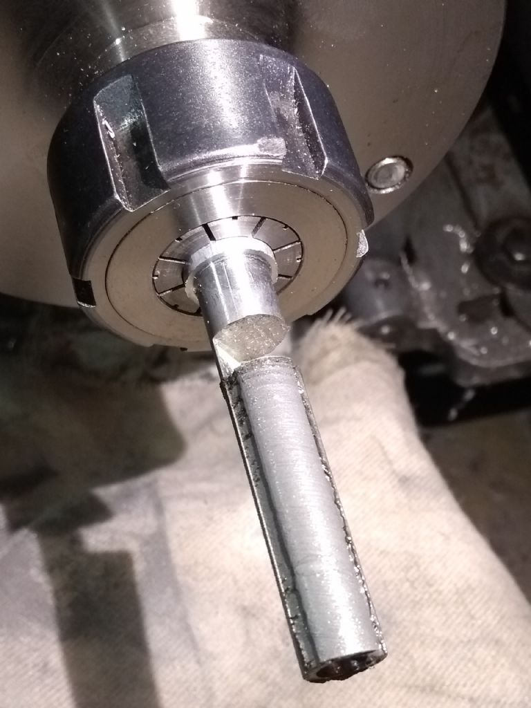

                                        This is the cylinder lap that I used as recommended by John A, Piston lap is similar to that I used Tug but will try John's suggested method with an AM25 piston this time around. Needle valve jet hole was to deep, almost 0.090 past cross holes so will make another one tomorrow.. Wish my drgs looked that good Tug, foolscap and sometimes a ruler is the best I can do LoL
                                        Cheers
                                        Graham W

                                          Graham, never bothered with a tapered bore, I've always taken great care to get the bore (and piston) parallel in these small sizes. I think that the amount of taper required in these small cylinders with piston and cylinder made from the same (or very similar) metal is so small that it would be difficult to measure and I don't like the idea of guessing! I've always tried to arrange effective cooling of the cylinder to try and keep it parallel and round. Screwed on or "slip fit" fins doesn't do that.
