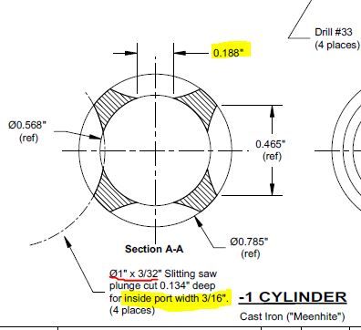

                                  Graham – I don't know if you have cut the exhausts ports on your liner yet but I have just noticed that the section drawing quotes to use a 3/16 sltting saw to do so. I'm certain this is a typo and should read 3/32 – the porting as drawn is such. 3/16 is far too wide even if the top edge is set correct.
                                  Hope you've found this already but if not hope this is not too late
                                  Tug
                                  Just looked at your images – looks like you have. Providing the top edge is in the right place it won't affect the timing but if I'm right will give a massive amount of sub piston induction – you may be able to lengthen the piston skirt some to alleviate this.
                                  I'm just drawing out the liner for mine and spotted this – sorry to bring discord to your build!

                                  #444275
                                    Ramon, the drawing I have says use a 3/32" x 1" dia saw and cut until the slot is 3/16" wide on the inside of the liner so all may not be lost.
                                    Though the top heights for the one piece and two piece cylinders are different by 23thou as well as the one piece having a smaller height to the slot?

                                    Graham Williams 11
                                      @grahamwilliams11
                                      Tug, both liners have the ports cut, my drg, as Jason's, shows to use a 1" x3/32" slitting saw plunged to 0.134" deep. Managed to find the right size saw at Castle Hardware? in Sheffield, last one they had and made both liners using that, hope the drg is right or it'll mean starting over.
                                      Cheers
                                      Graham W

                                      Ramon Wilson
                                        @ramonwilson3
                                        Ah that's great guys – no problems then Graham – my drawing definitely states use 1" x 3/16 thick slitting saw but shows .0935 port width.
                                        These were the early drawings from the site as soon as they were posted – I guess Ron updated them
                                        Whatever – glad you don't have any problems.
                                        I haven't checked the second one piece cylinder Jason – that would give a differing timing all other things being equal at the case – possibly the thinking behind it.
                                        Tug
