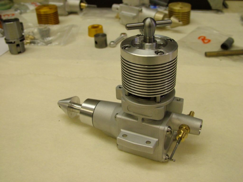

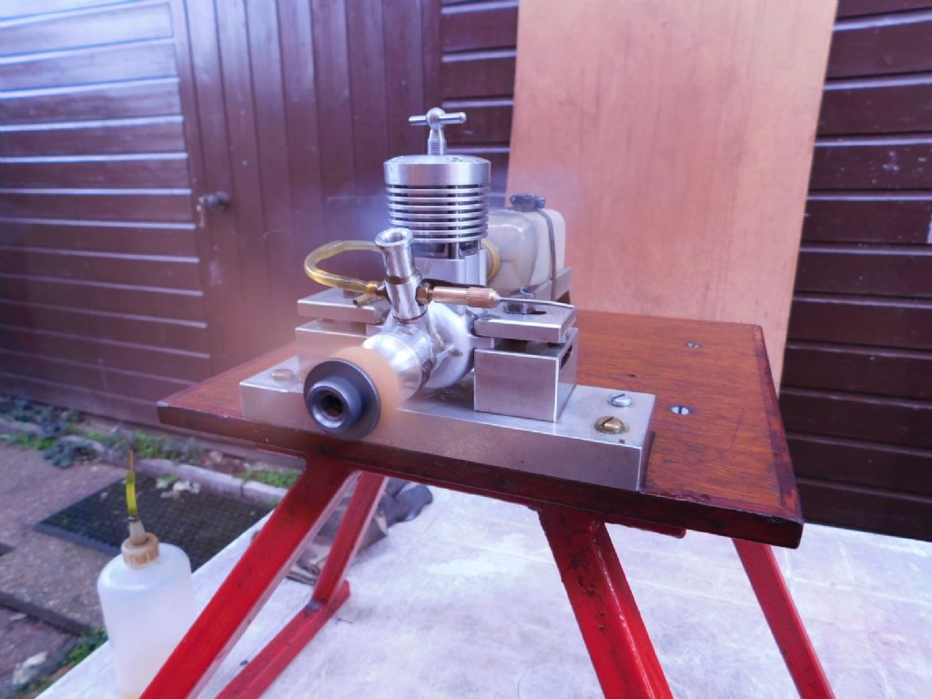

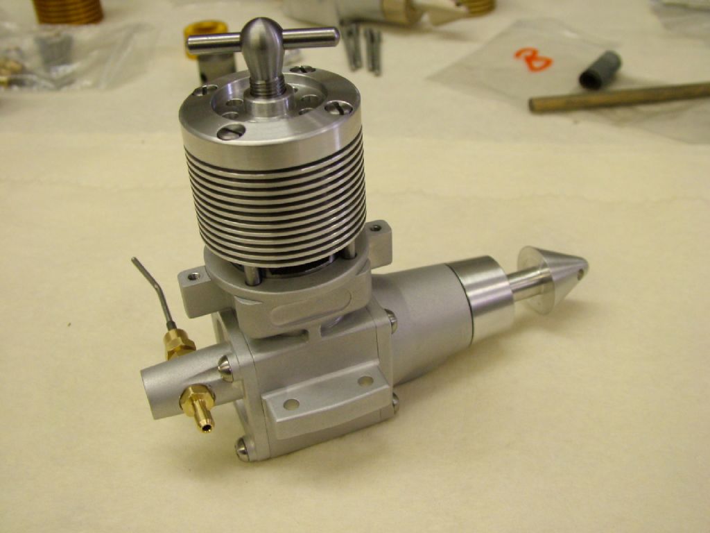

      Ramon, they are not sowing on MEM either as I looked earlier and would have pasted an image from there.
      #442398
      Ramon Wilson
        @ramonwilson3
        Well that is something really special Emgee but I'm sure you would consider that it's far from the average home model engine builders scope surprise Ceramic balls running in a ground shaft and steel housing is not going to be carried out on the average Myford I guess. Awesome looking product though what kind of rpm and power output are these engines producing ?
        I well remember the original article in Aeromodeller by the Meketmeyer brothers but that was long before I took any interest in making engines myself.
        Looks like Jason is right, things have moved on but I still think that what I do and what Graham and any others with similar interest in making a small diesel require is far more basic. As I read it the inference of John MCs initial post was to suggest such is required for the kind of engines like the Nalon Viper. I find myself at odds with that view – I simply can't see the need.
        In answer to Grahams question about kit all my engines have been made on a Super 7 and an old Linley mill. All bores are lapped not ground which has proved immensely successful – for what I want of it – but the engines you show there are a completely different level and world away from anywhere I have been or indeed from the Nalon Viper that began this interesting foray into modern engine techniques.
        Thanks for sharing the pics and info though – the engineering is indeed very impressivethumbs up

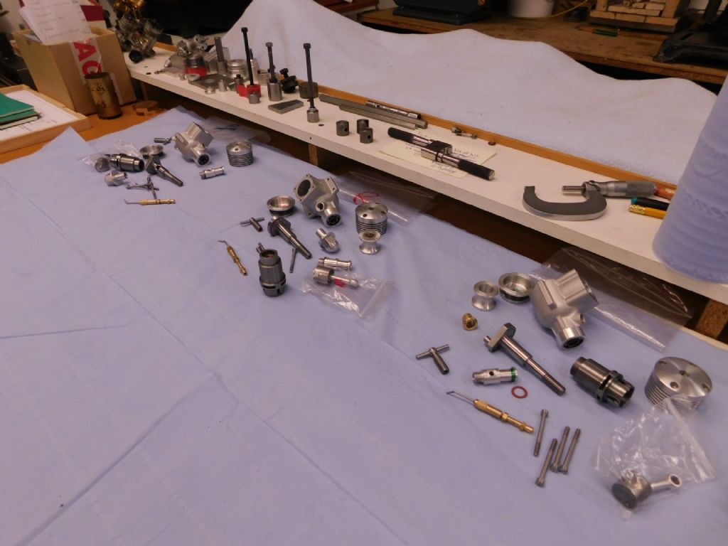

                      Jason – I have finally managed to make all my (relevant) image files as 'shared'. I contacted a friend but his PC was still not showing images on the Oliver thread on MEM. Since then I have rebooted my PC in the hope that might help. If they still cannot be seen then I really do not know what to do next.
                      I have uploaded some images of the Olivers to my album on here ….
                      These are my latest engines, all machined from solid with cast iron pistons in En1a liners
                      These are identical – the image distorts their height
                      It's been refreshing to discuss these small engines and their manufacture something not too often seen on here these days.
                      Regards – Tug

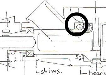

                        Some interesting comments but nothing that explains why the correct method for mounting rolling element bearings should be ignored. It doesn't matter if its an engine suitable for a first time builder or the latest very high performance engine, why not do the job properly? In most cases the design will need a little updating, why not to make a better job?
                        The principles have been known for many years, certainly since the Viper was designed.
                        Reading through the FMV engine history, those guys seem to understand the problem of different expansion rates. Not sure their solutions are good, clearly they have not heard of C3, C4 clearances.
                        As for my sketch, thats is what it is, a NTS sketch to show the principle, doesn't matter if there is a flywheel or propeller, principle is the same. As for which bearing (in this application) should be fully constrained, I think it best the bearing nearest the load (prop or flywheel), will be running cooler therefor less likely to want to move. I have suggested a circlip there are other ways of clamping the bearing
                        As for the radial fit of the bearing in its housing, I'm surprised at the somewhat casual approach to it. Again, for a successful installation its important to get these fits correct. Small diameter bearings require some very tight tolerances, always tempting to add a bit more, just in case!
                        Also please note that these well founded principles apply to where ever rolling element bearings are used.
                        My final (possibly!) word on the subject is, if at all possible, in some way acquire a copy of the SKF general catalogue (other makes are available), its all in there.

                            Hello John,
                            As you appear to be insisiting that this method is the only way I can't help but wonder why it is that in all the engines I have ever seen dismantled, either in my hand or in literally hundreds of engine reviews over the years I have never seen any form of spacing between bearings other than the shaft itself. By implication you seem to suggest it should.
                            From a practical point of view it just introduces another part, not only unnecessary but something that would require to be perfectly concentic in order to run with the case bore itself.
                            In my humble opinion, and, in the face of so many that have spent so much time in developing the power of these small engines I assure you it is humble, none have done more than those involved in racing or speed in all genres but for me specifically, control line flying. To dismiss the Meketmeyer brothers in such a fashion and indeed those that followed on sets yourself high upon the bar. Their ideas and articles sharing those views were groundbreaking at the time as was that of Stockton and Jehlik, T/R world champions whose radical ideas using an ETA15d as a basis lead on to Paul Bugl's incredible engines all from which the modern F2c engine developed.
                            Your initial posting and subsequent insistance that this is the 'correct' and by implication the only way leads me to wonder why so many commercial engine manufacturers – certainly in the pursuit of more powerful engines than their competitors – have never adopted this method over the years on what must have been thousands of differing designs – sorry I simply can't see it. I don't disagree with your recomendation per se – just in this specific application.
                            Yes, I may not have an academic background, indeed I was once accused on here of having a, quote 'Monkey see, Monkey do' unquote kind of approach. Well so be it, it has proved to be a viable attribute for me so far. 'Yer pays yer money yer takes yer choice' I guess but I've always been keen to learn from others just always tried to make my own mind up as I see fit about the advice being given. I'm afraid this is one of those occasions I don't share the same view.
                            Yes, I do have the SKF catalogue along with the RHP one but neither has any info on these small I/C engines (that's TIC by the way) however, to the best of my ability, I do try to fit them with as good a radial fit as recommended in them- heres another example, my favourite of those made so far – another scaled to 5cc, this time the 2.5 cc ETA Elite Mk11
                            On that note I'm afraid we shall have to agree to differ – I will continue as before even if it is 'wrong' – others of course will have to make their own mind up.

                                      A few points. Wide clearance bearings are readily available in most sizes at only a very small price premium. Its not always possible to do things properly "on the cheap", sometimes spending a bit more money must be done. The exception seems to be C5, hens teeth comes to mind.
                                      The "FMV" article, I've read that again, while they are well aware of the problem, the solutions offered leave a lot to be desired. That was nearly 45 years ago, surely things have moved on since?
                                      JasonB, yes a spacer on the crank would cause a problem as you describe, not insurmountable though. The great thing about forums, in general, is that a solution can be found if only people can get out of the "not designed here" frame of mind.

                                                      I've just read through the service sheet for the MB engine. Like the idea of incorporating one of the inner races in to the crankshaft, a simple solution to the vexing problem of clamping one of the inner races to the shaft.
                                                      Why, I wonder, is there any need to use shims to control end float of the shaft? In the area I have circled in the (copied) sketch, if there is a small amount clearance between the case and the bearing the need to him would be eliminated. As a bonus the tolerances on the various linear dimensions associated with the components could be eased somewhat.
                                                      As Emgee has pointed out the heat required to disassemble the engine suggest the bearing won't move in use. What will happen is that the bearing will be able to find its own position during running, therefore not imposing any axial load on its self. The other bearing is doing all the axial location, just as it should be.
