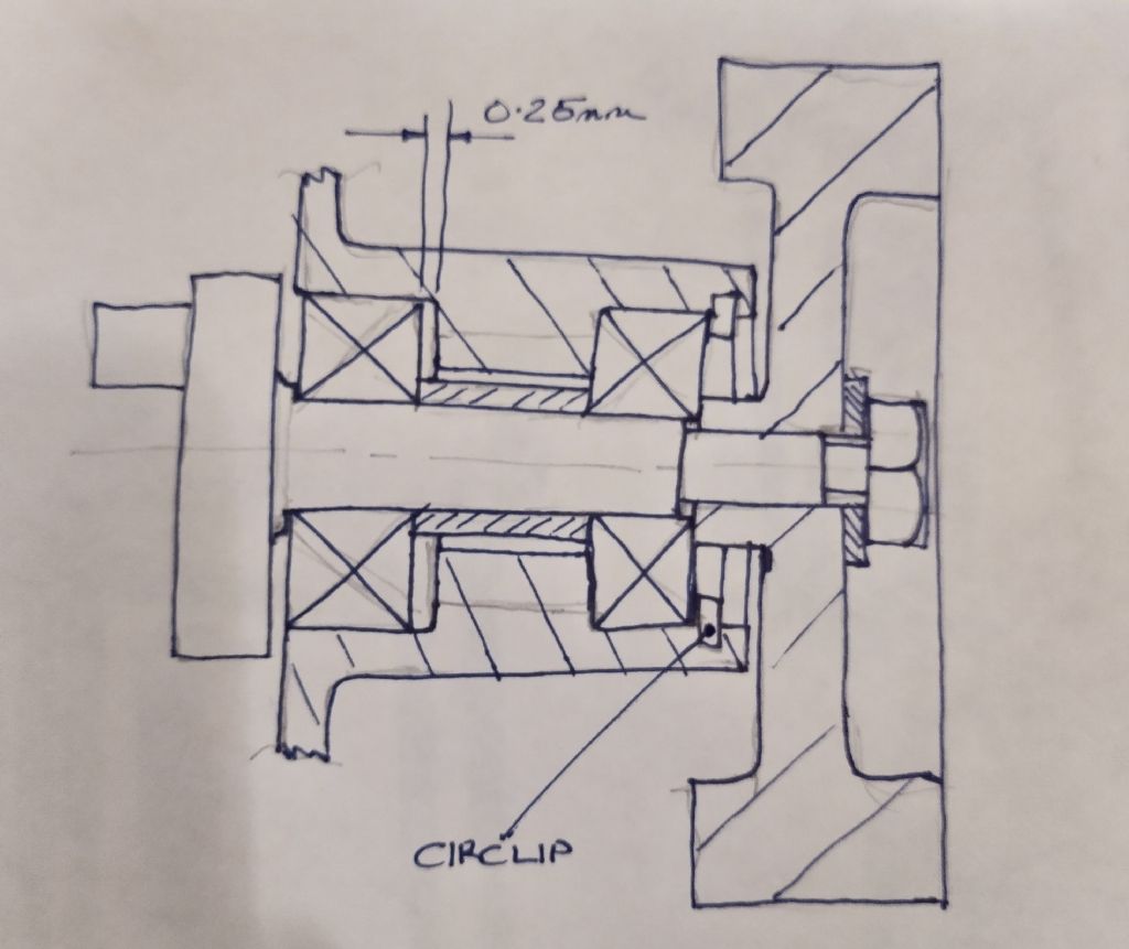

                        John MC
                          @johnmc39344
                          I've attached a sketch of how the bearings should be mounted. This is for a rotating shaft, stationary housing. The bearings are clamped to the shaft by the nut on the end of the shaft. the order being nut, washer, flywheel (or prop driver), brg. inner race, spacer, brg. inner race and crankshaft. Note the crank shaft reduces in diameter before the end of the brg. inner race.
                          Hopefully it will be self evident from the sketch that there is clearance for one of the outer races to move axially, the fit in the housing would be a transition fit. The other bearing is the locating bearing. The outer race is against an abutment formed in the housing and held in position with a circlip. I've suggested a circlip but there are other ways.
                          Always best to use the bearing manufacturers recommendations for fits.
                          This arrangement will stop axial loading caused by differential expansion of the various components. Also will greatly reduce the accuracy requirements for the various axial lengths.
                          Look at any well designed assembly (ball bearings/rotating shaft) and this is how it will be done. If the housing rotated then the mounting would be a little different.
                          Over constraint of the bearings, as the are with the Nalon Viper, is a common reason for bearing failure, often mistaken for other problems.
                          The whole business of rolling element bearing mounting is drummed in to students of mechanical engineering, some still get it wrong or choose to ignore these basic principles with the inevitable consequences…..
                          #442258
                          john feeney
                            @johnfeeney58965
                            Hi John MC
                            That`s pretty well how all high performance engines are made although the circlip is often replaced by a threaded locking ring.
                            John Feeney
                            #442261
                            Old School
                              @oldschool
                              It's one way of doing it but not would not be my choice. Just make the crankshaft 10 thou longer and then you can clamp up the rear part of the crank against the centre of the front bearing .The the expansion of the front housing is taken up by the crankshaft moving in rear bearing. The front bearing can be held in with a circlip but I have found it uneccesary, I have clamped the front bearing in one engine I modified but used a clamp ring ring with a left hand thread so if the bearing did rotate it tightened up the ring.
                              The easiest solution is to make the front housing out of steel as is current practice in modern tether car engines press fit bearings C3 or 4 tolerance and the expansion problems almost disappear.
                              #442262
                              Ramon Wilson
                                @ramonwilson3
                                Thanks for your contribution John – your set up is exactly as I described before only reversed. The float of one of the bearings is usually at the front end
                                I have to say that I have never seen this set up as you have drawn in any small single cylinder engine I have been involved with over many years and never ever have I seen a front (or rear) bearing in one held in with a circlip.
                                Whilst I accept it is just a sketch it also implies there is a considerable gap between what appears to be a bearing 'spacer' and the crankcase bore. Again I have never seen any engine fitted with such a spacer only the crankshaft acting as 'one piece' This gap (and there should be one for lubrication) should only be in the order of a thou or so otherwise crankcase compression will be lost. This may be okay for spindles etc but it certainly isn't the norm for small IC engines that I have had experience of.
                                Like all matters there is always several ways to skin a cat but for the type of engines being discussed here this isn't one I would consider as neccessary.
                                The above not intended to be dismissive of your input which is well meant I'm sure but I don't think this is the right advice for anyone attempting to make one of these small engines
                                Regards – Tug

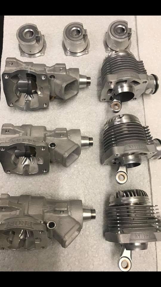

                                                    Emgee
                                                      @emgee
                                                      Ramon
                                                      The current top performing pylon racing engine used in the FAI Class F3D 6.5cc 2 stroke glow ignition powered models is from MBProfi in Holland, the earlier articles describe his engine development for c/l team race engines.
                                                      The crankshaft on these engines is supported at the front by a ceramic ballrace and secured by a locking ring, the bearing is shimmed to achieve the required shaft endfloat.
                                                      The rear is supported by ceramic balls running in a groove ground into the shaft and an outer race, the cage is a phenolic material.
                                                      The builder is currently experimenting with fit of the rear race and has found less problems are encountered if there is good clearance within the bearing arrangement.
                                                      Rob is still making team race engines from solid and competing in most European control line contests, he also flies in F3D class using his own engines.
                                                      Emgee
                                                      Dismantled engines to give some idea of design,
