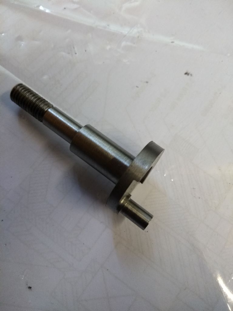

                #435188
                Graham Williams 11
                  @grahamwilliams11
                  Finish turning the crankshaft up today then rear housing next, doing the less difficult bits first.
                  Edited By Graham Williams 11 on 29/10/2019 18:44:00

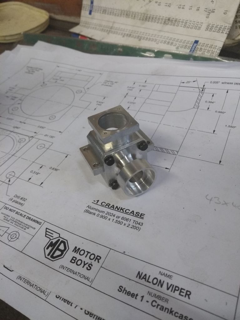

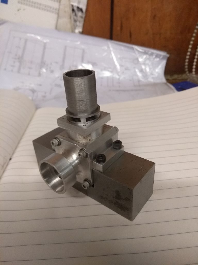

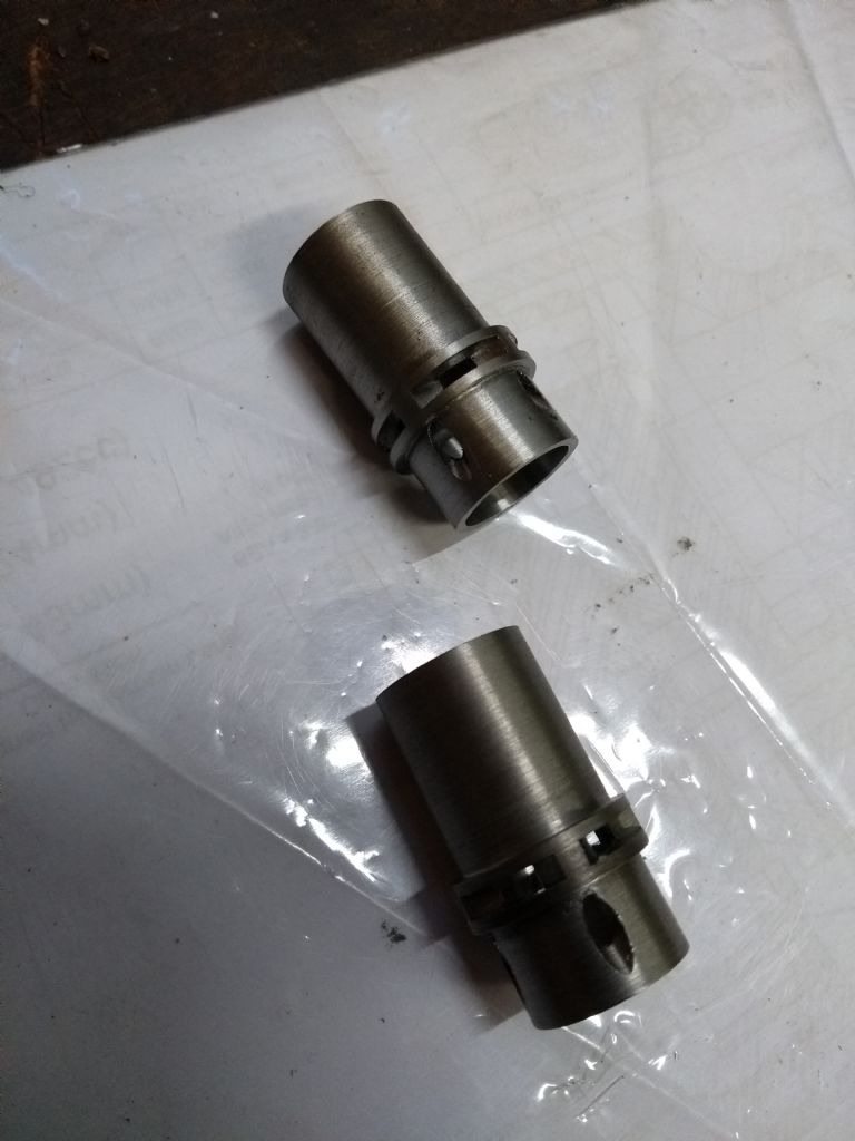

                  #441267
                  Graham Williams 11
                    @grahamwilliams11
                    img_20191205_181415751.jpgPicked up again after doing some work on my Velocette. Made the rotor, backplate and needle valve and the liner. Made the first liner from what I thought was EN1 but was tougher to machine so made another from known EN1A which machined more easily, also machined it in a slightly different order, both turned out OK, left the bore 1 1/2 thou undersize ready for lapping. Plans show cast iron for the liner but advice was to use mild steel which I must prefer as it's not dirty to machine though the pistons will have to be cast iron, Will need to source a 'tired' mini lathe to do the lapping in as I've decided not to use the Myford for that job.
                    #441449
                    Ramon Wilson
                      @ramonwilson3
                      Hi Graham, did reply to this late last night but went back a page without copying and lost it all!
                      It's looking good – not long now before that first runyes I think you'll find that the washers under the capheads aren't really necessary though – I don't ever recall any engine using them.
                      Sourcing long 6BA SHCS could prove an issue but cheese heads would be fine – again that's what virtually all similar sized engines of the period used but even there you may find it a problem. I have similar issues with 5BA so turn mine from 6mm En1a. I put a small centre in the end for support and make the thread longer than required turning the centre off and reducing to the correct length after.
                      'Cast in cast' is okay from a piston/liner combination of metals point of view but it does make for some messy exhaust residue. The initial seal usually reduces a little before the surfaces beds in too. I have just rebuilt a 5cc Miles Special for a friend which had a cast liner and piston. Relapped the liner and made a new piston. Once run that initial compression eased a tad though the seal is still good. Personally – for a basic home built I would not move away from a cast piston in an En1a Liner – a good combination of metals with exccellent abillity to create a very good piston/liner seal.
                      I don't think you have too much to fear about using your Myford for lapping if you ensure the bedways are well covered and the saddle pushed well back out of the way. Never seen that as an issue on mine on this op.
                      Looking forwards to seeing it run
                      Hope it all goes as well as it has to date
                      Regards – Tug
                      Edited By Ramon Wilson on 13/12/2019 11:46:45
                      #441465
                      Graham Williams 11
                        @grahamwilliams11
                        Hello Tug. You're right about the washers, they do look somewhat awkward so will dispense with those in due course. Have some 3mm cap screws but haven't tapped the c/case as they look clumsy as well so just ordered up some 2" long steel cheese head in 6BA so will shorten those and use them instead as you suggest. Bill Pudney in OZ suggested the EN1A/cast combination which appealed to me more as, you've probably guessed, I don't like machining cast iron . As to using the Myford for lapping, a very experienced flyer/engine reconditioner on the Barton site, who lives not far from me, kindly showed me his approach to liner/piston fits, he kept the lapping separate to his lathe, a Myford copy, using an old Hobbymat, which obviated the need to have lapping medium near his main machine. If I can get a tired mini lathe, which isn't proving easy, as all on offer seemed to be described as pristine!!!!! I'll set up for doing it that way as I've picked up some worn engines at boot sales again as well, otherwise I'll have to bite the bullet and cover everything in clingfilm and use the Myford
                        Fingers crossed it'll run, if it's ok have enough material to build a second one, (using the other liner) and it should be quicker as I now have a number of fixtures to machine the various parts lol.
                        Regards
                        Graham W
                        #441475
                        Ramon Wilson
                          @ramonwilson3
                          Hi Graham – whilst I quite like machining cast iron for its machinability like you I do dislike the mess/dust it creates sad. I have rigged up a vaccuum system on the mill but not on the lathe. Have to wear a mask too now as the dust really gets to me
                          Though there are several very knowlegeable memebers on there to chose from if, by 'experienced flyer on the Barton site', you possibly mean Johnny Alcock then you really couldn't have a better mentor. If it is then please give him my regards.
                          My use of cast in steel appraoch to piston/liner came from an article by George Aldrich in SIC some years back.
                          I was given a couple of old control liners yesterday with a well worn PAW 19 in one and a nice condition externally but somewhat lacking in compression AM25 in the other. Like you I have some rebuilding on the cards – I have started C/L flying again after some thirteen years layoffsmiley
                          Regards – Tug

                            #441552
                            Ramon Wilson
                              @ramonwilson3
                              Well you are definitely in good hands there Graham, there's little that Johnny doesn't know on engines and flying control line – as you say a real great guy and always willng to help.
                              As he's said, getting the fit right is the make or break of the project so take your time – when that breaks into a run you'll really be grinning from ear to ear smiley
                              Good luck with the rest of the build – Tug

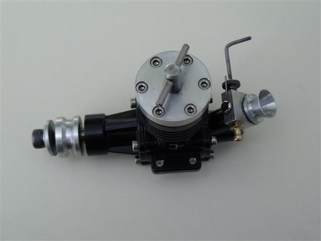

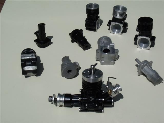

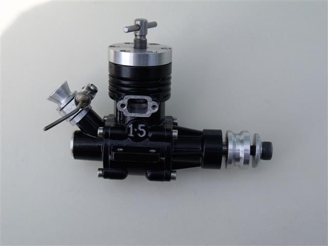

                                        john feeney
                                          @johnfeeney58965
                                          aeromodelling-model engine 2013 022 (small).jpgaeromodelling-model engine 2013 018 (small).jpgHi,
                                          This is not a problem in practice. For the engines I make I bore the bearing housing about 0.001" under size, this for bearing of 19 or 22 mm outside diameter. These engines run at 16000 to 20000 rpm. There are other ways that have been used such as fitting a steel sleeve into the aluminium crankcase but even in very high performance engines the direct fitting into the aluminium is usual. There are many other aspects regarding fits in small engines which run at high speed and use only the oil in the fuel for lubrication.
                                          #441710
                                          Ramon Wilson
                                            @ramonwilson3
                                            Sorry to impinge on your thread Graham but John thats a very nice looking engine there – is that your own design and likewise the castings?
                                            Love the black finish – is it destined for any specific aeromodelling use FF or TR perhaps
                                            I've always preferred rear intake motors, don't know if you are aware but have now made several 5cc versions of early well known smaller engines.
                                            Due to lack of suitable measuring kit I usually turn and polish to a high finish a plug guage for the bearing housing. I make this 0.02mm down on desired diameter on 24/26 diameter bearings. When that just slips in the cavity the fit is just about right though may need a slight tweaking with a piece of 800 wet and dry paper if a little tight on the bearing.
