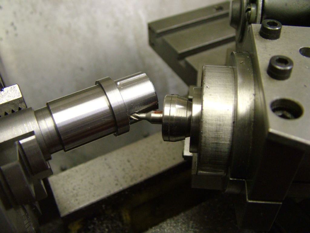

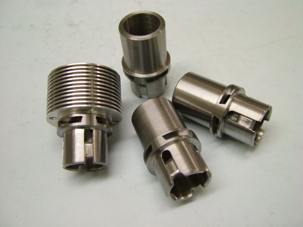

                                            In sheet 1, crankcase: what does the expression 0.005" witness mean in practical machining terms?
                                            In sheet 2, crankshaft: how can the counterweight be machined (in the form as drawn) when the crank pin is in the way? Or is the pin pressed in, but not shown as such?
                                            In sheet 4, cylinder: how is it possible to drill a #33 hole (2.9 mm ) at an angle of 25 °? Might be possible with a 3 mm slot mill, but that would be too large then? Or using 2.5 mm and then opening out a bit?

                                              I think the 0.005 is just a very slight easing of the inner edge where the angled cut meets the top of the crankcase. If you really enlarge the PDF you can tell the difference between construction lines and dimension lines
                                              It is easier with a pressed in pin but can be done with a long slender tool, I would use something with a more rounded end so you get a fillet in the internal corners and that also makes it easier to move the tool front to back cutting in both directions. The alternative is to hold the crankshaft vertically on a rotary table and mill the recess, again probably I'd use a cutter with 1mm corner radius 6mm OA dia should fit easy enough
                                              Might need to grind down a cutter's sides and plunge with the cutting ends,

                                                Sheet 2 , Crankshaft, I pressed in the pin before doing any lightening. I usally hold the shaft horizontaly in the chuck and use a radius cutter in the mill. Take horizontal cuts either side of pin and you then have a nice radius in the corner.
                                                Sheet 4, cylinder. The small difference between # 33 and 3mm will not effect any performance, probably improve it. Another version of the cylinder has much larger transfer holes, The important thing is to ensure the top of the hole is correct in relation to the exhaust. I used a 3mm solid carbide slot drill .(see previous page) One tip is to use a sacrificial plug in the cylinder to prevent snatch on breakthrough.

                                                    Hi Hans, only just become aware of these latest posts.
                                                    Though I haven't made a Nalon Viper as such I have made several engines with very similar liners and virtually identical exhaust and transfer porting layout
                                                    I have described this quite fully on build threads on the Model Engine Maker site – search for ETA and Oliver Tiger.
                                                    I use a cross slide milling attachment to 'drill' the transfer holes – I use an undersized FC3 milling cutter (eg 2.5 for a 3mm final size) to begin the hole until I have a full flat bottom surface then spot and drill through with a 2.5 drill being very careful on breakthrough though if the liner is mounted on a sacrificial mandrel that's not an issue. Once the initial hole is done I open up using another FC3 cutter to open to size right through. Depending on the wall thickness and angle of approach you may have to grind some of the cutter away on the shank to get the depth required.
                                                    I use the corner of the exhaust flange as a reference point to establish where to start the hole but a faint line scribed around the liner in the correct vertical position using the lathe and picking up with a sharp pointer at the angle required will be good enough unless you are seeking absolute perfection with accuracy of transfer timing.
                                                    Hope that helps some more
                                                    Best – Tug
