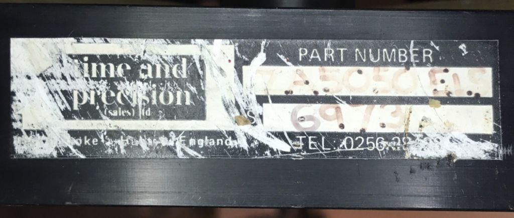

      I bought a rather nice ‘elevating table’ [for want of a better term] today
      Approx. 300mm square
      Baseplate 25mm thick
      Top-plate 15mm thick
      … with a substantial feed-screw at each corner, two extra bearing posts, and smaller post at the centre.
      The four feed-screws are synchronised by a timing-belt, and all driven by one knob.
      It has the look of being from ThorLabs, or Ealing Optical … but here’s the label
      Does anyone, perchance, recognise the firm in question from that fragmentary evidence ?
      Thanks in eager anticipation.
      First clue: http://www.geopunk.co.uk/phone-area-codes/01256-basingstoke
      Edited By Michael Gilligan on 12/01/2023 19:39:13

        #628921
        old mart
          @oldmart
          That confirms what the letters OKE are, remaining from the address. How about a picture of the whole table, that might jog some memories. I worked in Basingstoke my last 15 years before retiring, but that bit of the name rings no bells.
          Edited By old mart on 12/01/2023 19:50:35
          #628924
          Clive Foster
            @clivefoster55965
            Yep. Time and Precision a UK manufacturer of precision linear stages and similar devices for laboratory and lighter duty specialist devices.
            As I recall matters they were active from around late 1970s' (ish) to early 2000s' (ish).
            Their stages were rather longer travel than the typical Ealing, Micro Controle, Melles Griot, Newport et al ones usally found in optics labs.
            Range from 6" to maybe 3 ft when I used to buy them. A bit on the narrow side. Simple carved from billet design with plain dovetail sliders. Stainless steel feedscrew and simple engraved hand wheels for calibration rather than the common micrometer head pusher. Optional direct drive stepper motors able to interface with low end unipolar drives for roll your own systems or a turnkey set up to plug into a BBC B computer.
            Made a fair number of specials and low production devices based on their standard parts.
            Always seemed a bit under-funded. Everything had the look of tool room rather than production parts.
            I believe they started out making calibrators and timing references. Hence the name.
            may have some data somewhaer but won't be looking until I've fought off the flu'.
            Clive
            Edited By Clive Foster on 12/01/2023 19:57:42

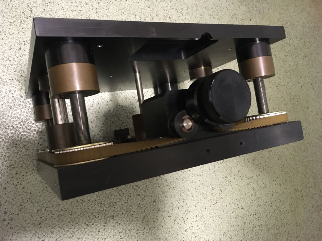

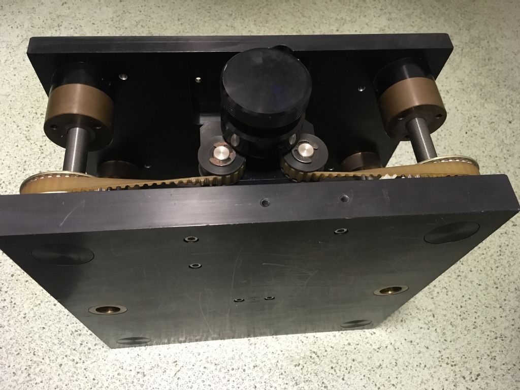

            #628926
              Posted by old mart on 12/01/2023 19:48:27:
              How about a picture of the whole table, that might jog some memories. […]
              I should have known I wouldn’t get away with just asking a simple question:
              … on edge, on the wet-room floor
              Twiddle the knob and all four jack-screws go up & down in synch.
              It’s a bit grubby, and has a couple of scrapes, but basically it’s very nice !
              Edited By Michael Gilligan on 12/01/2023 20:11:46
              #628927
                Posted by Clive Foster on 12/01/2023 19:57:08:
                Many thanks, Clive yes
                Get Well Soon … he said, not entirely altruistically
                Edited By Michael Gilligan on 12/01/2023 20:03:56
                #628931
                old mart
                  @oldmart
                  Looks like it only has about 1 1/2" movement, what do you intend to do with it?
                  #628932
                    I do photomacrography
                    … so positioning and/or focusing
                    Edited By Michael Gilligan on 12/01/2023 20:14:59

                          Baz
                            @baz89810
                            Yes definitely Time and Precision in Basingstoke, going by the phone code it is quite old, label shows 0256 code, Basingstoke is 01256 and has been for many years, if you can find out when the code changed you could possibly date it. The company was owned by two brothers, cannot remember their names, the unislide was the core of the business with a bit of sub con work for other companies in the area, biggest the factory ever got was about a 4000 sq foot unit with about 15 – 20 employees. Company is long, long gone.
                            #628940
                              Posted by Baz on 12/01/2023 20:26:10:
                              Thanks for the confirmation, and extra info. Baz
                              [ the bit about 0256 is covered in my first link ]
                              #628944
                                Looks like we’re sorted … Thank you, Gentlemen
                                It’s old and I’m unlikely to get any spares or instructions … But it’s a simple and effective device, in good working order; so unless I do something daft, it will probably see me out.
                                An excellent result !!

                                  #628950
                                    Please also see my UPDATE, Clive … which crossed with your latest post.
                                    #628951
                                    old mart
                                      @oldmart
                                      If there is a number on that toothed belt, make a note of it, thats the only part which might fail.
                                       By the way, the company is 2/3 of the way down Telford road on the right, I had to check on Google earth.
                                      Edited By old mart on 12/01/2023 21:02:27
                                      #628956
                                        Fit a stepper for that stacking photograhy? Should be easy with that drive arrangement.
