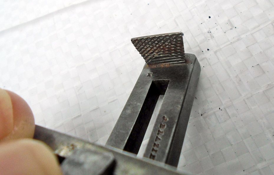

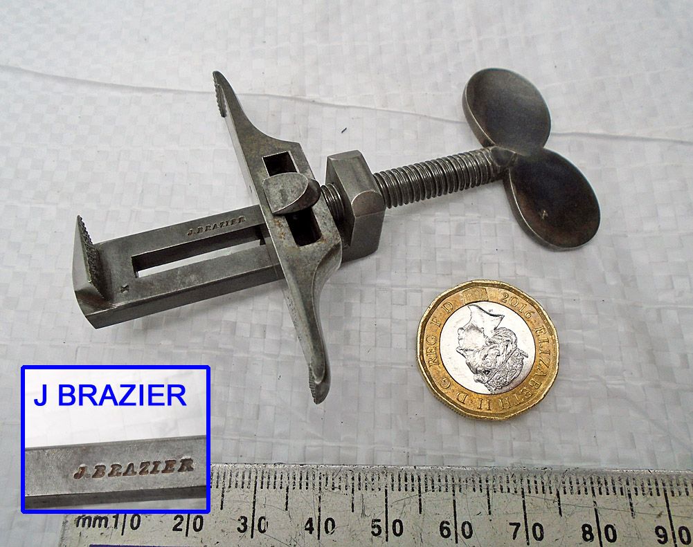

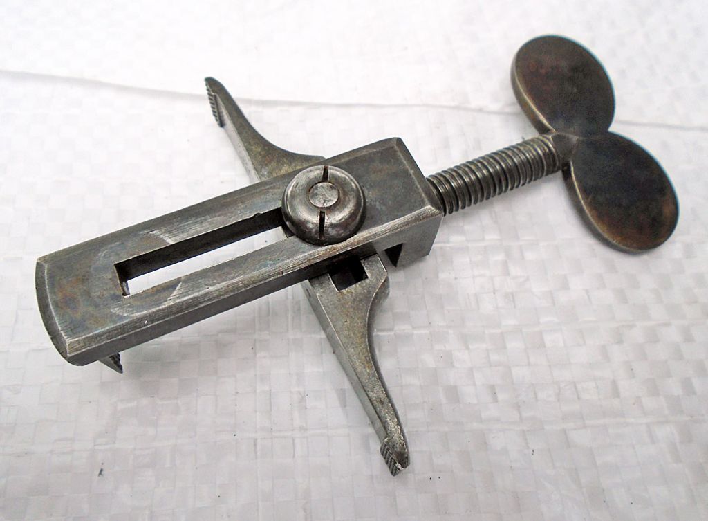

      Hi All,
      This was in the drawer of an old chest full of tools bought lately and just got around to. I think that it is gun related so hopefully someone can enlighten me?
      Cheers Martin

        Oldiron
          @oldiron
          Looks like a musket spring clamp to me.

              Mick B1
                @mickb1
                My guess would be that it's a leaf or vee spring compressor, for use while slipping a tumbler, sear or suchlike into position during assembly of gun-locks.
                #655083
                  Posted by Mick B1 on 03/08/2023 20:02:38:
                  +1
                  Older guns contain powerful v-shaped leaf springs, not coils, and the spring pressure has to be released before the lock can be worked on. One way was to squeeze the V together with a clamp, either to remove and replace the spring entirely, or to work on the unpressured mechanism with the spring clamped down in place. Spring clamps are available for repairing spring powered clocks – same purpose, different shape. Car engines too, but constructed to clamp coil springs.

                        vic newey
                          @vicnewey60017
                          As a vintage gun owner I have one of these, it's a mainspring clamp for all types of guns not just muskets and they still make them today. If you Google gun mainspring clamp or vise you will see lots of different variations
