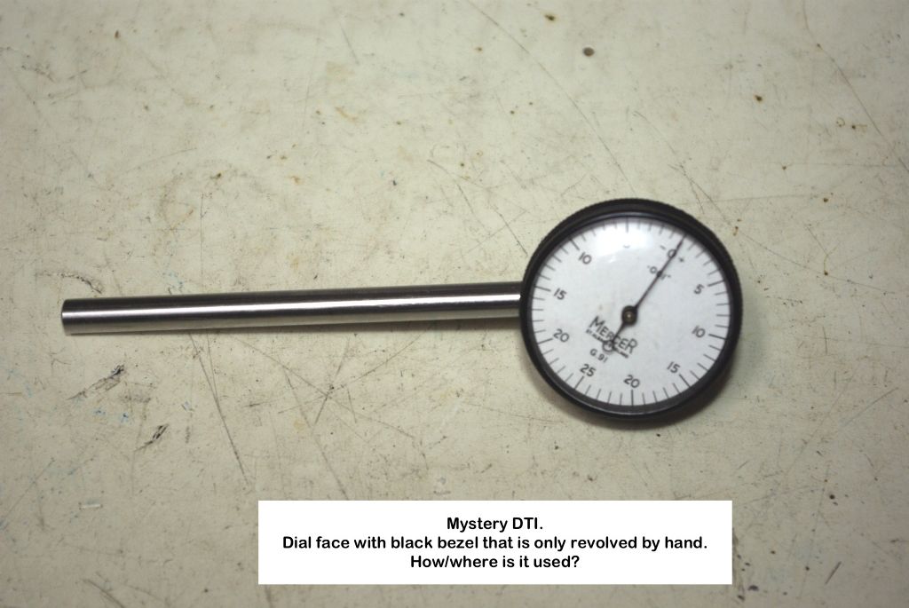

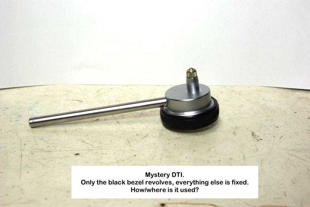

    OuBallie
      @ouballie
      Tidying up my drawers, in preparation for experimenting with foam and papier-mache in organising items in them, I came across this 1.1/2" Mercer G.91 DTI.
      DTI face
      The only part that moves is the black bezel, the indicating lever and arm being fixed.
      DTI rear
      The contact 'pin' is fixed as well, and unscrews.
      Any help as to how and where it is used appreciated please.

          Hi, Admittedly I haven't a definite answer for you, but I wondered if the contact point would unscrew from the back of the gauge and then screw into the end of the long arm?
          Steve.

            Hi Ouballie
            You may find a small drop of light oil applied to base of the knurled probe on the back will release it. I suspect it is stuck fully pressed in.

              Just found this on Fleabay:- **LINK**
              So just to answer my own question _"no"
              "The dial moves from the back"
              I think John has it right.

                    Hi OuBaillie ,
                    Your pic shows a standard back button dial gauge . Mercer gauges are still available as new items . Here is a website page showing modern day version :

                      John & MichaelG,
                      You both got it in one.
                      After reading the responses, I loosened the probe enough to get a thumb nail under it, levered and it moved ever so slightly, so as mentioned, it's stuck.
                      So a little 3in1 as suggested.
                      Mystery solved.
                      I did 'manage' to remove the bezel, but quickly got that back.

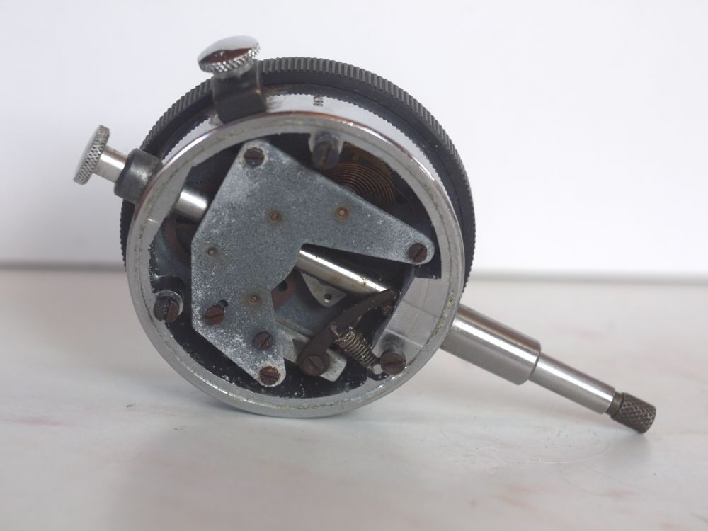

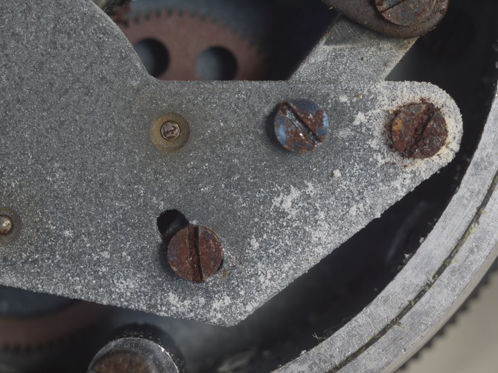

                          Posted by OuBallie on 11/06/2013 18:20:08:
                          MichaelG – What exactly do you mean by 'nasty surprise'?
                          I hesitate/am reluctant to take it apart, as I have visions of all sorts of bits and pieces heading for the nearest black hole, that seem to inhabit all workshops, of whatever size or tidiness.
                          Nasty surprise = furry corrosion
                          I will post a photo sometime.
                          P.S.   This is what it should look like
                          Edited By Michael Gilligan on 11/06/2013 18:56:24

                            Update.
                            Since my first post, I have been applying normal as well as 3in1 oil to the plunger, and it has finally today freed enough to be sliding smoothly.
                            The gauge now appears to be working as designed, but I will continue applying the lighter of the two oils for a while yet, moving the at the same time.
                            Ta for all the help.

                                          Posted by Michael Gilligan on 11/06/2013 18:52:10:
                                          Geoff,
                                          Sorry for the delay … I finally got around to re-sizing some pictures; only to find that I had already done that [side-effects of Anno Domini]
                                          My furry DTI is not the back-plunger style; but it is a Mercer, and the corrosion is fairly typical of one that has suffered condensation.
                                          Three more pics in the Album.

                                          OuBallie
                                            @ouballie
                                            Thanks for the photos MichaelG.
                                            I'm still reluctant about taking mine apart, namely because I'm not sure how to, and seeing that it appears to be working fine, I'd rather let sleeping dogs alone.

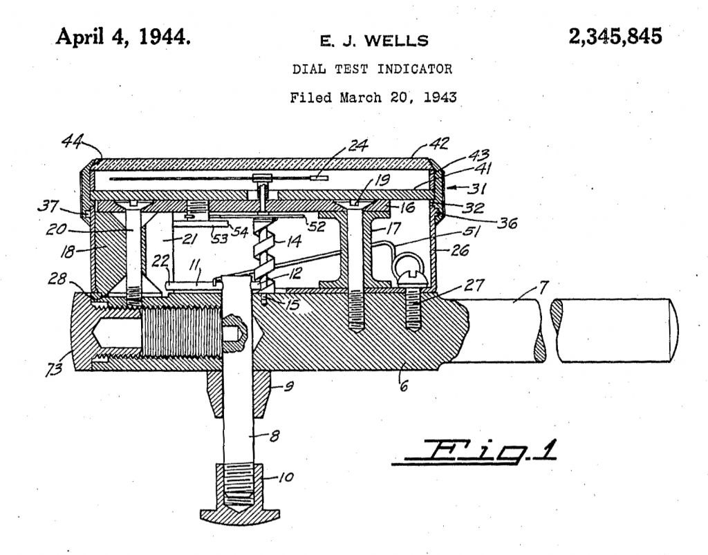

                                                  #552282
                                                    Posted by vic newey on 02/07/2021 15:24:15:
                                                    But what is put in contact with the workpiece? I have a couple of finger types and several more plunger types but this one shows no way to use it as far as I can see
                                                    The link that I posted previously is dead … but here’s what it should look like externally: **LINK**
                                                    http://www.europacprecision.com/files/products/126/1/f40.pdf
                                                    Note the short plunger shaft labelled M2,5 – 6H
                                                    That is, I believe, what is/was stuck on Geoff’s specimen.
                                                    If it moves … usage should be self-evident
                                                    Edit: __ This should help
                                                    Edited By Michael Gilligan on 02/07/2021 15:56:51
