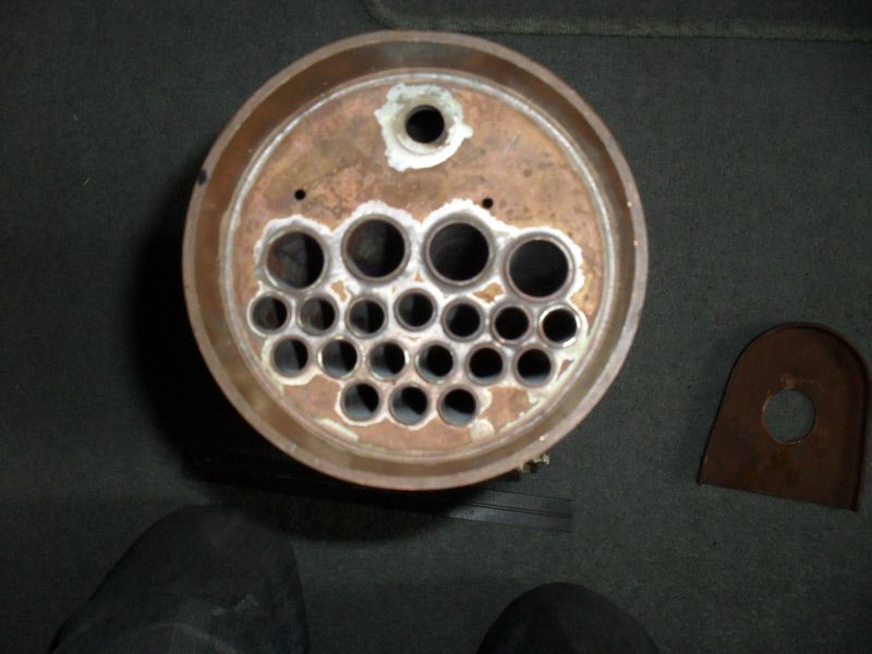

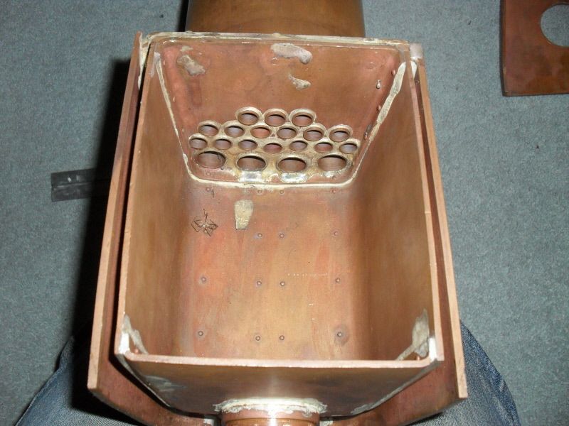

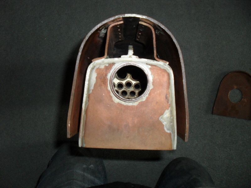

      sdc11186(1).jpgsdc11185(1).jpgsdc11184(1).jpgCan anyone help to identify this mystery loco boiler. It's 18 5/8" long overall and 4 3/4" diameter. There are 4 x 3/4" diameter tubes plus 16 x 7/16" tubes and a 3/4" thick walled regulator tube. The outer firebox is 6 1/2" long by 5 3/8" at the base and the inner firebox is 5 3/4" x 4 5/8" . The backhead is 6" high and the inner firebox is 4" high. There are 2 crownstays and a third longitudinal stay along the crown of the firebox. Anyone any idea what loco this boiler might be for – no one at my Club could suggest anything but several members felt the firebox was very shallow (much shallower than my Pansy boiler although overall it's a very similar size. 12" rule in the photos for comparison.

        #478985
        Jon Lawes
          @jonlawes51698
          I'm fairly ignorant in these matters, but I don't let that hold me back.
          The shape of the firebox looks quite LNER if that helps to narrow it down (or insert a red herring).

          #479052
          Nigel Bennett
            @nigelbennett69913
            Like Jon, I thought LNER too. It's similar to a Maisie, but with a different tube arrangement. The firebox is also quite a bit longer than Maisie, but overall boiler length is about the same. Maisie does have a sloping throatplate, It might therefore foul the trailing wheelset of a Maisie chassis. Good luck with whatever you do with it!
            #479101
            Nick Clarke 3
              @nickclarke3
              LNER boilers had sloping throatplates so I an tempted to suggest it might be for Martin Evan's Canadian 0-8-0 design Caribou (or 2-8-0 Buffalo)
              The boiler was described in ME vol 128, No 3218, 14th March 1963, pp335 et seq and in following issues

                #479381
                peter ravenscroft
                  @peterravenscroft57700
                  hi alexander
                  that is a caribou/buffalo boil i have the construction book
                  regards
                  peter
                  #479669
                  Alexander Smith 1
                    @alexandersmith1
                    That's fantastic Peter. Thanks for confirming the identity of the boiler and thanks also to everyone who helped- this is a really amazing site. If I send you a PM, Peter, would it be possible to let me have a copy of just the boiler plan- I can't take on any more projects so this boiler will have to go to someone who can make use of it. I got it for more or less the scrap copper price so if anyone us building Caribou it would be a very cheap boiler.Sandy
