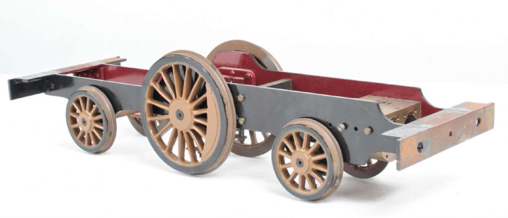

      Can anyone please tell me what prototype this locomotive represents?
      I'm very tempted to buy it, but I know I'd struggle to complete it unless there are plans available.
      It's on the Station Road Steam home page right now, that's where I borrowed the photo from.

          From the wheel arrangement and the paint colour I think it may be " Belle Stroudley" a LBSCR class G 2-2-2 one of LBSC's designs for 2 1/2" gauge. It is certainly a rare bird I've never seen one. According to the 2 1/2" gauge association website plans are not available. There may have been a write up in one of the magazines such as Modelmaker or Practical Mechanics. I'll see what I can find out. Would make an attractive and interesting model.
          I've just had a better look ( after a coffee!"  in " LBSC his life and locomotives" it was described in M.E in 1932, from SRS's website it looks decently made, I'm guessing it was intended for Joy valve gear as there only seems to be a pump eccentric on the crank.

              Don't expect too much – the 'description' consists of 4 pages in ME August 27 1931 with a side elevation of the loco, one of the tender and a couple of views of the boiler although not all of the stays needed are indicated an there is no view of the backhead or any fittings at all.
              There is no information on valve gear, cylinders or crankaxle other than references to past descriptions and while the chassis here is outfitted with an eccentric presumably for a pump there are no details of the pump described.
              Certainly if you have access to a number of old MEs it would be possible to match the deatils to this chassis however I suspect that buying the bound volumes necessary might cost you as much as the chassis itself – you would probably need at least volumes 63,64 and 65 as these contain the information on 'Dairymaid' the loco most referred to in this article.

                    The one on the cover of shop shed and road is of curly's Grosvenor in 3 1/2" gauge, it was his own pet engine, true to scale but never published .
                    br has hit the nail on the head the drawing is " Belle Stroudley" , I'm afraid it's one of Curlys updated engines where he fits an oversize boiler which to my eye makes it look like a caricatureof the original engine, there is a small grainy picture on Page 35 of Brian Hollingsworth's LBSC book, so at least one has been built.

                        Thanks gentlemen, so it's, 'Gee up, whoa back' then. I agree about the oversize boiler, it looks like a six foot bloke with size 3 shoes!
                        I will follow up the Dairymaid lead thank you, I don't know much about that engine.
                        I'm just dipping my toe in the 2&1/2" gauge waters at the moment, I'm trying to find a small engine with proper valve gear and a coal-fired boiler that will suit the projected light railway I've got room for in my new garden.
