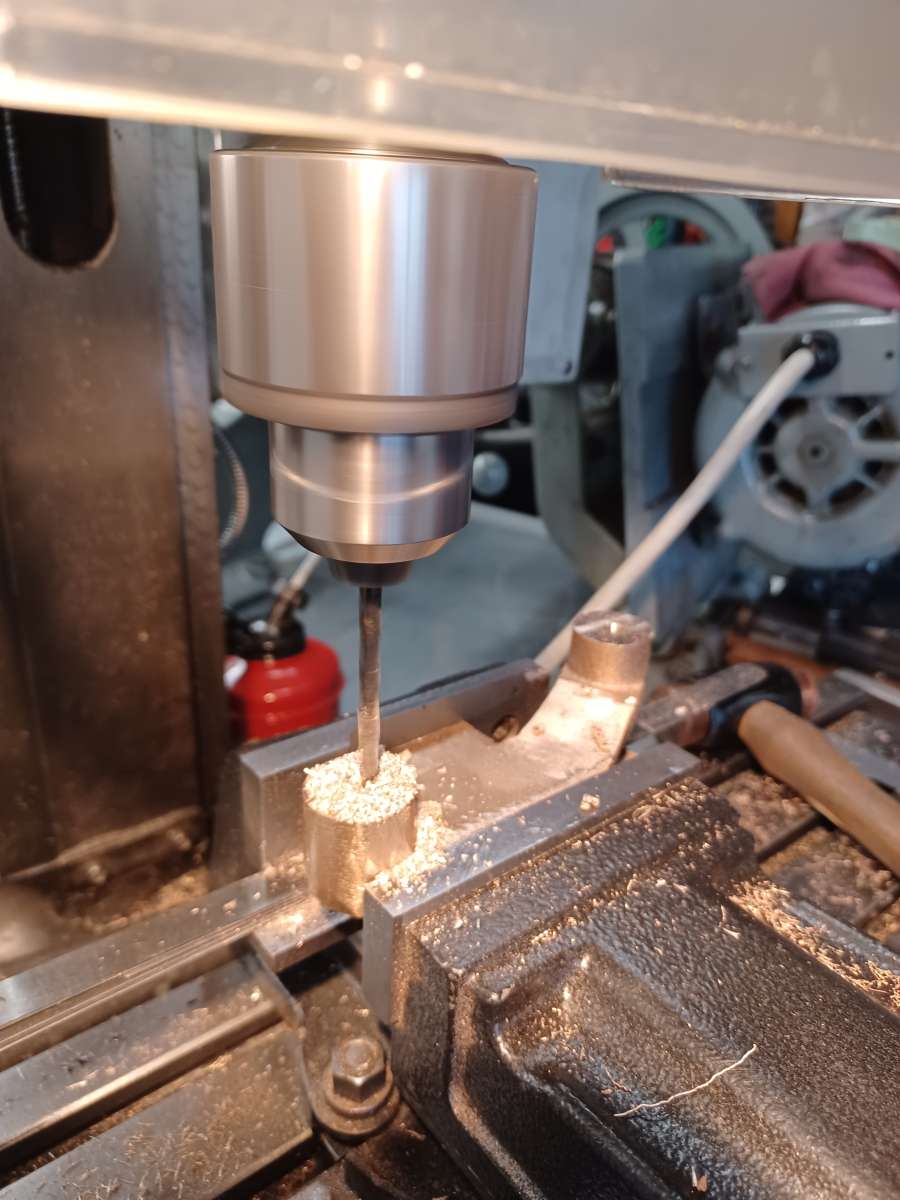

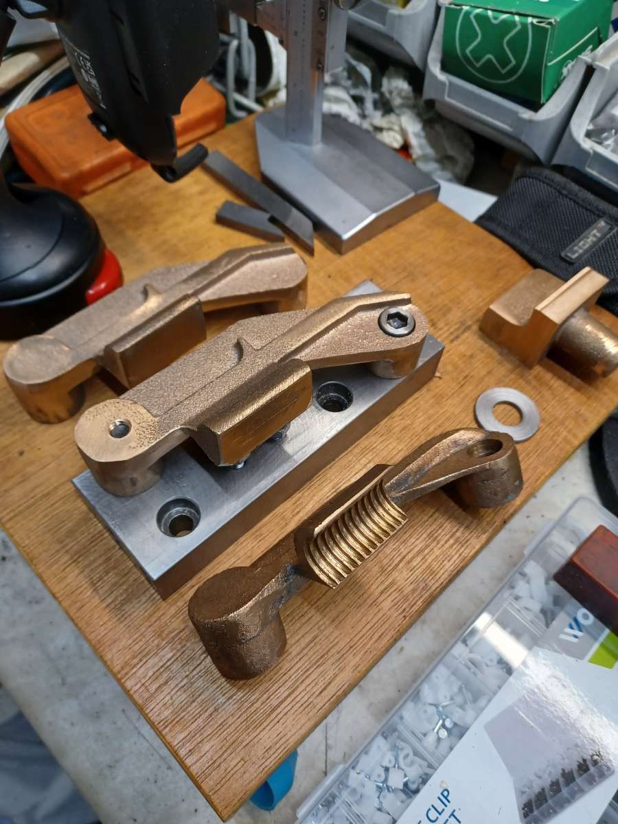

        hI i may have a spare in a while as I have had some cast and have two in progress one is spoken for.
        20231112_101602
        20240204_104011
        David

          Have a look at this video.
          https://studio.youtube.com/video/sSBRzynsqLo/edit
          Drop me a message if you are interested.
          David

                  I’ve actually got part of the conrod machining attachment for these lathes which I know used a between centres boring setup like that. Never done it myself though.
                  Looks great!
