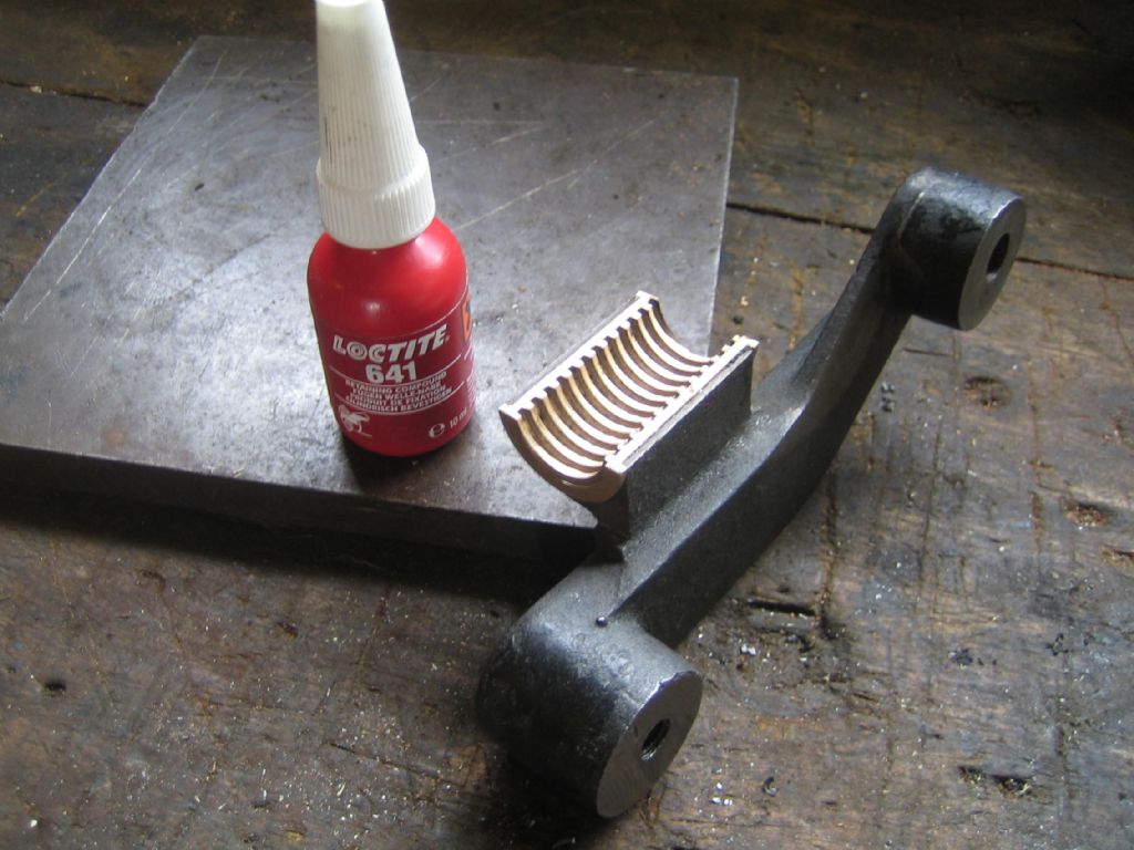

        Hi
        i have recently acquired a myford type M in amazing condition. I’ve just stripped it down and cleaned off 80 years of grease embedded with brass filings and got to the half nut. This is novel to me as my previous lathe was the earlier drummond with a full nut. My question is what’s the top half for? The bottom half moves up and down on the bronze arm to disengage the lead screw but there’s a top half shell to the nut which doesn’t appear to be threaded. Is this just a support in case the lead screw bends under load?
        Thanks
        Dan

          You have it right. The top half slides along on top of the leadscrew to prevent the leadscrew pushing away from the bottom half nut. It wears a little over time to have a impression of the leadscrew and that can give a ratchet effect as you traverse the saddle along. Just scrape and file it smoothe.

              Check the condition of the thread in your lower half-nut. There is a repair procedure involving making a threaded "bobbin", cutting it in half and soldering it into a recess machined in the old half nut lever. It is a bit involved so unless the old one is completely stripped, not worth the bother. A bit of backlash there does not affect its operation at all.

                            I made the traditional threaded "bobbin"-cut-in-half repair piece for my M-Type out of plain brass. It seems to have lasted well with no signs of wear yet. It was my only lathe for about five years used regularly for hobby work, including making my fabricated GHT versatile dividing head before I got the ML7 and shared the love around. So quite happy with the brass, plus it is supposed to be gentler on the leadscrew. Soft solder seems to have stood up well too, no doubt due to the shoulders at each end of the "bobbin" taking the load.

                                This stuff is pretty strong as well, an old pre war cast iron arm with a bronze bobbin repair, still going strong after 10 years

                                    The last guy who made them at the Drummond factory probably died about 1980
                                    It’s the only weak point in an otherwise bulletproof hobby lathe
                                    Some guys have cut their own and refitted them to the original arm, very skilfully I may add
                                    I went for the simple route and it’s been fine for 2 units so far, one of which cranks 40 kilos back and forward along the lathe bed
