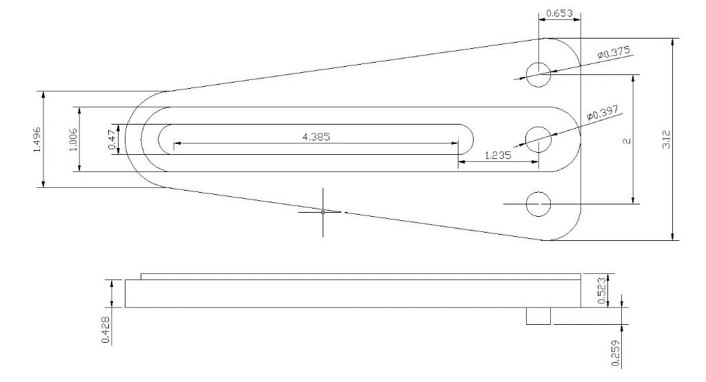

        The arm from my Myford lathe taper turning attachment has been mislaid in moving workshop and may have accidentally been disposed of so I am trying to source a replacement.
        The new “Myford” company will not sell an arm separately, insisting I have to purchase the complete £500 kit again just to obtain the arm.
        Anyone any ideas on replacing it?
        Thanks!

            Do you mean the arm that goes from the cross slide to the taper unit? Should be easy enough to make one. It is only a piece of flat plate with slot in it. A piece of 6061 aluminium would do the job and easy to cut or machine to shape.

                    I'm reminded by looking at that thread that I made a sketch of the arm:
                    HTH,
                    Rod

                      Thank you for the above information, it is indeed that arm that I am referring to.
                      I was hoping to buy a ready made example as I have very little spare time however looks like I will be making my own arm.
