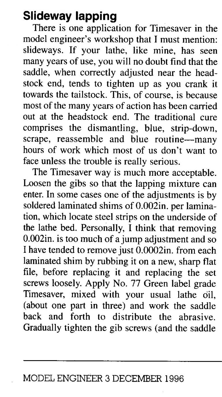

        Whilst searching thro' back copies of M.E. for an article, I happened upon this entitled "Lappiing – Machining to Millionths" from No. 1996.
        I don't think there's a copyright issue with me reproducing this short extract.
        If the methodology works as described it could be a simpler approach.
        The volume and date can be taken from the image below. If you want to pursue the idea & don't have the original mag issue then I think you may have to seek permission from M.E. publishers for me to copy it to you. Send me a PM if so.
