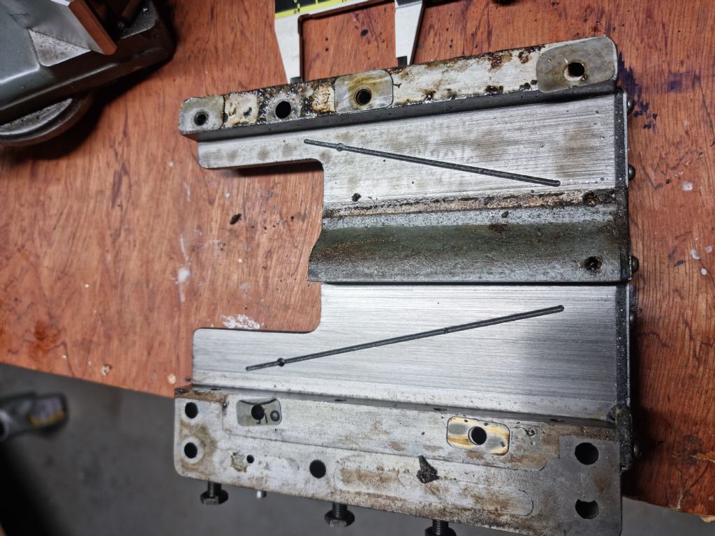

      I've got a super7 of late 1960s vintage, so it adopts the narrow guide saddle.
      The saddle operates smoothly and there is no play when toward the headstock end and in the middle of the ways, but when I move it further than half way toward the tailstock it gets stiff, very stiff to the point that you don't want to crank it when it nears the tailstock.
      Its a new machine to me, so I did some research and anticipated that the inner edge of the front way would be worn toward the HS, and that the tightness could be compounded by the narrow guide having been worn, mostly toward the tailstock.
      Today, I stripped it down and to the naked eye the narrow guide looked near perfect. Unfortunately I do not have an appropriate micrometer to measure between the front edge of the saddle and the narrow guide, but I used a mitutoyo digital caliper on the gap at both ends and the middle (the readings will not be perfect, but they are averaged and I think fairly indicative of the gap). Toward the headstock I have 50.44mm and toward the tailstock 50.21mm. at the middle I have 50.3mm. according to these readings, the inner guide is actually less warn toward the tailstock, which surprised me but also reassured me that my eyes were working pretty well.
      I then looked at the gap between the ways. Scraping marks from factory are present on inner edge of the rear way all along. Scraping marks are present on the inner edge of the front way from the tailstock to midway along toward the headstock, and then fade. I tried to get some representative readings from my digital caliper but it was no use. In any event, there was definitely some ware on the inner edge of the front way, but not a 'lot' – visually they look in good condition as well.
      Latly, I used the tailstock to provide an indication of ware toward the headstock by adjusting the Gibs with the TS at its proper end – no play evident – and slid it all the way to the headstock -at that point, there was some play evident but a ' fairly' small amount, nothing drastic.
      Ayways, my primary goal is to get this thing operating smooth allt he way to the tailstock end, and I was considering to alter the saddle to operate off the wide guide, i.e. the inside face of the rear way – but seeing that the saddle is not very worn, and the ways are also seemingly not 'that' worn, I wanted to make sure I wasn't overlooking anything first.
      I'm relatively new to model engineering, so whilst I have a head scrrwed on (I think?!) I am not a machinist by trade, so apologies before hand if what I've said above doesn't make sense.
      If anyone could point me in the right direct / share their thoughts on this situation and what I want to achieve in the end, I'd be very appreciative.

            Don't think you have missed anything, the shears are worn at the headstock end, most of the wear will be on the front shear. The narrow guide myford is a poor design which is why the later models  use the outer edges of bed shears as the saddle bearing surfaces.
            The front shear is mainly used on the narrow guide design and this is subject to most of the wear, not helped by the short bearing surface of the middle of the saddle which allows the saddle to rock. As most of the work is usually done close to the headstock, the front shear inner and outer edges wear most in that area over time. This is confirmed by your visual –Scraping marks are present on the inner edge of the front way from the tailstock to midway along toward the headstock, and then fade
            Unfortunately, your lathe exhibits the most common problem with that class of machine. Not a lot of wear visually observed is more than enough to cause this problem. Effectively your front shear tapers down towards the headstock.
            If you cant live with the problem and adjust the saddle fit to suit the job you are doing, then you options are
            • You can get the bed and saddle reground if you can find anyone still capable of doing it and you have deep pockets
            • You can do the standard documented wide guide modification which uses the outside of the back shear
            • Some people have claimed that they have scaped/filed/ground the shear edges, but I wouldn't recommend it
            Should also add, that if the bed is significantly worn, the shears can also be thinned on the z axis towards the chuck, so you will need to check the thickness of  front and back of each shear chuck to tail every 30mm along the bed. If this is the case, the wide guide mod may not solve the problem.

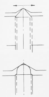

                                                    My previous S7 was a well-used buy and initially displayed similar symptoms. Quite a bit of wasted time was spent trying to adjust the gibs before discovering Geo Thomas' book and his observations on Myford gibs. He described the (quote) "wedging action" of Myford gib adjusting screws and how modifying their ends could remedy certain problems. His drawing showed:-
                                                    I can't claim to have produced perfect hemispheres on the ends of the adjusting screws but rounding them off reduced, albeit not eliminated, the tightening-up of the saddle along the bed.
                                                    (The V-shaped indentations in the topslide gibs were far from smooth – showing considerable scoring. When they were cleaned up and the topslide adjusting screws rounded – movement there was much improved).

                                                      I think Geo Thomas also advocated dowelling the gib to the slide body, to prevent any axial movement of the gib relative to the slide body. I have done this to my topslides and it does make a difference.
