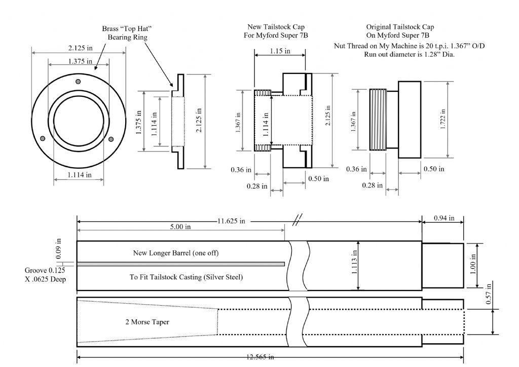

      I have spent hours trying to upload a drawing of mine to my album – or simply to a forum post and cannot remember how to do it.
      Are there instructions on the forum? Yes I know it has to be Jpeg which isn't the best, but I have converted from PDF to JPG and still cannot get it into my album.
      Yes I know that I am getting old – but is there a pointer to instructions on how to do this?
      Can anyone help?

            Hi David.
            I've uploaded YOUR drawing for you here.
            Ian

              Thank you Ian for your kind help.
              I did manage to upload the drawing to my album and I appreciate your help. Unfortunately due to time pressures with my project to convert my tailstock to lever feed, I have not progressed much further with it and I want to complete the conversion of the tailstock on my machine before perhaps inadvertently misleading others.
              Kind regards – I will return to this conversation in due course.
