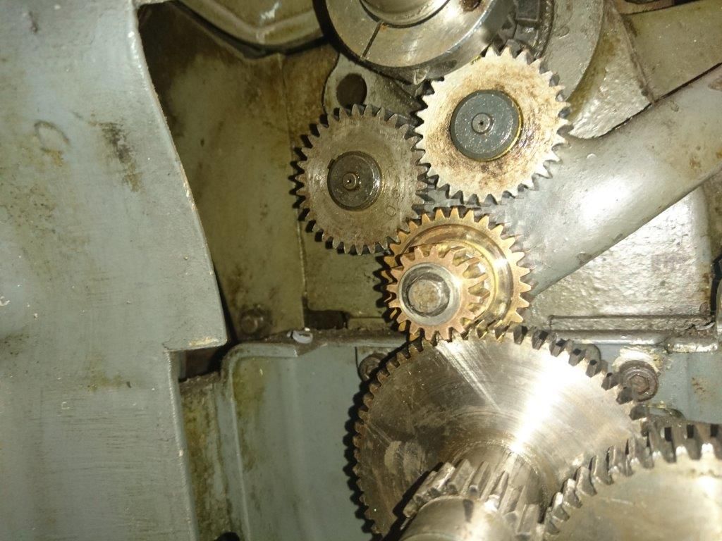

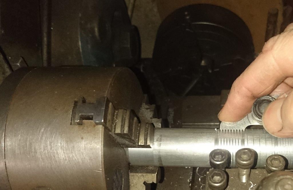

                              Fruit of my day's labour ( the bronze bit centre stage):
                              Is a 29T gear pretending to be a 30T gear, with an integral 16 gear attached, meshed with the gear train driving the QC g/box on my trusty S7.
                              xxx
                              The proof of the pudding is in a 1.75 mm (approx.!) thread.  Q/C gearbox is set for 20TPI, I've only made a scratch pass just to prove the train.
                              With special thanks to John Stevenson for the geometry lesson!

                              #289948
                              Allan B
                                @allanb
                                Looking good, my new gears arrived today with a big thank you to John for supplying them (I wish I had the skill set to make my own, or the kit for that matter lol) but I have been like a kid at Christmas who isn’t allowed to play with a new toy all day as not had the time to escape to try them out.
                                Allan
                                #289959
                                John Stevenson 1
                                  @johnstevenson1
                                  Posted by Simon Williams 3 on 21/03/2017 19:50:10:
                                  Simon
                                  Weird shaped tumbler gears ??
                                  And not Tufnol gears ?
                                  #289964
                                  Simon Williams 3
                                    @simonwilliams3
                                    Evening John, (JS) – You've got me bang to rights guv.
                                    Though that's not the whole of the story. What I haven't let you see is the hand filed teeth on the 17T pinion of the first transfer gear (just bottom of picture.
                                    I bought the gearbox second hand from you know where-bay, fitted it ( the comments about a spacer behind the casting worry me, but I'll save that for another day) and found that it jammed in one ratio. Should have stripped it and checked first, but was far too excited with my new second hand purchase to be that clinical. Can't remember the details, but suffice it to say that the single tufnol gear that was fitted to the tumbler is still in the drawer with the rest of the set of changewheels from the days when I set it up long hand, and it's got three teeth chewed off it.
                                    At the time I had a little Alpine simple dividing head, so the ally gear you see here was cut with a single point flycutter, probably of a crude and dubious shape, and has seen maybe 20 years service since the scrunch up. I'm fairly sure this was my first ever adventure into making a gear, so begging yer pardon if it's not up to snuff.
                                    Now that I know a bit more about cutting gears, t'would be the work of a few moments to make another. Must get roundtuit.
                                    To the best of my recollection the other tumbler gear is as original – or at least I haven't changed it. This lathe came out of Stroud Technical College in about 1976, so it's probably had a hard life even before I got hold of it.
                                    Thinking about it, if I was going to have only one tufnol gear it would be better if it was the other one – which is in service all the time. Too late to worry about that now!
                                    Thanks as ever
                                    Simon
                                    PS  The chewy chewy of the transfer gears wasn't me.  They were like that when I bought the gearbox.  20/20 hindsight says that should have told me I needed to strip the gearbox and investigate, but I didn't follow the clues.

                                    #289970
                                    John Stevenson 1
                                      @johnstevenson1
                                      To be technically correct the tumbler gears are 20 DP but 20 degree PA and not 14.5 like the rest.
                                      Only the spindle gear and tumblers are this PA, done I presume to make the tooth form stronger and easier to produce than a corrected gear ?
                                      #289972
                                      Simon Williams 3
                                        @simonwilliams3
                                        Well, that's a low blow, what!
                                        So I guess it's easier to buy the spares than a whole new set of cutters. Bother!
                                        But that means that the transfer gears and my magic combo should all be 20 deg PA as well. Blow that for a game of soldiers. The change gears meshed with the tumblers, what's going on?
                                        Looks like I'd do better to replace the tumbler gears and the one on the spindle. No rest for the wicked.
