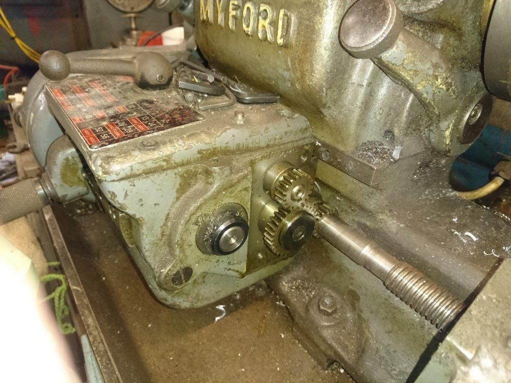

      Yes, correct. you will want a 17T instead of a 34 and a 16 1/2 tooth instead of the 33 wink

        Seriously, if anyone is hankering to follow the details of the label in my Mk1 gear box as above, I can't make the arithmetic work out. Interestingly the kit of bits on ebay just now (John's link as above) doesn't contain a 52T gear, nor yet a 44, and neither refers to a 63.

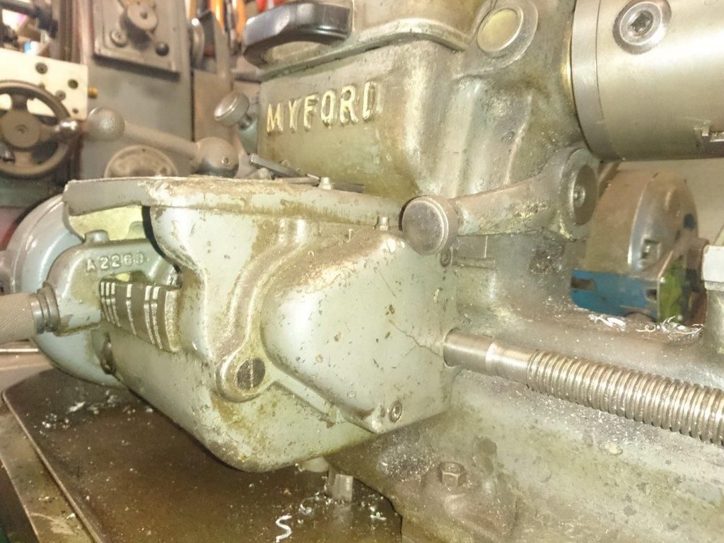

              Hello Simon,
              ​John has you pretty much in hand, the logic is all correct as I would expect
              For my own interest, your gear train photo does not show a 1:2 reduction gearing tucked in behind the wide 72 tooth wheel which was the case in the later gearboxes. That explains the 12 tooth mandrel wheel.
              I assume your gearbox will have a small housing on the tailstock side enclosing gearing. It is not an arrangement I am familiar with and it will not therefore cater for the reduction gearing above.
              ​You may find some fine pitches unobtainable as a result and I am willing to help, if you need any, to test out other arrangements that might suit what you have to hand.

                  Just to fill in some gaps on this thread:
                  Brian, the early gearboxes before QC2501 had an aluminium cover at the tailstock end with 18T(gearbox output)-30T(idler)-18T(on the leadscrew, also at the tailstock end). Fine feeds were the same.
                  Simon, as you may have realised by now, you cannot fit a 17T cog on the tumbler assembly as it would cut into the keyway, being too small. The metric set on e-bay as advised by John S is for the later gearbox, but the metric quadrant piece in that picture is the same. The tables appearing on this thread will not work on the early gearbox. If you want further help you can PM me, but I have never worked out the various approximations to metrics for the early box.

                  Simon Williams 3
                    @simonwilliams3
                    Well, thanks one and all for the interest and advice, and I guess I really owe the OP an apology for hi-jacking his original thread.
                    But the rugby's over, Wales lost to France on a technicality, so while I've been sulking in my shed this morning I made this:
                    The gear on the left is the original 30/12 pair, and the pair on the right is my new 30/17 combination. I made them in bronze so I could soft solder the two parts together, and also when I rummage in the drawer through the accumulated selection of change wheels in a couple of years time I'll remember what this funny looking thing is for. For JS' benefit, when I've made the 16 1/2 gear I'll post a picture.
                    I haven't tried this out yet, I'll have a play with cutting whole mm pitch threads over the next few days, but I'm confident. What could possibly go wrong?

                            Short answer – no and no. It is not as you call it a "little outrigger housing". The cog positions are part of the gearbox casing at that end. The 18T is on the top shaft at the opposite end to the modern 26T driver. The idler gear is on an extension to the intermediate shaft which does not come out of the modern box at either end (it's there as a collar only). The guts of the boxes are identical but the casing changed shape. In any case a bigger cog will not fit onto the leadscrew (against the bed) in the relevant position. It's no problem for the 52T at the other end. It's a non-starter, so to speak. No idea how many early boxes still exist and the first one was certainly not QC0002. The aluminium casing covering the cogs was complex and heavy and was always likely to get smashed up by the saddle. Not easy to fabricate/copy. I have given 2-3 people details of it but no-one ever came back to say they had managed to make one.
                            PM me and I'll send you some pictures if it still intrigues you.

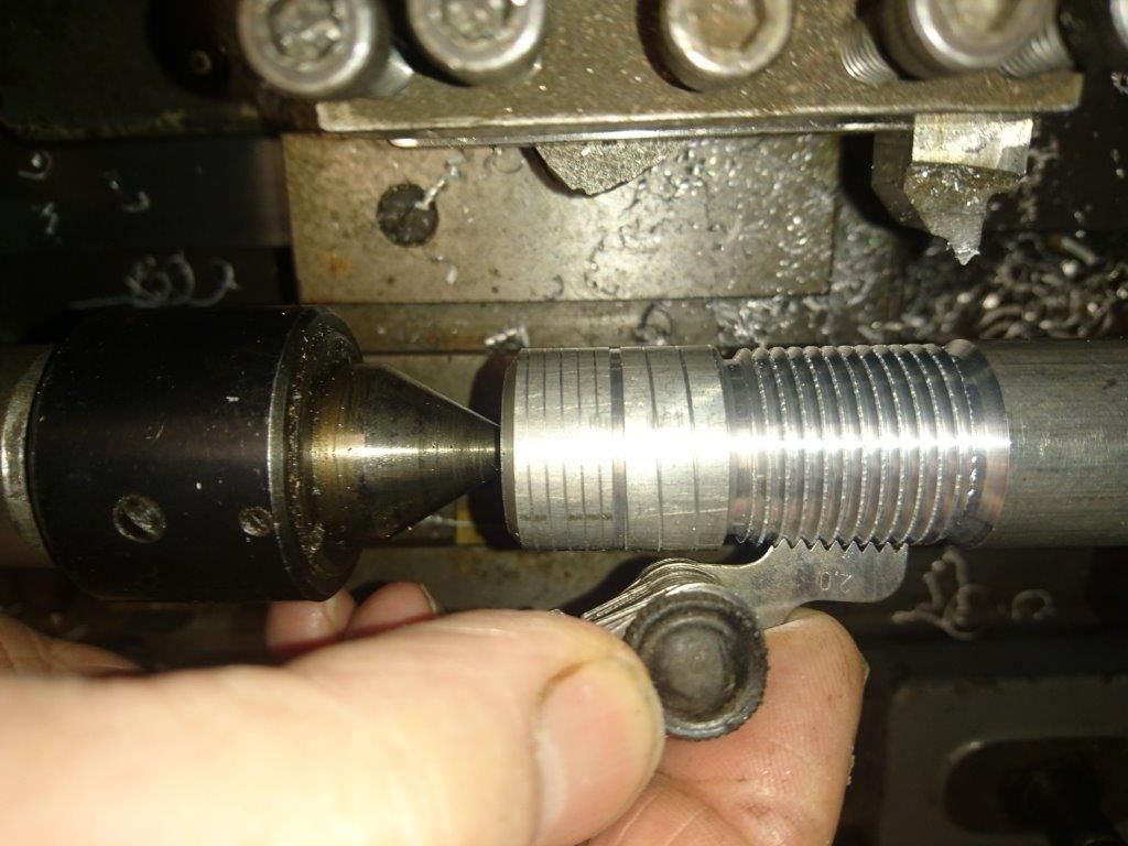

                              Having benefitted as I feel I have from so much of the various contributor's expertise, I thought it only fitting to put up a couple of photo's of what is under the cover on the RHS of the old type gearbox we've been discussing in such detail. This is what the diecast cover looks like:
                              And this is what it covers:
                              xxx
                              And (blowing of trumpets, fanfares, commotion) here is my first metric approximation. Thst's a 2.0 mm pitch thread gauge.
                              Looks like I'm not quite holding it straight, but in reality I couldn't see any discrepancy between the gauge and the thread (even if I didn't take a very good photo!)
                              Many thanks to everyone!

                                That is definitely different to the gearbox on my super 7.
