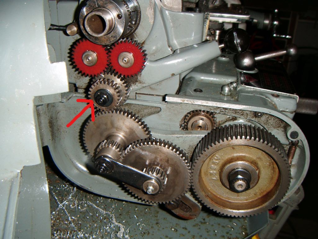

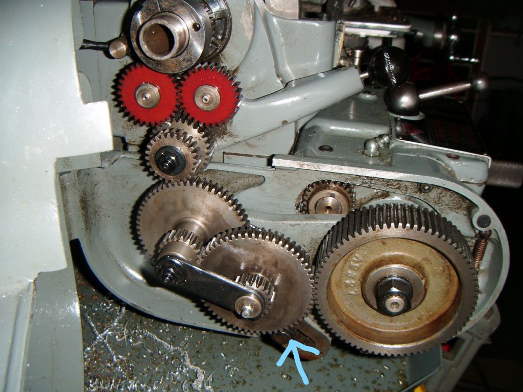

      ok this started to be talked about in another thread, so to stop me from taking it off topic too much I thought I would start a new thread, now me being dislexic and dyspraxic learning from books and written bits is not my strong point so you might need to bare with me while I try and get my head around this.
      from reading other threads I have worked out that it is possible to cut metric threads, with a quick change gear box on a Myford super 7, by just changing one gear, this gear being the 24 tooth input gear on the tumbler shaft.
      so my first question is, is this the gear that is being discussed?
      as by my understanding the input gear would be the one at the top, not the one with the arrow, but the only gear I can find with 24 teeth is that gear.
      so am i somewhere in the ball park, or have I got this whole thing twisted in my mind and I am going off on a random tangent?
      Allan

        #288279
        RichardN
          @richardn
          Yes that's the one- you don't get a 'perfect' thread pitch for every thread, but with a couple of other gears (to swap into that same place) you can do all the metric threads with more than sufficient accuracy for most needs…
          You do need to rotate the banjo to get the correct mesh, and if you use a small gear on that stud some lathes don't have quite enough adjustment…

            Allan,
            ​So that you can follow the logic from the spindle down, the spindle gear will be 30 teeth, the fibre gears are those that do the reversing which in turn mesh into the next gear down, also 30 teeth on the tumbler shaft..
            ​So far the gearing ratio from spindle to the second 30 tooth gear on the tumbler shaft is unchanged. The 24 tooth gear [the one you arrowed], which is coupled to the second 30 tooth gear is what Myford term the mandrel gear and that is the main drive gear down the chain to the gearbox.
            ​You will have found tables that include gears with 33 and 34 teeth to put in place of that, which together with gearbox changes, will give metric ratios in more than sufficient accuracy.
            ​I'm sorry to contradict RichardN, the restriction on banjo movements comes with fitting gears of 35 teeth or more, NOT the smaller gears. The clamp slot at the bottom of the banjo limits the movement

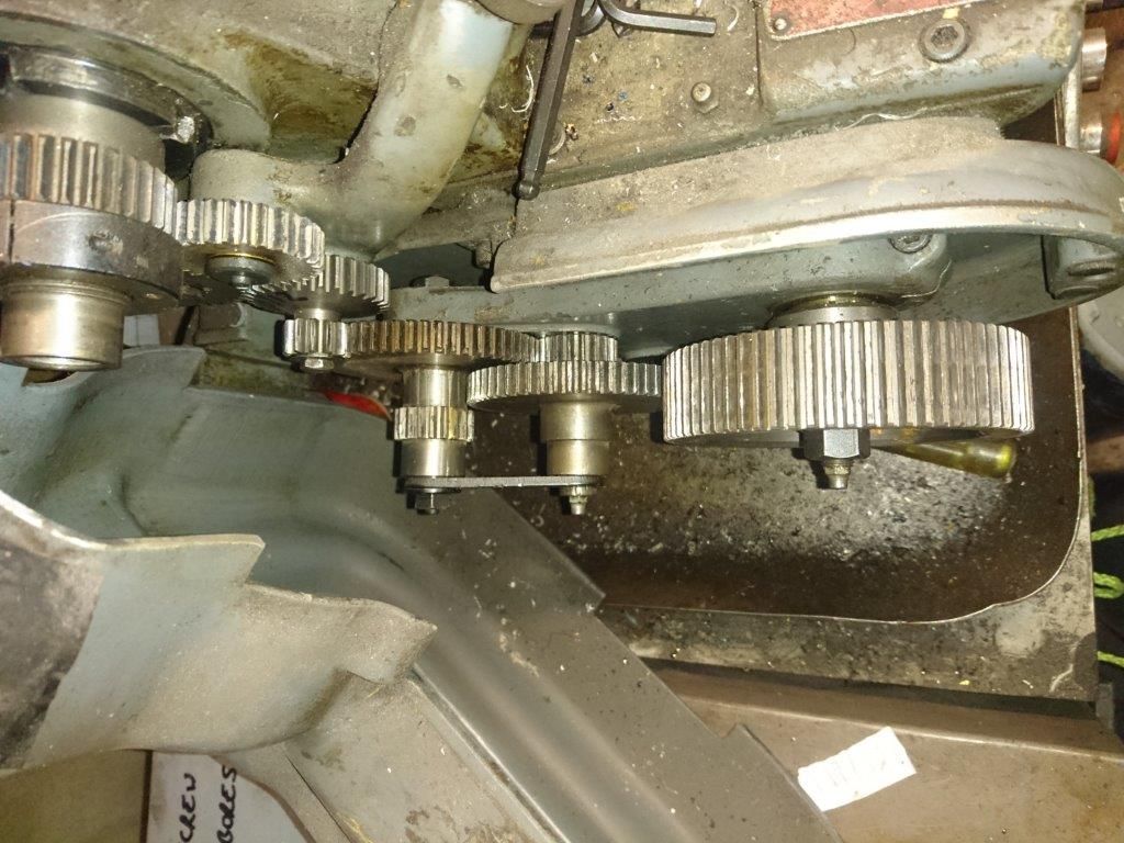

              thanks both for your replies.
              so just getting this into my head, to alter that 24 tooth gear, I need to adjust this bit
              there dosnt seem much movement to drop the gears down, but if it is only another 10 teeth it might just do it,
              so I need to get the 33 and 34 tooth gears which are about £10 each which is better than the £250 for the conversion kit, the next thing is without me going hunting through the net for something that I don't exactly know what I am looking at, where about's would I find a chart for the settings, using the 33 or 34 tooth gears, and what pitches the QC gearbox will cut.
              sorry if I am sounding thick on this, once I can get it all working and can play it will all become clear, but until then and it is all theory my brain dosnt like it too much.
              Allan

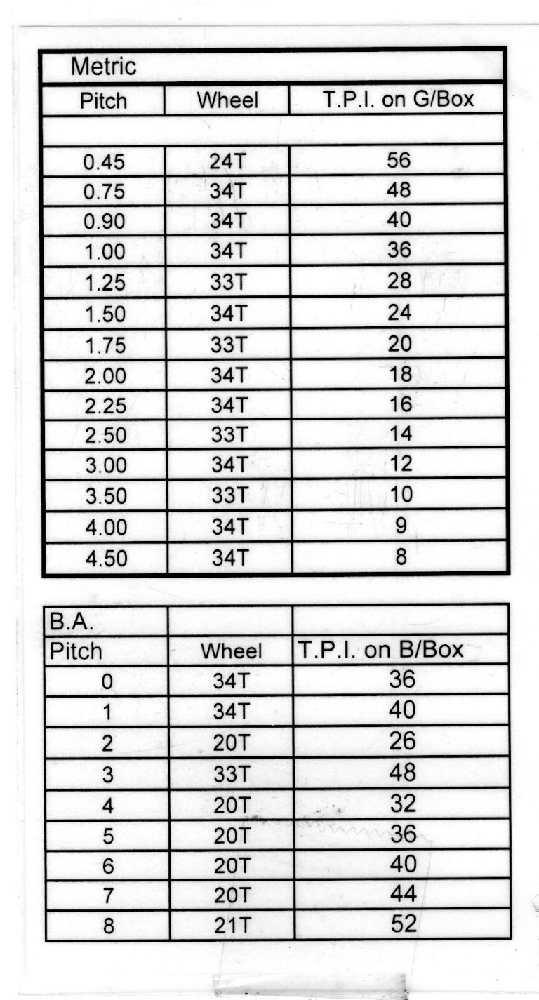

                John Stevenson used to sell a pair of 33 & 34 T gears from his online shop http://www.metoolsonline.co.uk, but had to close the shop, then sadly his wife passed away; don't know if he re-opened it. (Hope I remember it right John)
                Below is the gear chart he supplied with the 33/34T pair. (including typo on the BA chart).  Hope he doesn't object to it being reproduced.

                        Robbo beat me to it, but I'll post this anyway – it's the table I use:
                        **LINK**

                            S.D.L.
                              @s-d-l
                              Posted by Otley on 11/03/2017 15:21:30:
                              **LINK**
                              How do the top 3 rows read,
                              The Metric and BA is clear, but haven't sussed the top three rows.
                              Steve

                                I could be wrong but in my second picture, the gear just above the arrow if the gear you flip over between fine feed and screw cutting, in the position it’s in at the moment it is set for fine feed, so for turning to diameter with a auto feed, the top three rows corresponding with the settings on the gearbox showing what the TPI would be for say C8 is 500 something TPI so a very fine finish, then I think it was A3 is about 90TPI which wouldn’t be as good a finish, but would cut a lot faster.
                                This is as my understanding is, but as this is my thread of asking stupid questions I could be wrong 😂😂

                                  Hello Steve,
                                  ​Surely they are the tpi you can expect by using fine feed [as it says] with a standard mandrel gear of 24 teeth
                                  Regards

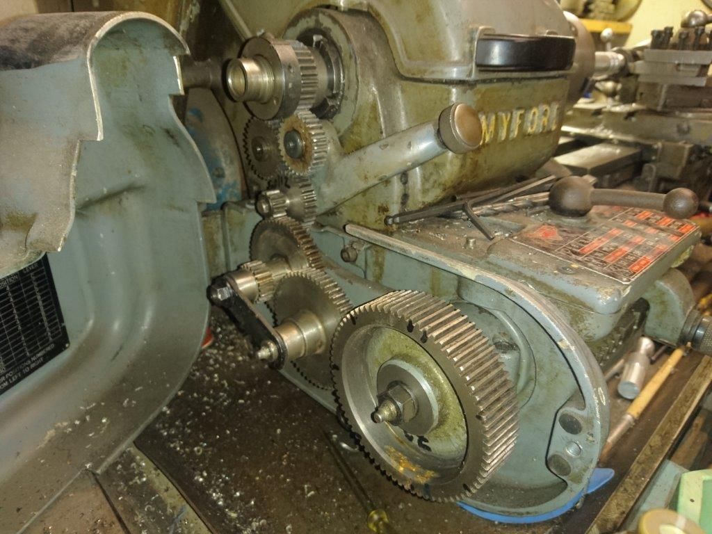

                                                  The mystery deepens! – or at least my confusion is ripening.
                                                  The input gear train of my QC g/box looks like this:
                                                  xxxxx
                                                  Looking down to see the hidden gear looks like this:
                                                  xxxx
                                                  So a 12T gear drives an idler (57T), which drives a 19T/57T combination. The 57T drives the wide 72T of the g/box i/p shaft. Hence the gearbox runs at HALF the speed of the lathe spindle. OK so far.
                                                  Inside the cover of the gears is a label:
                                                  xxx
                                                  BUT (if I've got my sums right) the centre distances of the fixed studs of the banjo don't correspond to those of the proposed gears on the label.
                                                  Measuring the lathe banjo, the centre distance between the two fixed studs is 1.900 ins, which works OK for two gears as fitted of 57 and 19 teeth. The centre distance of the second pair – the second fixed stud and the g/box I/p shaft is 3.225 ins, matching the tooth count of 57 and 72 teeth.
                                                  The label shows to substitute a 60 and a 44 tooth gear pair on the first two studs, so the centre distance will be 104/2/20 = 2.6 ins, not 1.9 ins as on the banjo.
                                                  The second pair, on the second stud and the g/box shaft are 52 and a 60, so 112T total, so centre distance 112/2/20 = 2.8 ins. The banjo centre distance is 3.225 ins.
                                                  Have I misunderstood something?
                                                  Thanks as ever, Simon

                                                    Yes for metric you need a new metric banjo which doesn't have fixed centres.
                                                    **LINK**
                                                    The whole idea of the 33 / 34 gears is to do away with all this and still keep the reversible fine feed which you can't do with the Myford official setup.

                                                      So for my elderly S7 with the half speed gearbox drive, I need a 17T gear to bring pitches of 1.0, 2.0, 3.0 and 4.0 mm within the setting range of the gearbox. EG for 1.0 mm pitch I put gear T as 17T, then set the gearbox in the 36 TPI slot.
                                                      For 1.5 mm pitch I put gear T as 34T, but now the gearbox output to the lead screw is running at twice the expected speed, so I set the gear selector to twice the TPI in the table above (= half the rpm) to bring the travel speed of the lead screw back to where it should be. So I set the gear ratio for 48 TPI not 24 TPI, so the lead screw runs at half speed.
                                                      In my 1.00 mm pitch example, I can't use the 34T on the tumbler, as this would mean I needed to set the gear box for 72 TPI and it doesn't go that high (slow). I can do 2 mm pitch with either a 17 T gear (and set 18 TPI) or use the 34T gear, but then I set the gear box for 36TPI.
                                                      And so on. What larks eh? I'm off to make a 17 t gear.
                                                      All this started from wanting to cut a nut to "fit" a 2 mm pitch screw – the buttress thread on the tail of my U2 collets for the Deckel grinder. I was curious to see if I could get any nearer than cutting 13 TPI, which, crude though it is, actually worked quite well.
                                                      Thanks all as always
