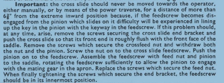

        #259212
        Steamer1915
          @steamer1915
          From S7 manual:-
          Also, George Thomas explains how to solve this problem simply on page 281 of his  book "The Model Engineers Workshop Manual".

          #259216
          NJH
            @njh
            Colin
            This is from the S7 manual :
            …If the feedscrew becomes disengaged from the pinion which slides on it difficulty will be experienced in lining up the pinion with the key way in the feedscrew. If this does arise remove the screws securing the cross slide end bracket and push the cross slide so that its front end is roughly flush with the front face of the saddle.Remove the screws which secure the crossfeed nut and withdraw the nut and the pinion. Screw the nut onto the cross slide feed screw.Push the pinion onto the feed screw. Assemble the feedscrew with feed nut and pinion to the saddle rotating the feedscrew sufficiently to allow the pinion to engage with the mating gearin the apron. Replace the screws that secure the feed nut. When finally tightening the screws which secure the end bracket , the feedscrew should be in its innermost position.

                #259266
                Colin Heseltine
                  @colinheseltine48622
                  Steve, Norman,
                  Found the GHT article. It made sense, but could not make it work. It felt as though the leadscrew was engaging but then locked up. In the end did it the Myford way. Removed the handle and leadscrew from the cross-slide, removed the bearing and gear from the saddle and fitted the screw and then the gear to the leadscrew, Very hard to het started but once into the bore and the key engaged it all moved okay, so replaced the whole assembly back on carriage. All now okay.

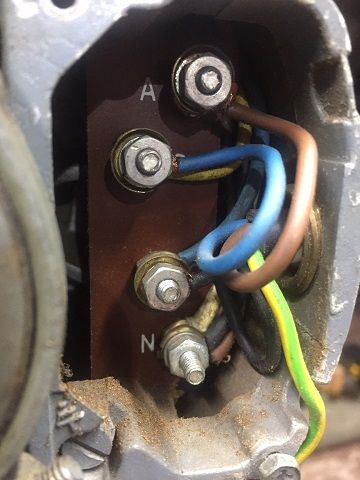

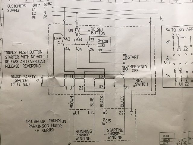

                        Would like some guidance on wiring up the motor to Myford NVR switch.

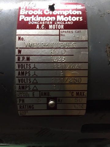

                        Motor Spec plate:
                        Does this imply it can be wired either 440 3 phase or 240 single phase. or is this a 3 phase only motor I do have three phase but intend running this on single phase using a Myford 'Tripus' Push Button starter with NVR and overload release and reversing. ( I am aware of the issues of reversing a screwed on chuck).

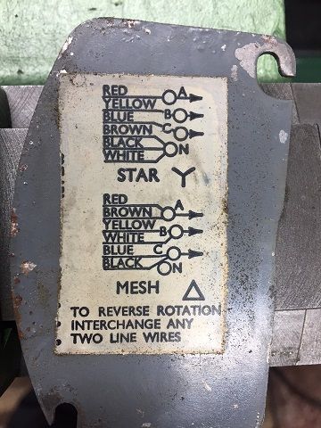

                        Wiring Info plate on cover plate:
                        Current wiring to motor:
                        The motor currently has a 4 core cable connected:
                        RED to A, BLUE to B, BLACK to C, YELLOW?GREEN to Earth ,nothing to N,
                        So I am working on fact it is wired Delta.
                        NVR Switch Wiring Diagram
                        This wiring diagram implies five wires (including the earth).

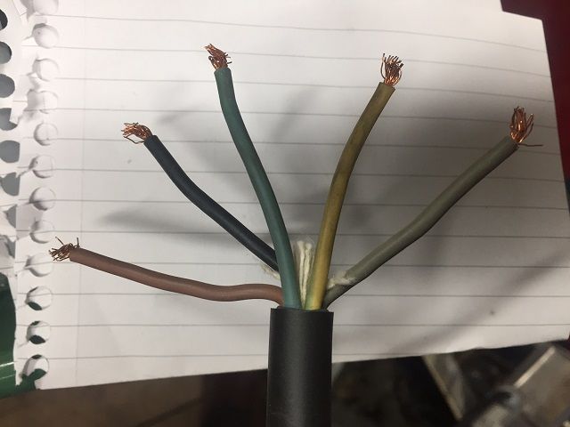

                        Cables from NVR switch:
                        As I intend putting a junction box between the motor cable and the NVR cable could some kind person tell me which colour cables, OR do I need a new single phase motor.

                        #259411
                        Robbo
                          @robbo
                          Colin,
                          This motor will only run on 3-phase, either at 380/440 volts (Star connection) or at 220/250 volts (Mesh (more often called Delta) connection as shown on your cover plate.
                          You can see the Phase rating on the motor data plate at the bottom to the left of the rivet  as  "PH      3".
                          The colour codes on the cover plate refer to the internal wiring of the motor, and there are 3 wires visible connected to the N terminal, so it is connected for Star at 380/440 volts 3-phase
                          How it has run with only 2 input wires + earth is beyond me, but perhaps it hasn't.

                                  That switch as shown on your circuit diagram is for single phase only. Also the picture of your motor terminal box shows it is wired in Star, I can see 3 wires on the N terminal, that is OK for 415 volts.You say you have a 3 phase supply, so why not obtain a proper motor starter fitted with No-Volt release and run it that way. .You would need a triple pole change over switch to get reverse. But if you do, ensure that you inter lock the starter and 3 pole switch so that you don't inadvertently try to go instantly from forward to reverse.Alternatively, as others have suggested connect the motor in Delta and get an inverter, which in my opinion is the way to go. I/we fitted a Huanyang inverter to my friend lathe and he is over the moon. John

                                        I must admit I'm coming to the conclusion that the inverter would be best. I'll try and do some investigation before the Midland show. I had all ready modified the cabinet to take the Myford NVR switch prior to painting, but have checked ant the pendant control (for example with the IMO XKL inverter) will fit in the same space. There is plenty of space in the cabinet for the main inverter unit.
                                        I have just checked the 3 -phase motor and it runs nice and quite in either direction. It is a Brook Crompton Parkinson motor of 370watts, 1425 r.p.m.
