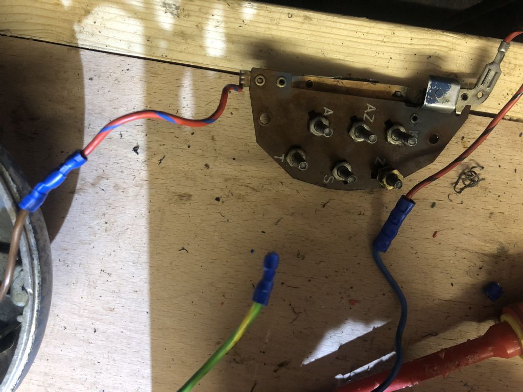

            How do I wire up the capacitor? What are the wires on what looks like a thermal cut out?

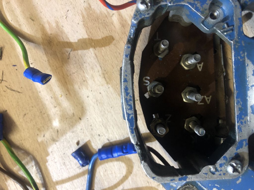

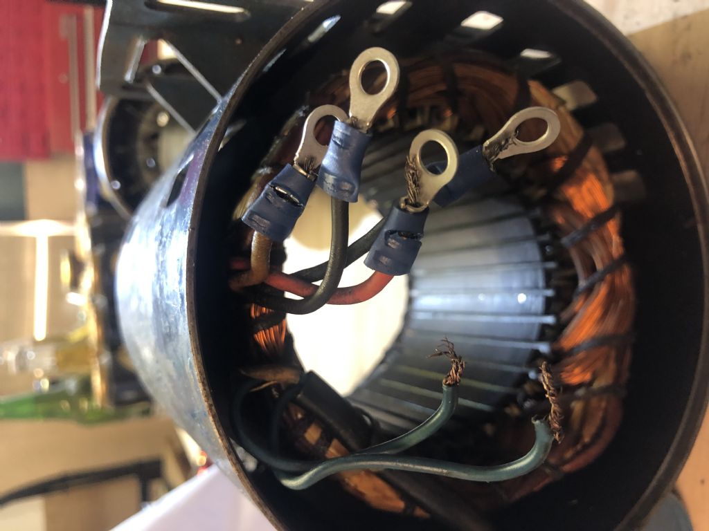

                                    OK, so Nick has a motor that someone bodged in the past. The good news is it ran before and the rats-nest rewire might well explain the RCD. There are several sticky whiskers of wire and other dodgy connections that may have come into contact when the lathe was moved.
                                    On the downside:
                                    • Why did the previous owner disconnect the terminal board? Could be he was trying to fix a fault and the motor itself is iffy.
                                    • The motor has been 'got at', meaning Nick can't trust anything and now has to work the wiring out from first principles. As there are half a dozen different single-phase motor configurations, this is a challenge.
                                    Single-phase motors aren't my thing, so I'd be very much obliged if a more experienced member would comment.

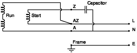

                                    • The bodge uses two pairs of wires, which I believe are the start and run windings
                                    • Two dirty blues wires are left dangling. Nick said he thought these are a thermal cut-out, and I think he's right. They can be ignored. (Except tape up or remove the exposed wires!)
                                    • There's no sign of a centrifugal switch.
                                    • There's one taped up blob marked 'CAP'
                                    • The terminal plate is marked: A, AZ, S and T, which doesn't quite line up with any of the single capacitor motor configurations in my book. (But the wiring has been bodged and we don't know how the terminals were originally connected.)
                                    However, I suggest the motor has been wired as a Capacitor Start and Run like this circuit:
                                    With a multimeter on a low ohms range identify the Start and Run Windings. The run winding has a lower resistance than the start winding. I believe the light coloured wire is the top of the winding as laid out in the diagram.
                                    Health & Safety Warnings! Proceed with caution. Mains electricity is a dangerous shock hazard, doubly so if the worker is stood on a damp concrete floor. Don't touch anything when the power is on. Instead switch on and off from a distance. Capacitors, especially if bodged, can explode. Not like a firework but enough to cause a startle accident, or spray noxious chemicals in your eyes. And finally, incorrect connections or a duff motor might cause an electrical fire. Any sign of smoke, smell or heat, turn off immediately. If it starts, don't immediately assume all is well: supervise until happy nothing nasty is developing. I'd replace the capacitor with the correct type – who knows what's inside that package!
                                    Another hazard is I may have got the circuit wrong. For that reason wait to see what others say, and if you try it remember it's risky. No guarantee it will work or be safe. But I don't think Nick can do worse than what's already been done.
                                    I dislike this kind of problem because the raft of unknowns make everything difficult. It's much easier and safer to buy a new motor because they come with instructions. Most of the mystery and danger is removed; you just have to make a competent job of the wiring.
                                    The circuit above only runs the motor in one direction, being a guess it has no provision for Reverse. If the circuit is correct, reverse is achieved by swapping over the two ends of the start winding between Z and AZ. That's what the Dewhurst switch does. My advice, leave that until the motor is proved to run safely. Or not!
                                    I've an uncomfortable feeling the motor is a dud because of what's been done in the past. Even if my circuit is correct the motor may still pop the RCD. If it does, trust the RCD! It's a safety device issuing a warning that something is wrong. The motor demands a high-voltage insulation test, for which you need a nearby friend with a Megger, or a professional electrician. But rather than paying a man to tell me the motor was dangerous, I'd just replace it. (About £100, unless you upgrade to 3-phase and a VFD)

                                        Nobody has commented on the need for a centrifugal switch on a capacitor start motor which is what the 2 brown wires are. Not a thermal switch ! 4 wires on the windings are red / black, the run windings and blue/ yellow the start windings. Wire yellow through the capacitor then through the Centrifugal switch then out to terminal 2 on Dewhurst reversing switch. Blue out to Terminal 6 on dewhurst. Black to Term 5, red to term 7. Live to term 1 on dewhurst, blue to term 2 and neutral to terminal 3. Terminals 4 and 8 are not used. If the notation on the dewhurst reversing switch is wrong swap over the wires on terminals 2 and 6. RCDs trip due to an imbalance in incomings and outgoings, an MCB will trip due to current above its rated value. A spit phase starting motor can draw 1200% above rated run current. That's where a DOL may save a motor, as it will take the starting current for a few seconds before a sustained high current will cause it to drop out. Noel.

                                          Posted by not done it yet on 03/01/2021 11:49:20:
                                          One practical tip Dave omitted to mention. Keep one hand in your pocket while testing live circuits – it’s safer that way.
                                          What brown wires?
                                          What about the two blue wires on the Stator?
                                          I'm not sure how you can tell what wire is what unless you are psychic. Even if we knew the motor make and model the wire colours could change during production lifespan. I can't even tell for sure what the winding colours in the photo are.
                                          As a minimum the windings need a proper isulation test, all the crimps need re-making (which will probably make them too short) and ALL existing wiring replaced and connected correctly. I'm pretty sure the OP is nor equipped do do all that. No work done previously by someone who used yellow/green wire for live and neutral connections can be trusted.
                                          A new motor is cheap compared to the time required never mind the cost of the workshop burning down or someone being killed or injured by electric shock. Even a minor shock around running machinery can cause uncontrolable movement of body parts into moving parts or sharp tools.
                                          Tha old, probably worn out motor / can of worms is not worth repairing. I have the knowledge, tools, parts and test equipment required and I would not even atempt to repair that motor if it was mine. I think it is irresponsible to give the OP advice other than to get a professional to look at it.

                                          Dave Halford
                                            @davehalford22513
                                            Noel,
                                            For my money the red/blue and red/black wires are the centrifugal switch, you can see the contacts in photo 2 of Nicks last post.
                                            Nick,
                                            You can't use those blue crimps in such a confined space nor leave all the exposed copper visible, especially those chocolate block blue and brown wires.
                                            If 'rats nest' was how you bought it, then someone knew the motor was bad. Bin it and buy a new one, they have much more room in the connector box.
                                            If you do go 3phase, be aware the VFD doesn't normally work straight out of the box.

                                            Martin 100
                                              @martin100
                                              Lovely use of green and yellow wire. smiley
                                              Maybe fixable IF you have suitable test gear, or at a push it’s but a few minutes of work using terminal blocks, an incandescent lamp and a 13A plug. But as ever you really have to know what you are doing.
                                              Look on the bright side, the motor originally wired in that manner would probably kill you…now you have something to sell on eBay as an antique, or if you have morals, something for the scrap man.
