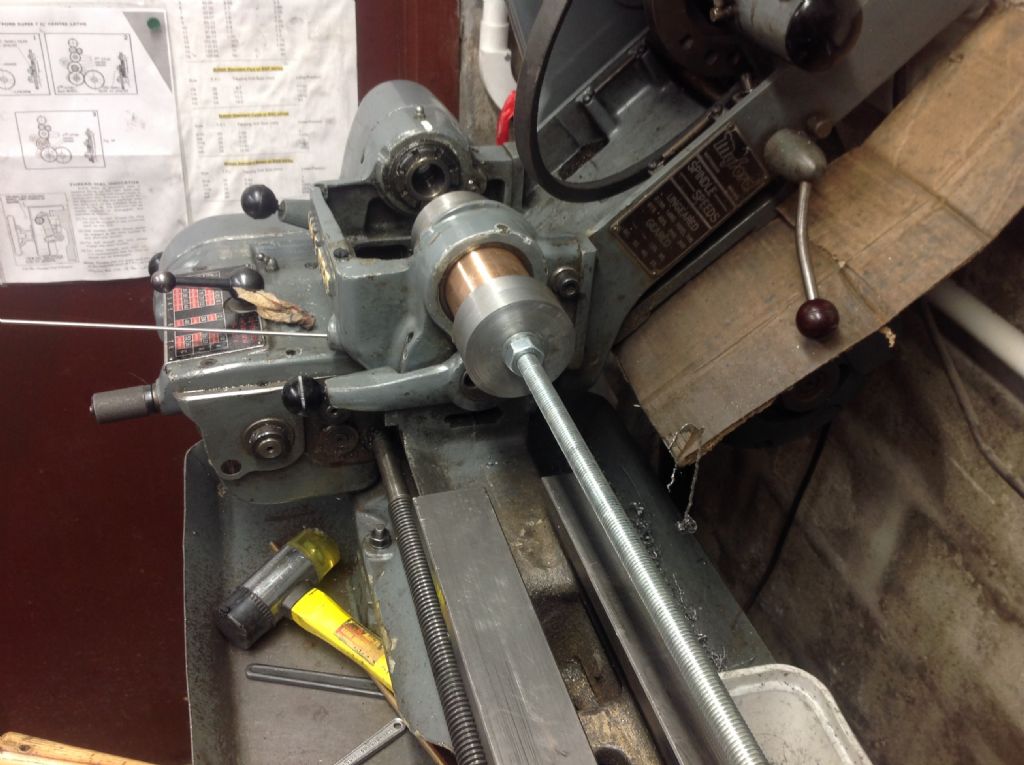

                            After testing the spindle with a dti I recorded an 0.008" run out. This was recorded with the spindle at its maximum travel i.e. adjusted all the way to the left. After speasking to Myford I was told that there was probably wear in the front bearing and that it would require replacing. I rigged up a puller and removed the bearing last night. I have also ordered a new bearing which should hopefully arrive today (Wednesday). The bearing has one groove which runs in line with the hole for the wick, presumably for the oil. The chap from Myford told me that the bearing should have three grooves if if it was an older style lathe and two grooves if it was a later model. As I said my bearing has one groove so I'm not sure why this is the case. I was also told that I would have to cut the groove/grooves myself.

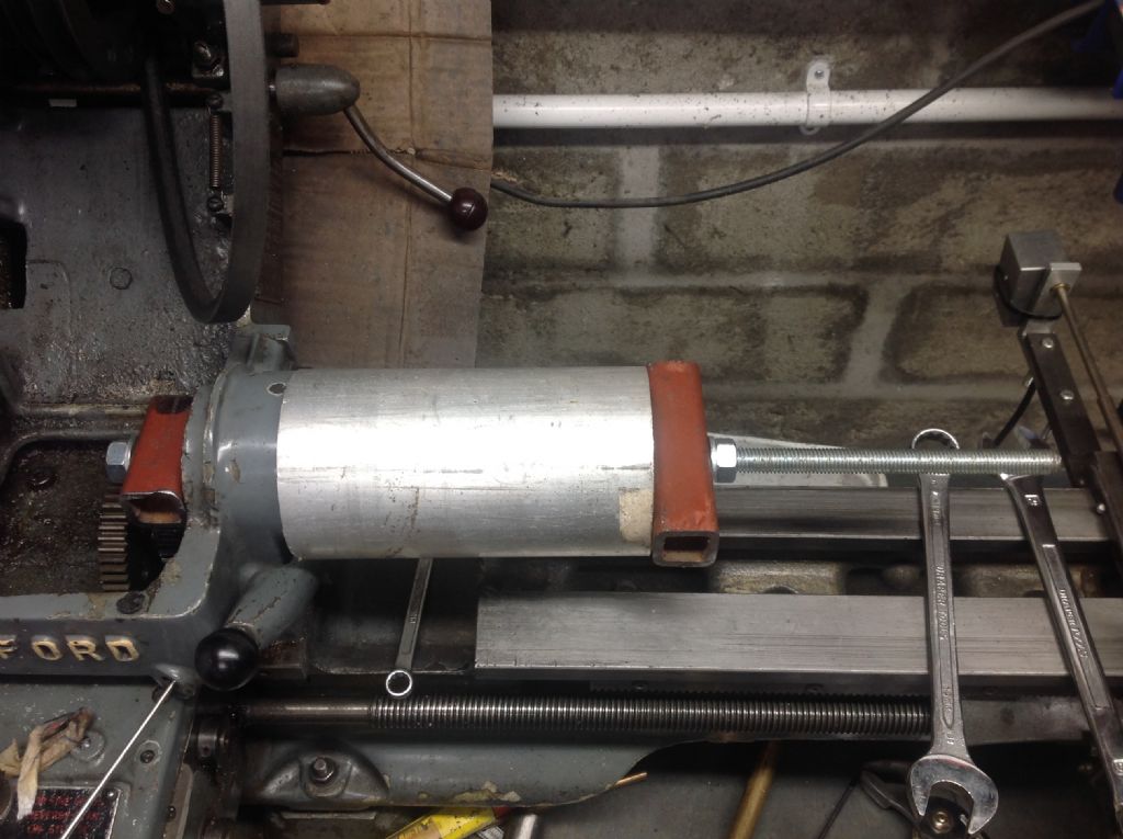

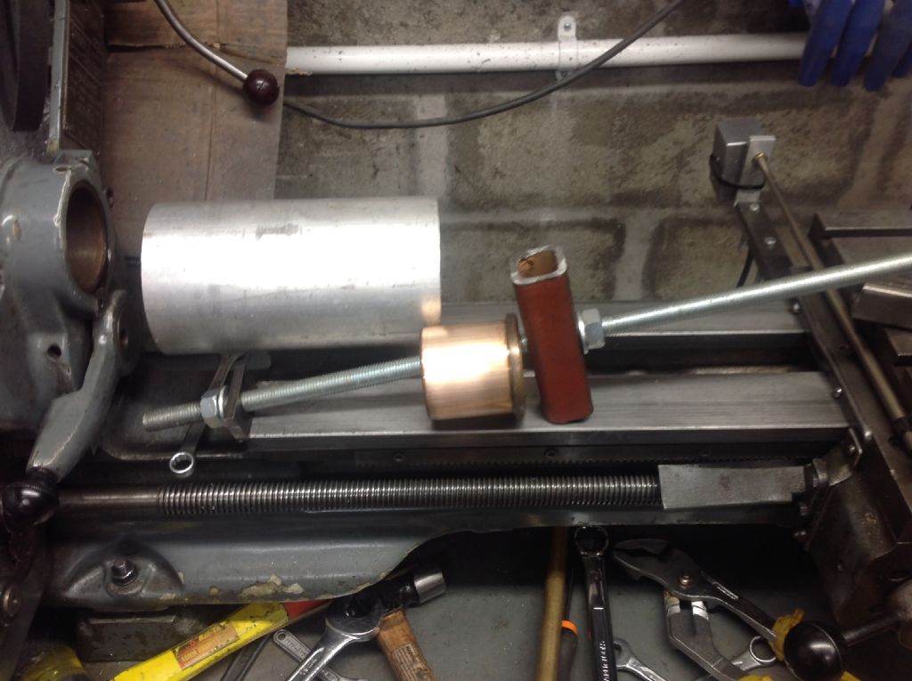

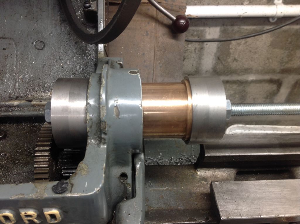

                                      I used a piece of 3 1/2" aluminium pipe and made a puller to remove the defective bearing. When it came to installing the new bearing I had a friend make me two cups, each to the diameter of the bearing's ends – my lathe was out of action. These cups helped to ensure that the bearing entered straight.
                                      I check for runout on the spindle. I'm now registering a mere quiver on e needle instead of 0.008".  Happy days…!!

                                        winkIt's best to make the parts needed first before dismantling the lathe. I did but with ball races etc it's important to try and make sure that the all thread is central to the bearing when it's pulled in. Maybe a bit of a boss that locates in the shells on the discs used to "pull" them in. This probably doesn't matter on S7 bearings as they are so long but other types can be pulled in slightly slanted.
                                        I managed to do it without that but it would be easier with the bosses. The same applies to getting the spindle out if the bearings are tight fit as they usually are. I had problems until I carefully squared things up by eye – it then needed less force. Maybe a sleeve that fits in the the spindle and locates the all thread centrally would be a good idea.
