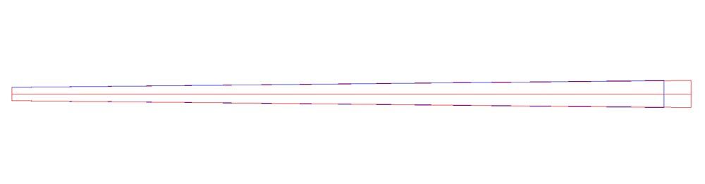

      This thread has prompted a question: Is there any practical difference between a metric (1:50) pin (in red) and an imperial (1:48) pin (in blue) when bashed into a hole hand cut with the correct reamer?
      Just a thought,
      Rod

        Oops, that's not what i meant to say. I'll try again.
        Is there any practical difference between using a metric pin in a hole made with an imperial reamer (or vice versa) and using a taper pin in a hole made with the correct reamer?

          Rod, the commercial grade on the site below shows a tolerance of +0.0013" to -0.0007" (per inch?), which is a little tighter than the two thou per inch of length difference implied by the Imperial vs Metric tapers.
          Taper pin specs
          The company (Stanho) is US, so the spec is not to BS36, and its name derived from "Standard Horse Nails."
          But I can't judge whether it would make much difference. It's a wedging taper so friction plus some distortion would probably fold it. The site also mentioned a 'precision' grade, +0.0005" / -0.0000", so perhaps it does for some applications.
