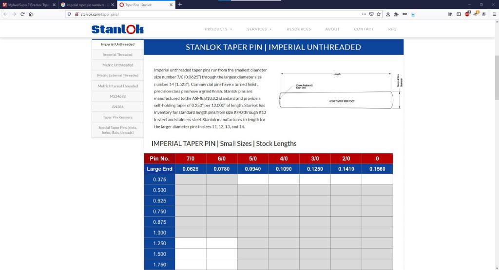

      I have had a "Mishap" with my gearbox on my Myford Super 7. On the main shaft of the gearbox, the smallest gear (part 141 – 16T) is pinned to the shaft with part no 142 Taper pin which is #0x3/4".
      I have had to drill out the old taper pin which has not damaged the shoft or the gear. However I cannot find a supplier of the correct taper pin. Myford do nothave any and all suppliers now seem to work on Metric pins.
      Does any reader know where I can obtain a no 0 taper pin x 3/4" long.

                David Haythornthwaite
                  @davidhaythornthwaite90386
                  Hi Brian,
                  Removing the pin from the main shaft was quite an anxious time but drilling out worked ok using the jig that I mentioned to you before. I managed to replace the tumbler gear that had a broken tooth.
                  The taper pin that would fit the 16T gear would be something like 3.9 mm on the big end and 3.5mm on the small end with a length of 20mm. I bought some 4mm taper pins from RS-online, but of course metric taper pins are specified by the small end diameter and the pins were too big.
                  The only ones that I have seen are at:
                  **LINK**
                  I got quite excited until I saw the minimum order price of $50 !! That is a lot to pay for a requirement of one taper pin!
                  I suppose if all else fails I could carefully grind one using 4mm silver steel and a tool post grinder but it would be a hit and miss affair as regards the taper angle. No-one seems to sell imperial taper pins in reasonable quantities.
                  Incidentally, when the crash happened, I was running the gearbox via the Graham Meek metric screwcutting adapter. It was the MYFORD box that was damaged and the Tufnol gears took the strain ok. That speaks well for the new home made adapter.

                              The pin that I would need is a 5/32" uk pin and EKP do not supply one. Thank you VERY MUCH for your kind offer to make one for me, but I have just made one from silver steel and it sits nice and snug in the taper hole. I shall only finally drive it home when the main shaft is in place with all the gears on it.
