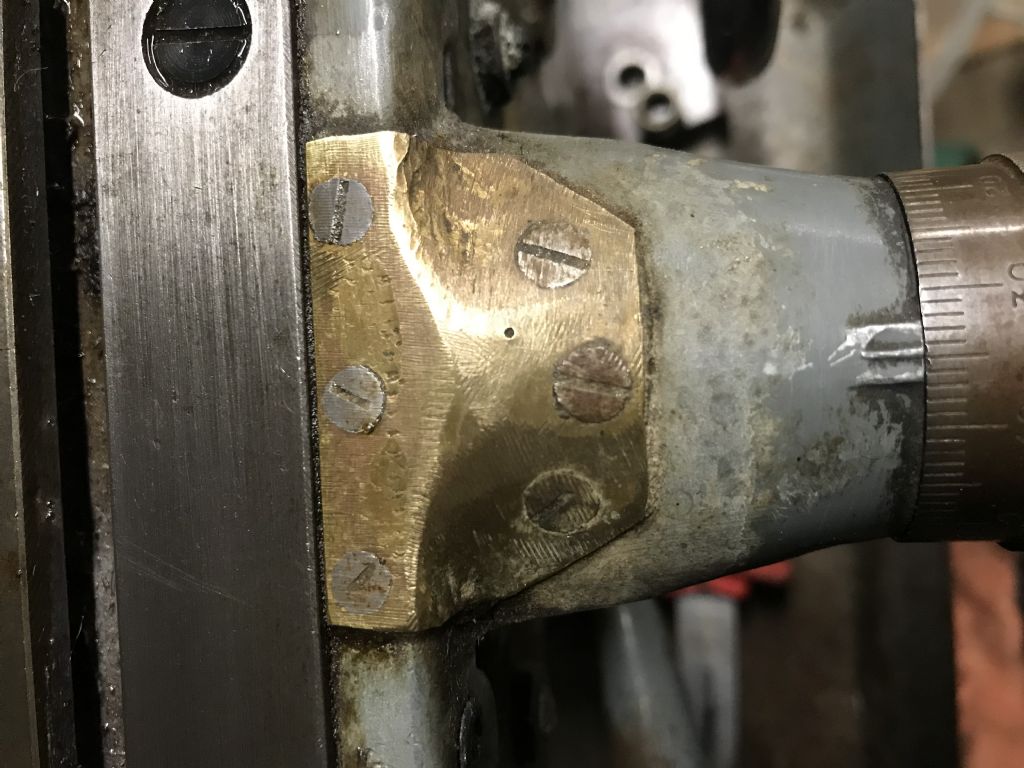

        I have a Super 7 lathe and a very long time ago the end-plate was repaired using a brash plate. Its not a bad repair actually bit it gives ever so slight movement when machining.
        Although there are a number of endplates online i can't find one for a super 7 (powerfeed model)
        Does anyone know where you can get these items? Seem like an item that's easily damaged so you'd think there was plenty of people making replacements!

                What sort of damage are you meaning. Mine had side bore wear. But not sure what your damage is.
                Steve.
                P>S a pic would help.

                  Thanks for that DiogenesII but unfortunately that doesn't fit my machine, That's the connoisseur model, mines an SK. I've been trying Myford for over a year but as luck would have it they have just got a handful in that fits mine and its coming today. Also found Metric cross slide assembly Myford super 7 dial handle plate screw and nut | eBay and have since found this will fit.
                  And correct, Sean Connery did fix the machine before me and his typing skills and drink problem were nearly as bad as mine!
                  Steviegtr it cracked the casing, scrap but i was clutching at straws trying to fix.
                  Appreciate all your replies.

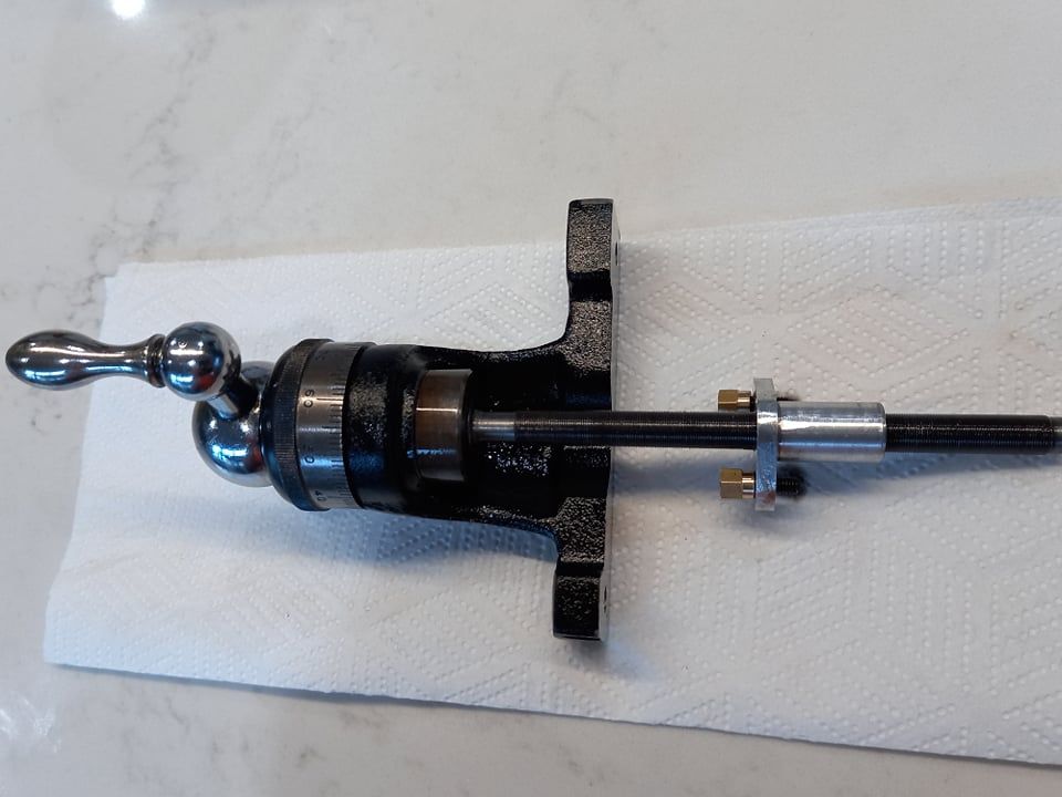

                    Thanks Michael, I just ordered a complete spare cross slide assembly for mine. Just 4 screws and then I can change out from the 2mm pitch metric assembly, to the home made 0.5mm pitch assembly now. The one I made, uses the imperial 100 thou dial, so each division matches 0.01mm diameter on a metric micrometer. Lots more winding of the handle of course, but makes it so much easier if you are making a lot of bits that you need to be as close as possible.

                          Michael Fothergill:
                          Joking aside, would you please explain about the "brash plate"?
                          There is another thread on this forum containing the phrase (unknown to the OED) but it left me none the wiser.
                          I'm glad you were able to solve your problem; it's good to know spares are still available.
                          #583855
                            Posted by ega on 04/02/2022 11:56:02:
                            Impossible to answer without joking, but it's a typo for 'brass plate'

                                Not the most obvious typo for brass! I speculated that brash plate was a variation on fish plate.
                                The belated photo makes it clear – thanks.

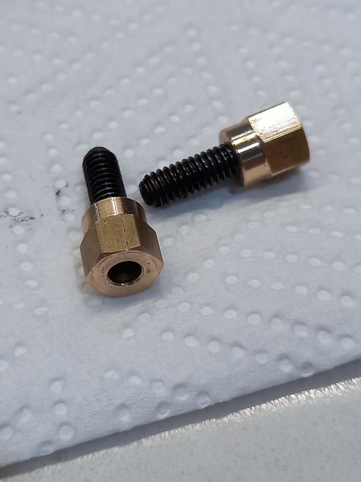

                                  My Assembly arrived today. Sadly it was missing the spring washer or diaphragm washer for the tension on the dial. Anyway, what I really noticed was the pain to get to the 4BA screws holding the nut to the carriage. I found some 4BA set screws 5/8 long with a 1/16 hex in them. Made some nut heads from 1/4 hex brass and glued with 620 loctite. These are much easier for my fingers to access than the long series screw driver. I have a long series 1/16 allen key and is easy to install and a 1/4 spanner to just nip up. This is for using my fine thread assembly that is 1mm/ rev on diameter.
                                  #584981
                                  Tony Pratt 1
                                    @tonypratt1
                                    I have always assembled the nut to the carriage first, then add the restwink
                                    Tony
